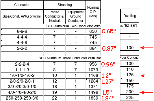

A line going from “outside panel to inside panel” will by code have 4 wires in it, and only the grounding conductor os allowed to be undersized. Netutral isn’t. Three big wires makes a big cable. I’ve got 2/0 Al going (underground) from the panel in the house to the sub panel in the shop and it’s BIG. That’s only good enough for 100 amps. If you need 200 (or anything over 100) then you go to 4/0 and that’s easily going to be 3.5 inches.
I went through my home and replaced all the AC outlets with cheap but excellent Pass and Seymour CR15 side mount only AC outlets. I also had dedicated lines run from my main stereo. Simply switching breakers so noise producing appliances are on the opposite leg helps with noise problems. Keep your fingers crossed that your house is not one with aluminum wiring.
...Three big wires makes a big cable. I’ve got 2/0 Al going (underground) from the panel in the house to the sub panel in the shop and it’s BIG.... go to 4/0 and that’s easily going to be 3.5 inches.
None of the likely residential feeder cables are even half of 3.5". 4-wire at 4/0 on three is good for up to 200 Amps and is 1.5" diameter.
500 Amp 750cm triplex is 2.9" diameter in fancy-plastic, and would be much more in old rubber, but that's a BIG house load.
