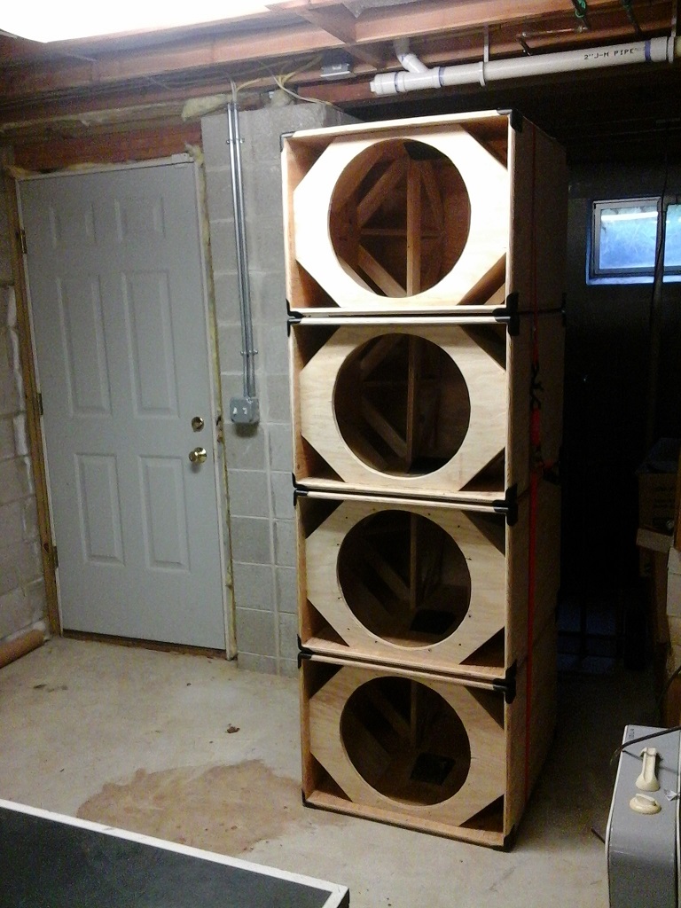

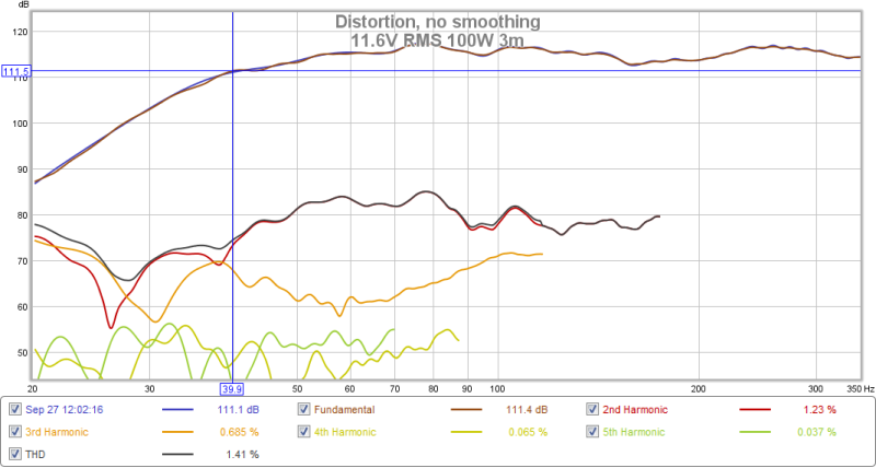

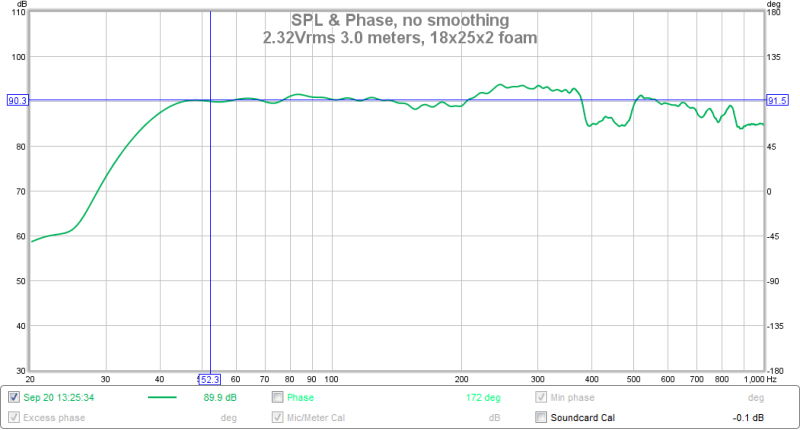

Here is a single sheet Dayton PA460 PA bass box. I built four and use them for parties and outdoor festival stuff. Sunday I had them outside and was never able to turn them fully up, but they were doing 95 dB at 20 meters with no strain. They are not the most capable, but they were cheap, efficient, and at 85 pounds each, I can carry them myself in a pinch. The measurements are outdoor, not at 1 meter. First plot is a single; second is all four in parallel.

The box is 30" D x 26.5" W x 20" H outside. It is 6.7 ft^3 (189 liters) internal not including ports and 9.2 ft^3 outside including the 1.5" recess to protect the driver and grill. It is tuned to 36 Hz measured. I was shooting for 42 Hz tuning but missed on the effect of the walls on the triangular ports and decided to leave it. The four ports together are like a 11.25" x 9" diameter port (8 inch square port).
With 42 Hz tuning they can each handle 340 W minimum at 60 Hz without exceeding Xmax (6 mm) and with the 36 Hz tuning they handle 280 W minimum at 54 Hz and 500 W above 80 Hz. One will make 123 dB and four will do 135 dB at a meter (138 dB above 80 Hz). They can be built for under $200 each including wood and hardware, and the drivers are on sale for under $90 now. Didn't mean to hijack the thread, but it is one version of a cheap 18" sub.
Marc
