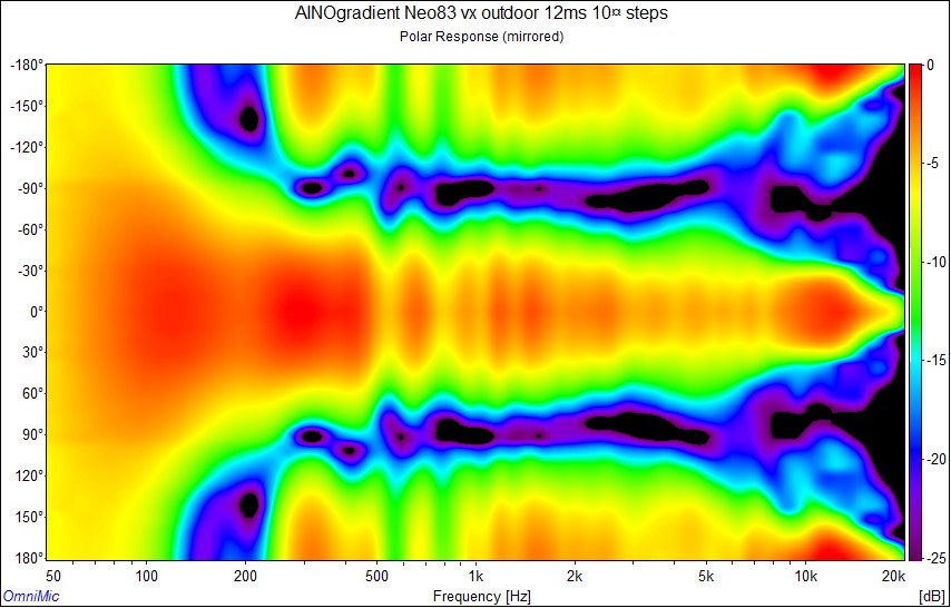

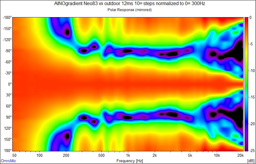

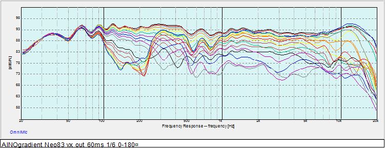

^That approach was also used in Gradient1.n series speakers in 1980's. I did it with minidsp utilizing ~160Hz/LR2 acoustic transition, because it gives wider range of cardioid and smoother transition zones - sounded better to my and friends' ears!
front and rearside horizontal polar measurements, indoors.
Sorry, wrong attachments first. Here - measured outdoor with more low-end extension. My speakers are 4-way with dsp eq, xo and delay control. Low bass is monopole, others dipole - transition is cardioid. But basically it is about acoustic wavefronts' interferences - very much frequency-dependent when radiators are multiple sources with some separation in 3D world.
Considering speaker response in a small room, there are always also other boundary reflections and room modes that make problems even with cardioids!
