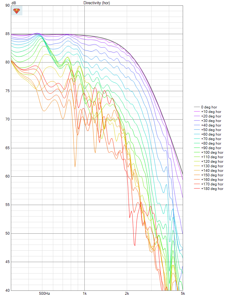

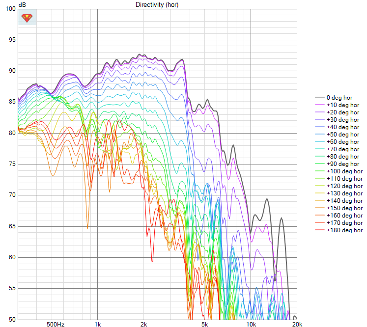

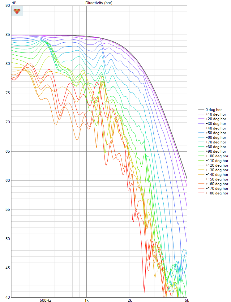

Directivity study- polar maps of HF, MF and LF drivers in cabinets
Just because it looks more complicated doesn't mean it's something to avoid looking at.
Why would a normalized graph be more complicated?
Btw, the suggested EQ for that speaker is kinda weird.
EQ'ing dips is rarely a good suggestion, and in this example a couple of those are clearly from diffraction problems.
Clearly visible in the power response.
Which now has to much energy at certain frequencies (it's not that horrible, I have seen far worse).
Looking at the first graph, there seem to be als quite a bit of room reflections (or similar) left in the measurements.
There is no reason that driver does these kind of scribbles by itself.
Upsetting that these days people think everything can be EQ'ed without thinking.
Worst I have seen, is the suggestion to boost well over 6dB to "get rid" of a certain dip. Not knowing that the dip in question was actually a destructive resonance from the port. Meaning this will always be a dip no matter how much you boost that particular frequency (acoustics 101).
So in the end it's nothing more than a artifact of the representation of the measurements why it looks better after EQ'ing.
Really bad that such kinda of terrible misinformation is just being shared left and right, especially by people that clearly have a certain status in the community.
Big thumbs down. 👎

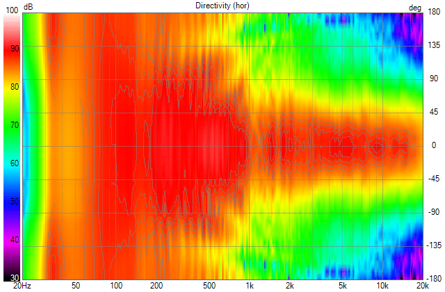

No, the other way.
The non-normalised graph was purported to be:
visually quite complicated.
And that normalised was easier to view.
Yes it IS easier to view, because it’s all related to the reference axis. Assuming a flat on-axis was a good idea to start with. And sometimes it’s not. Eg. EQ for flat!
Exactly.
EQ it all and it’s all better, according to ASR…
Final time, to be clear, EQ for flat on axis or listening window is NOT always a good idea. And that is why a non-normalised graph can be useful.
If you don’t like looking at non-normalised graphs, move along, nothing to look at or learn here.
If this doesn’t help you see the difference in vertical response of the KEF Blade 2 Meta and R11 Meta (both with 4 6.5” woofers) one which is side facing and the other which is one the front panel, please look at spinorama.org
Reactions: b_force

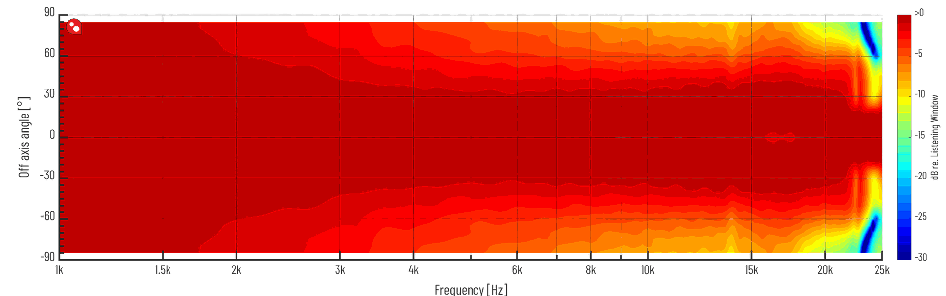

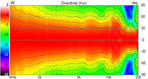

eg. KEF R11 Meta- out of the box:

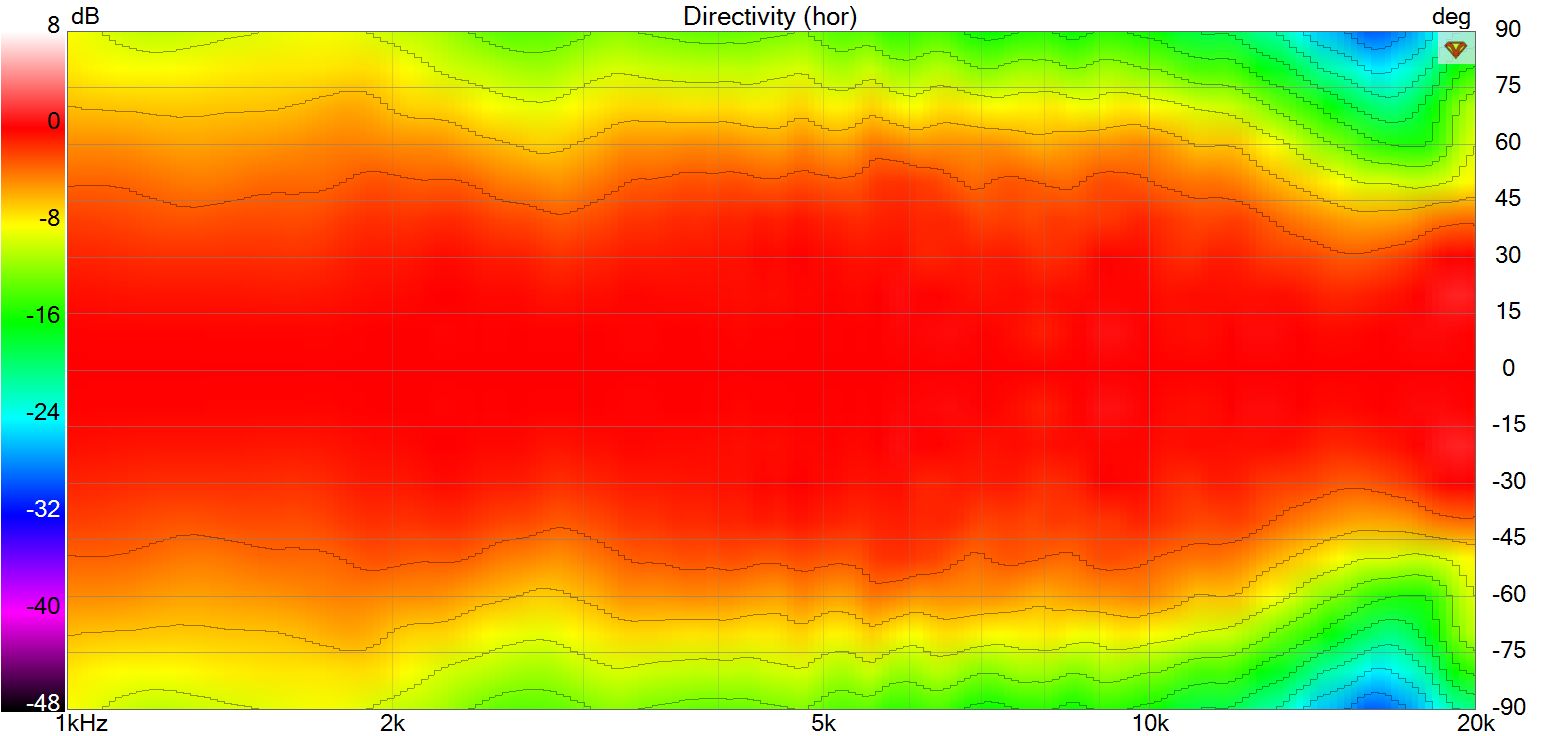

Directivity, normalised: horizontal:
Vertical:
EQualised for flat listening window and downward in-room response:

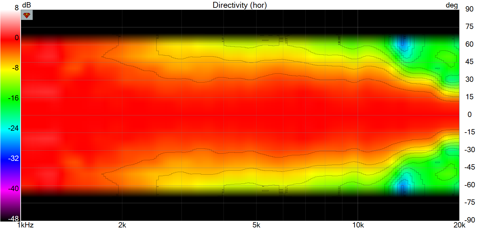

Directivity: normalised, horizontal:
Vertical:
ie. there is NO CHANGE to a heat map in a NORMALISED VIEW

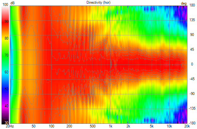

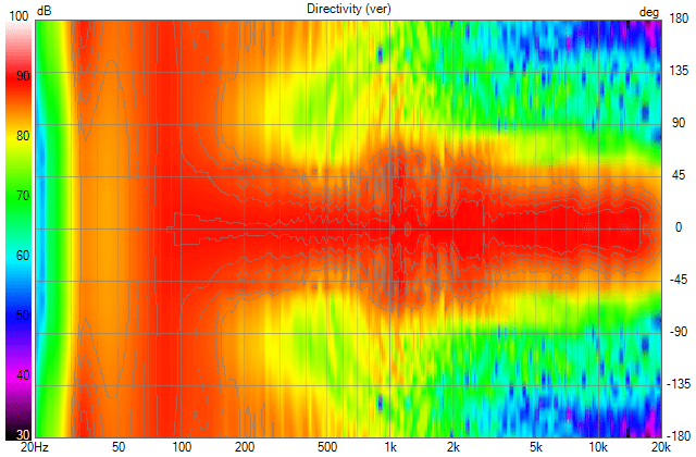

Here is the (non-normalised ie. actual SPL) heat map-
Horizontal
Before EQ:
After EQ:
Vertical:
Before EQ:
After EQ:
Normalised and non-normalised views each have their uses.

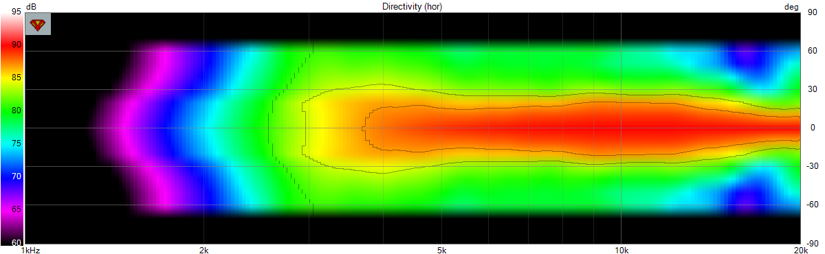

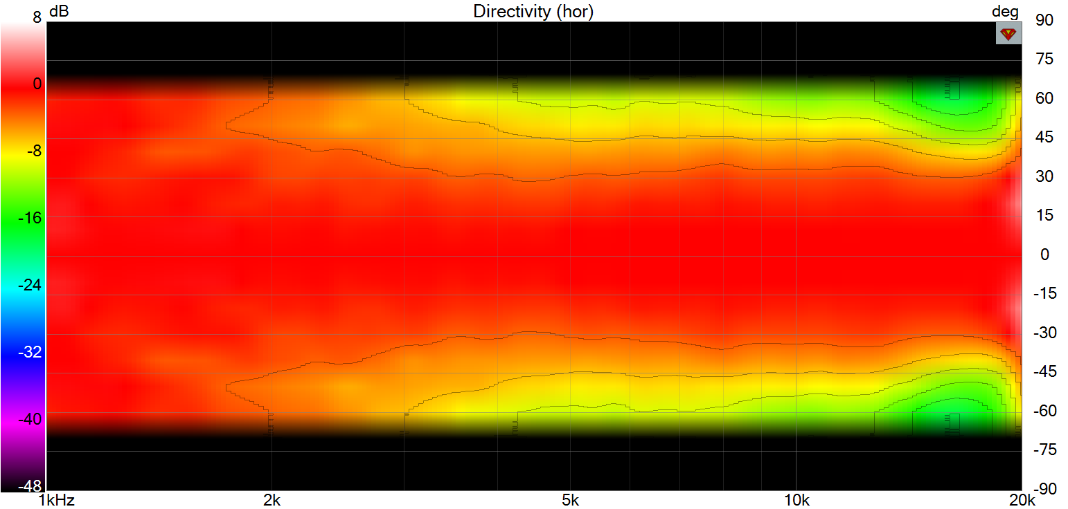

Here are HF devices that exhibit smooth directivity
Compression drivers and horns
1. Compression driver in well optimized large horn design by @mabat
2. The same compression driver with an off-the-shelf horn- notice how it is slightly less smooth between 3-10K Hz
Dome drivers in waveguides:
3. Hard dome tweeter with DXT® lens, with large round over starting at edge of tweeter, crossed to a 5" midrange @2K Hz:

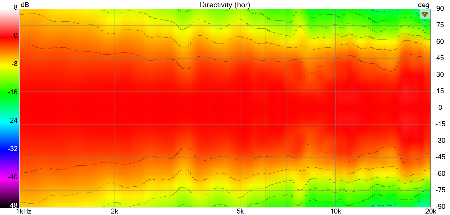

4. Hard dome in a waveguide
NB. Taken on quasi-IB; data only available up to 60 degrees. On a real cabinet there will be some differences.​

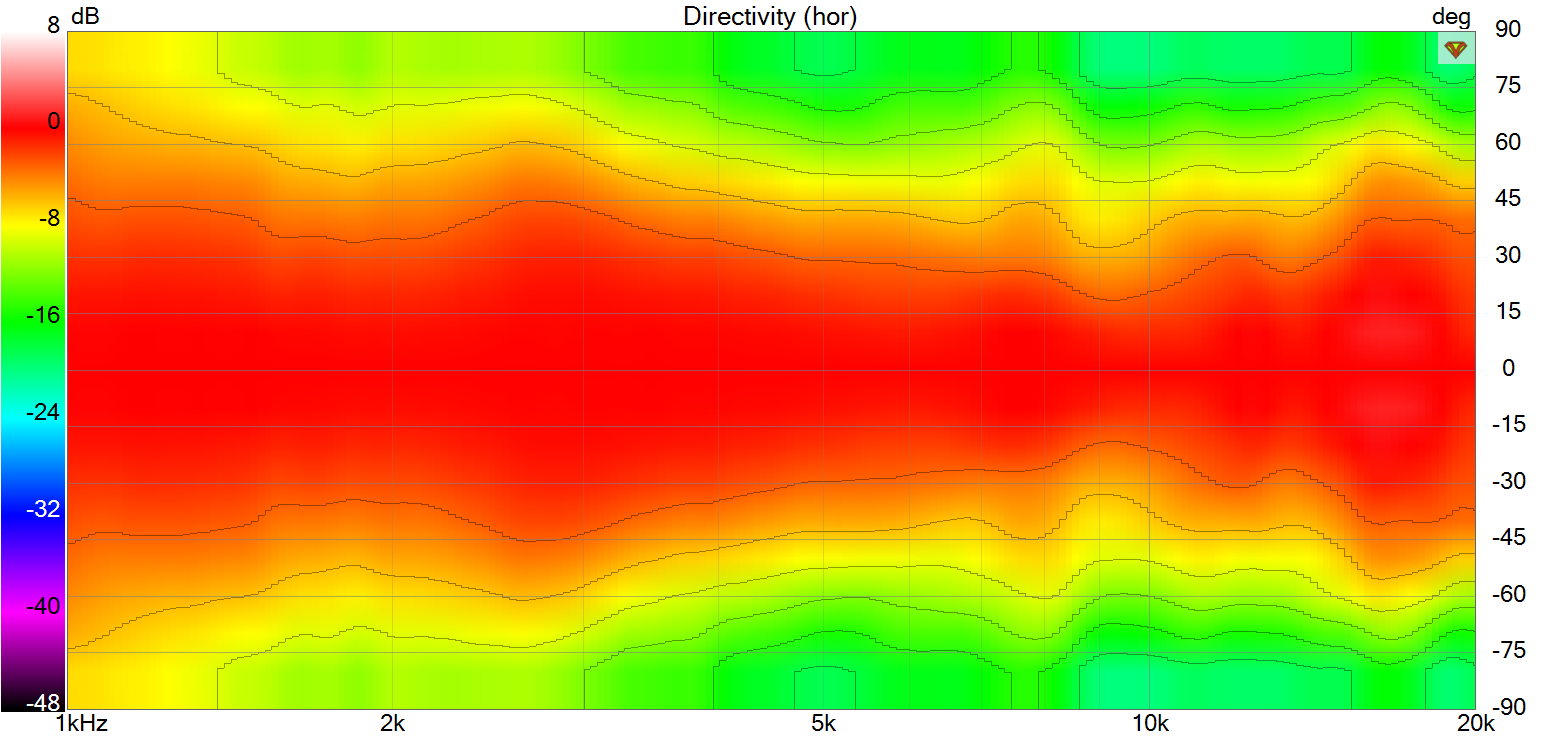

5. Same hard dome in a WG optimized for a 9.5" wide cabinet, and for use down to 1K Hz:

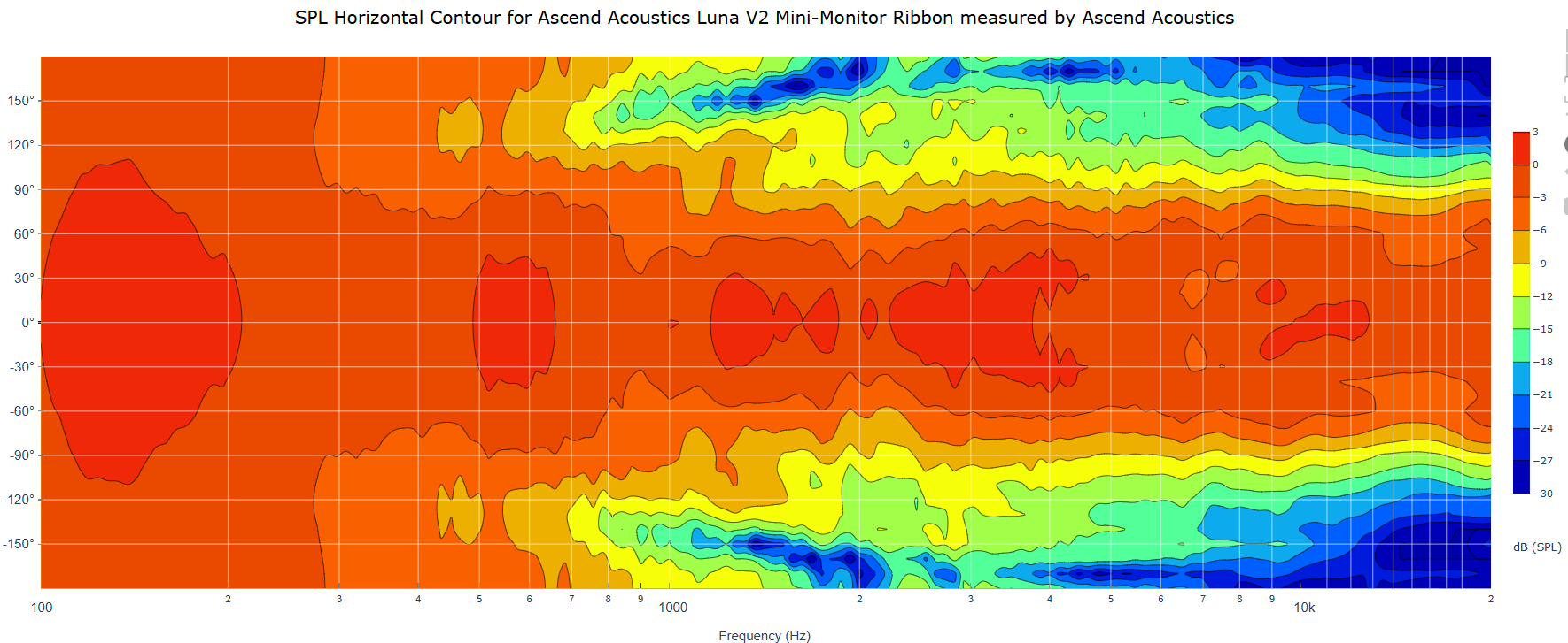

D. RAAL ribbon in Ascent Acoustics Luna V2 speaker
Reference: Spinorama.org
compare with the 26mm SEAS alloy dome tweeter version:
Does this wide, constant directivity frequency response go some way into explaining why some enjoy/prefer ribbon tweeters?

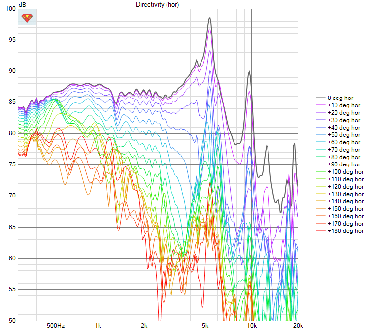

One cabinet- 2 different drivers with common magnet system but different cone
1. Fiber cone-
2. Aluminum cone:
Here you will say... well, of course they will sound different.
But what it we carefully apply a crossover so that their response is the same? Let's suppose we have a high tech crossover that allows us to match the low pass filter such that both have a response that perfectly follows an acoustic LR4 with a cut off of 2.5KHz:
The fibre cone:
The aluminum cone:
At this point, you might be inclined to say- that looks very similar.

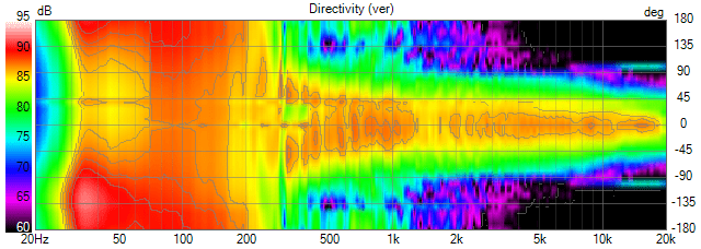

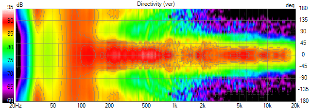

POLAR MAPS:
Fibre cone:
Aluminum cone:
As we can see, how one cone radiates sound in three dimensions is different another cone, irrespective of our perfectly tuned crossover.
