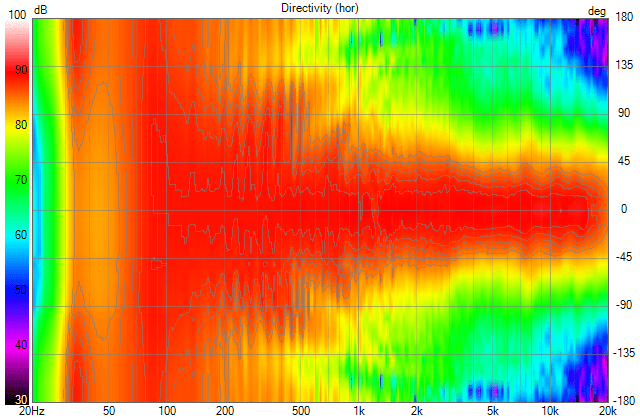

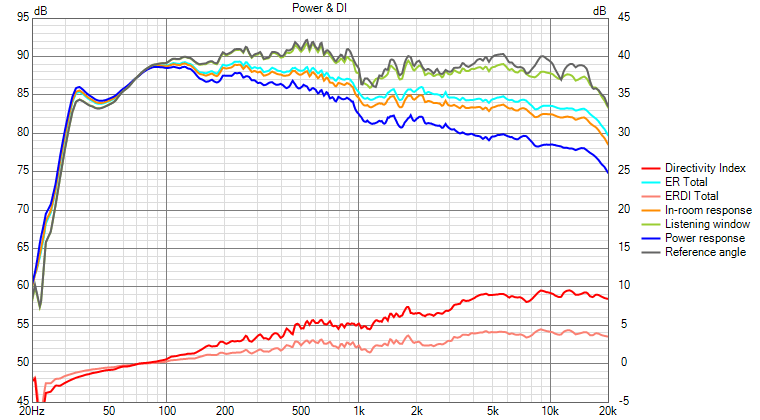

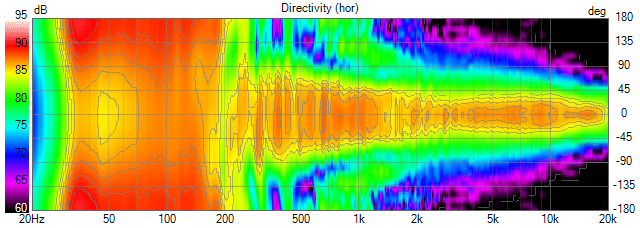

I've posted a small study comparing High, Medium and Low Frequency drivers in a variety of cabinets.
It's on another forum that allows me to edit/amend as more data becomes available.

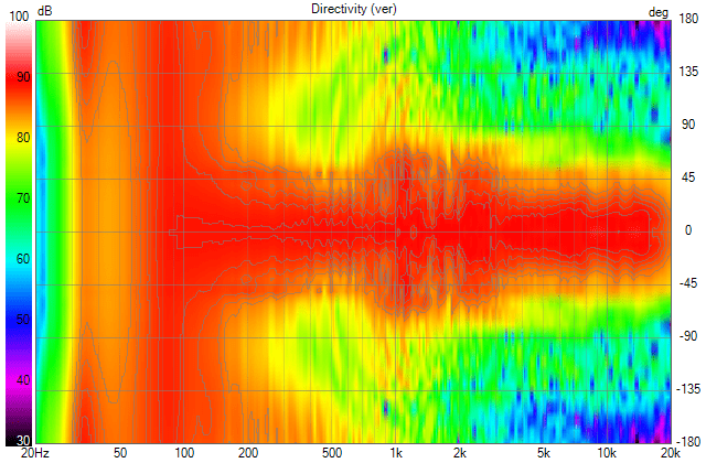

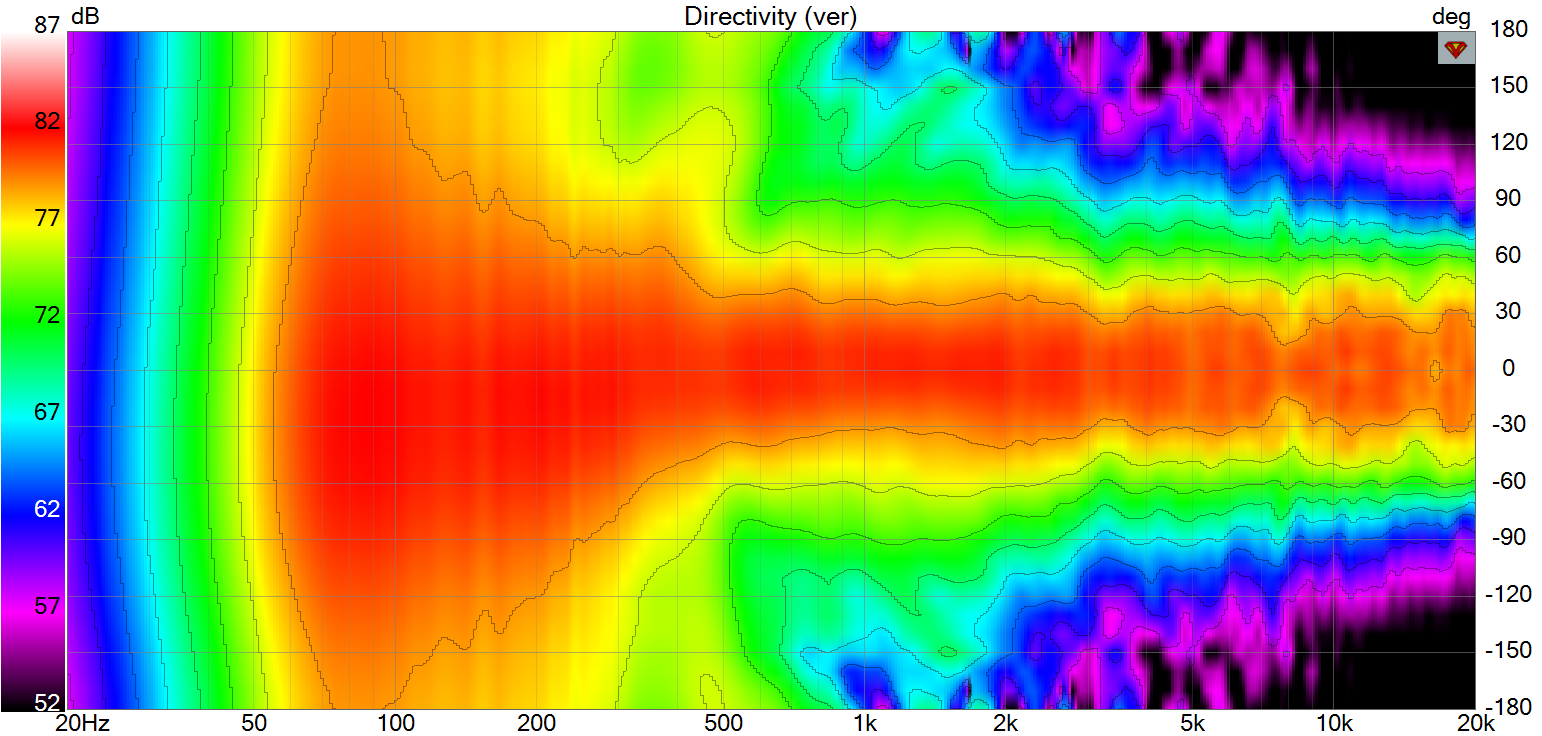

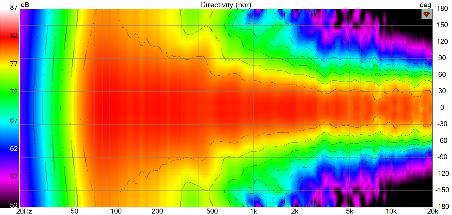

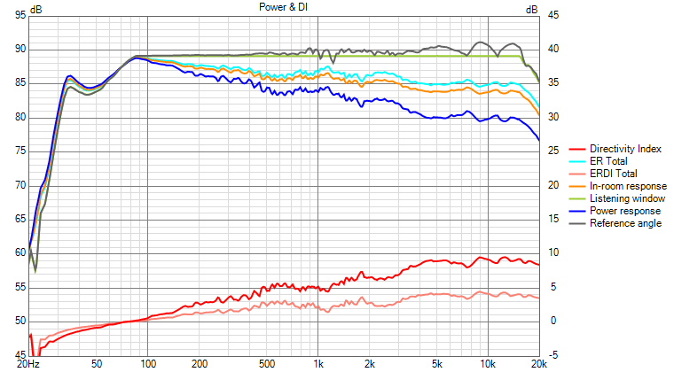

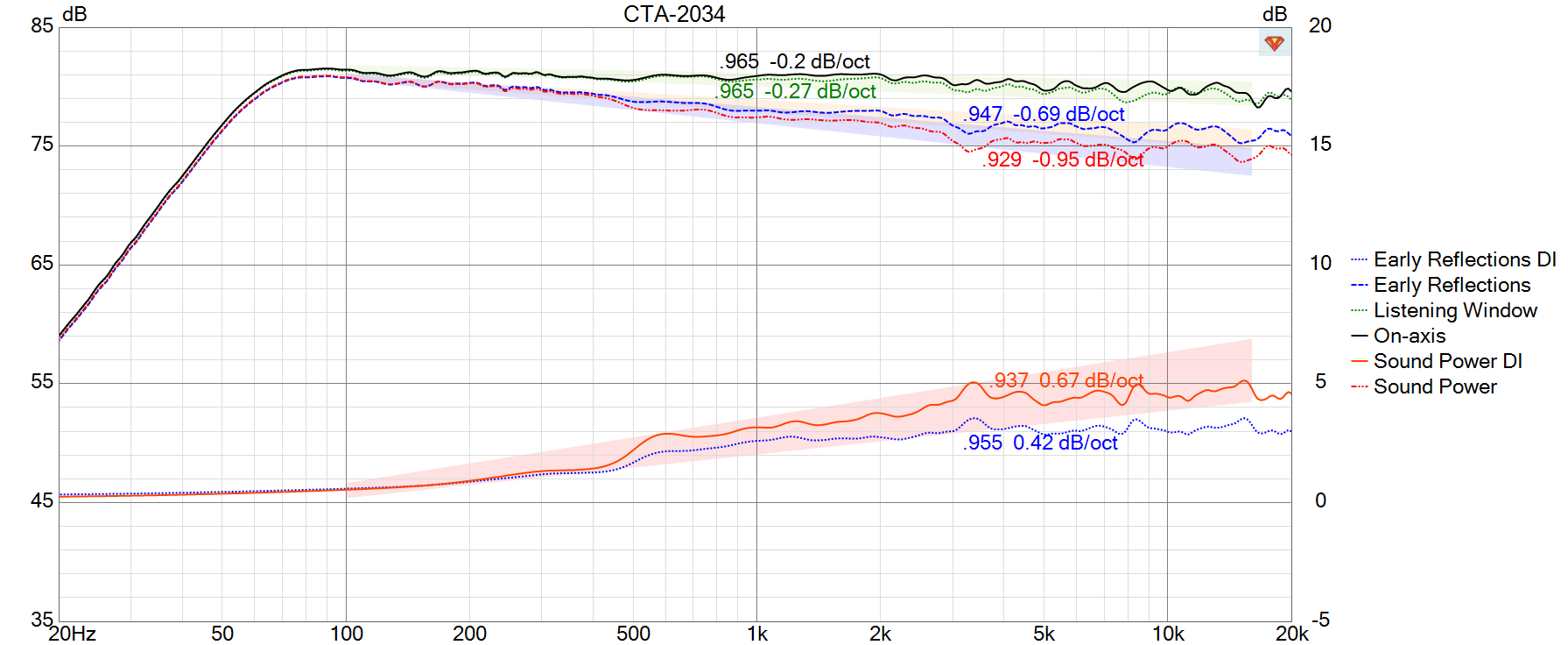

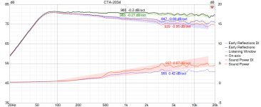

First up, some pretty colors:
Edit: Feb 2025- Speaker colours explained;

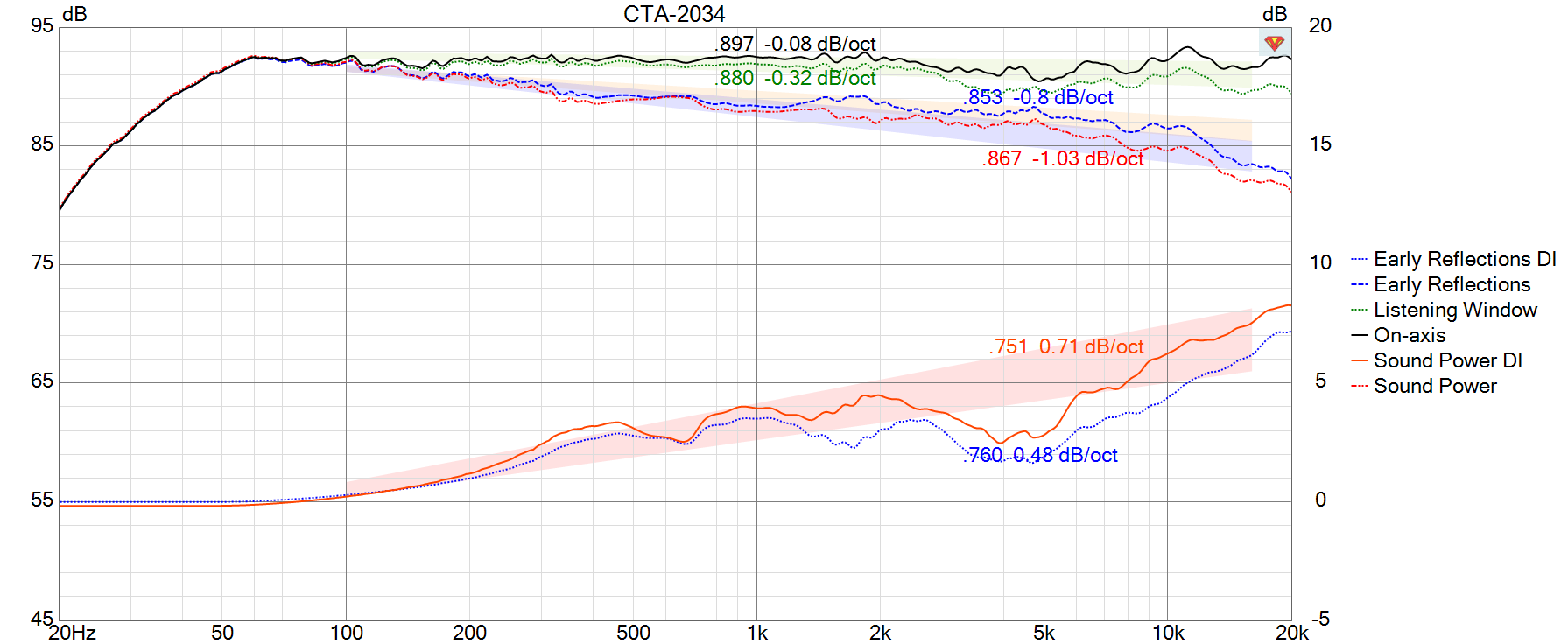

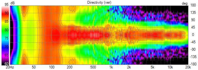

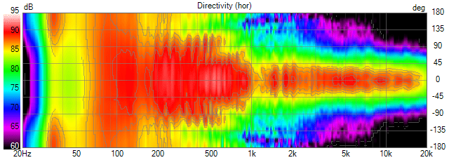

SPEAKER 3...
Normalised:
SPEAKER 3:
3 way speaker with twin 12” woofers in 13.75" wide, MT cabinet 9.5" wide with 6” midrange + 1” ring radiator offset from centre, no roundovers,
2.83V input applied:
Reference:

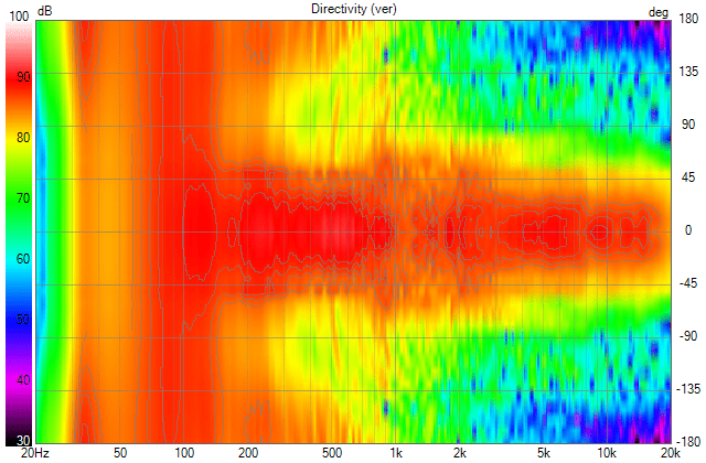

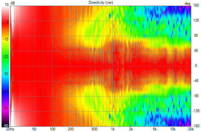

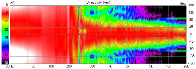

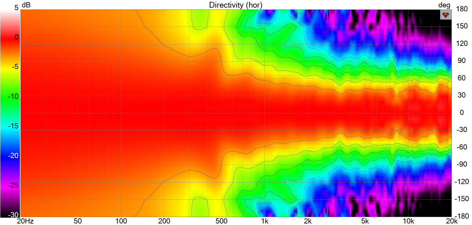

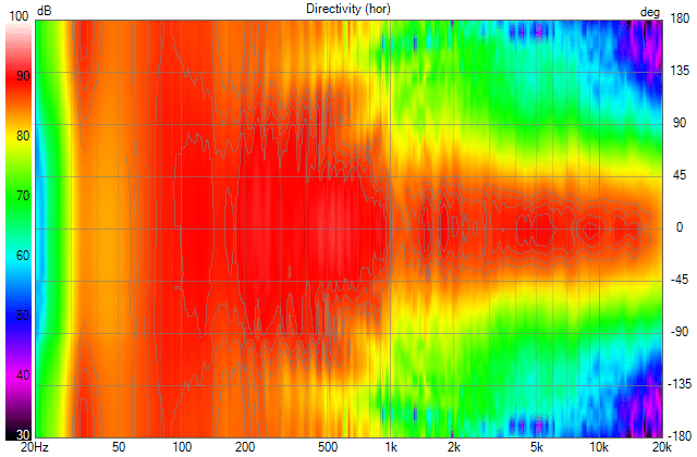

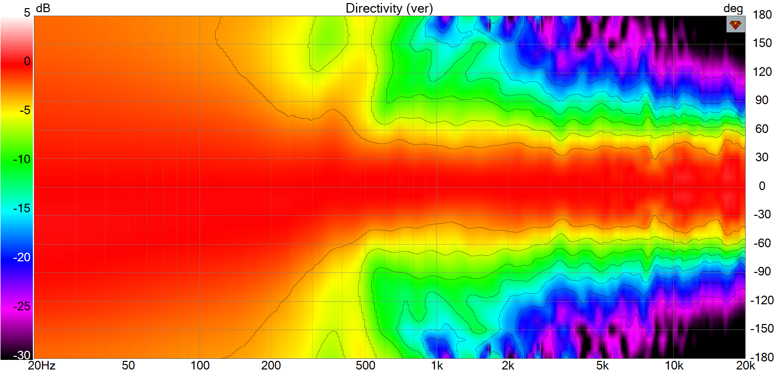

SPEAKER 2:
Normalised:
SPEAKER 2:
3-way speaker with 8” woofer in 21cm wide cabinet with 1" roundover, and 5”/1” coaxial driver,
2.83V input applied.
Reference:
Now, if you're not sure of how what these colors/shapes mean, then this directivity study is for you!
It's aimed at bringing you along the journey of speaker designs which have with smooth frequency responses in many directions.
If you are familiar with seeing a single on-axis (or a few off-axis ) measurements for loudspeakers, please have a look at this study to observe how off-axis measurements varying over a larger span eg. up to 360° horizontally and vertically may add value to your designs, and how the use of non-normalized polar maps may assist.
My study incorporates-
1.High Frequency devices includes dome tweeters, ring radiators, ribbon tweeters, compression drivers, in cabinets with and without round-overs, with or without waveguides/horns, or even without cabinets (nude).

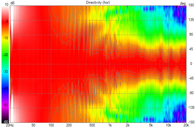

Speaker 1...
SPEAKER 3...
Normalised:
SPEAKER 3:
Reference:

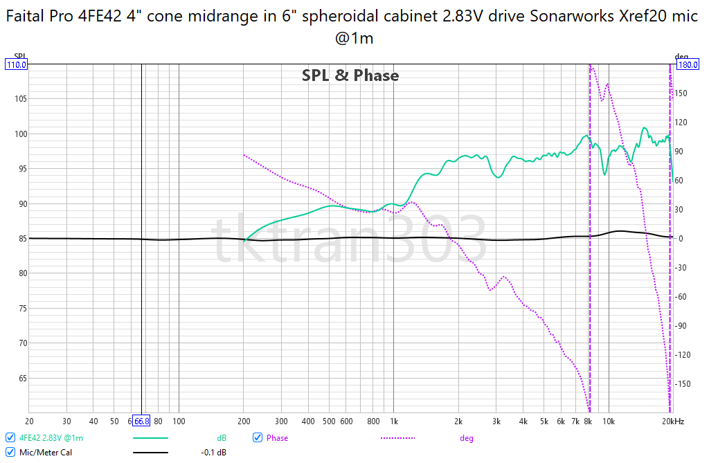

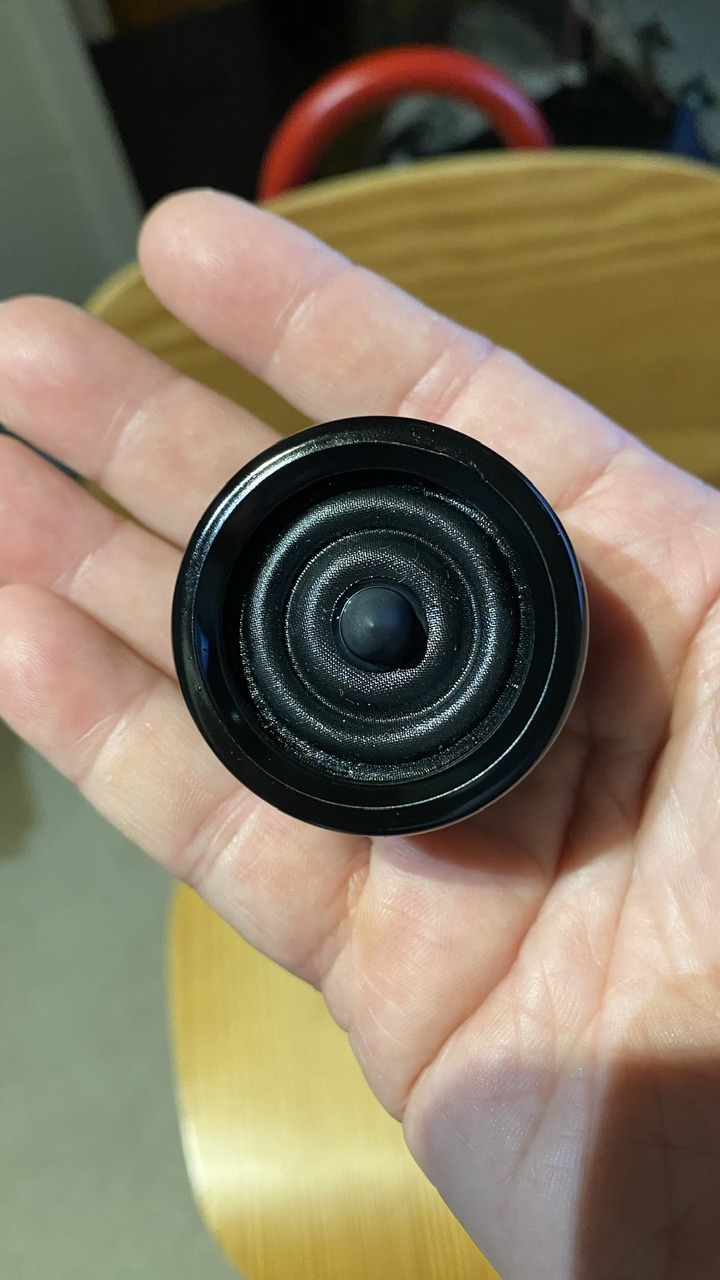

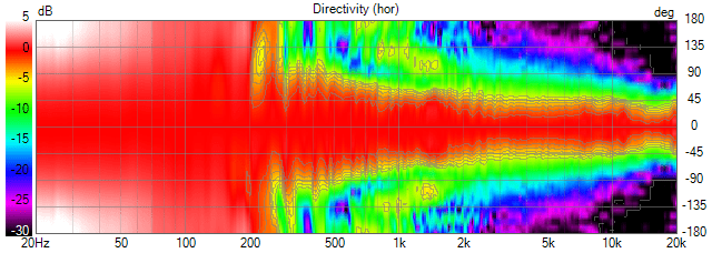

Just added:

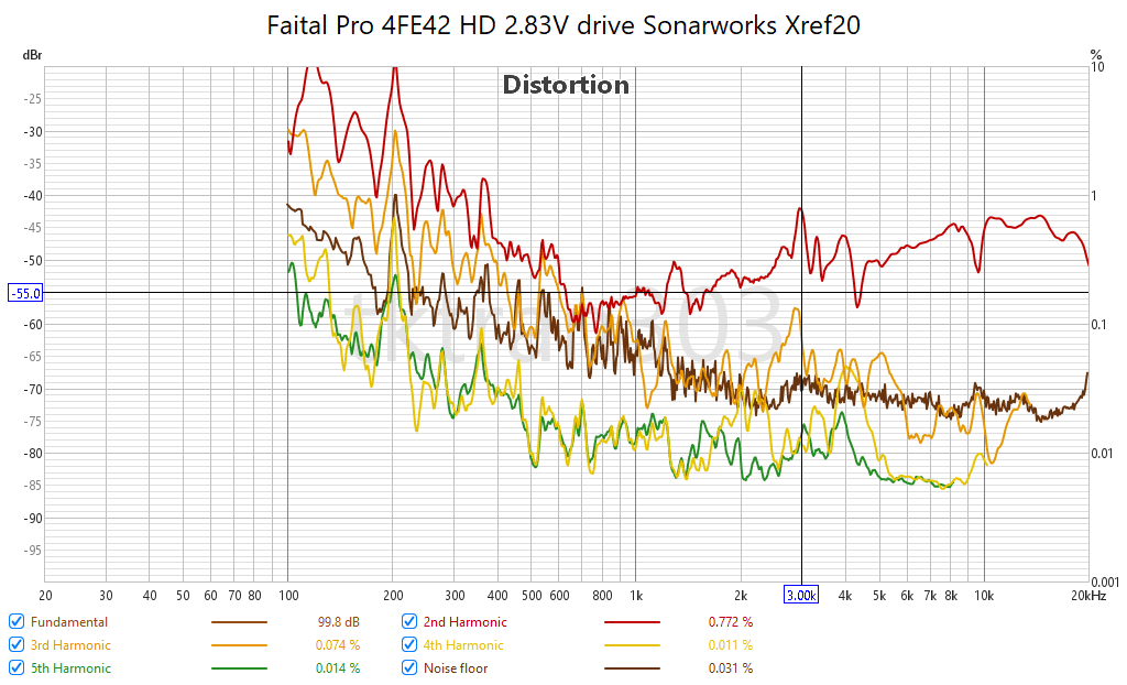

Faital Pro's new (for 2023) 4FE42 4" cone pure midrange, with copper sleeve in the neo motor
Reference:
https://faitalpro.com/en/products/LF_Loudspeakers/product_details/index.php?id=401005105
I mounted it in a 6" spheroidal cabinet, and here are some basic measurements, with a 5ms window (200Hz resolution)
Distortion measured at 0.5m...
This 8 ohm driver has healthy sensitivity of 94dB/2.83V sensitivity, and still 89dB after baffle step compensation. It can be used from 300Hz to 3KHz LR4, where the distortion is class leading.
Directivity studying pending approval: Faital Pro 4FE42

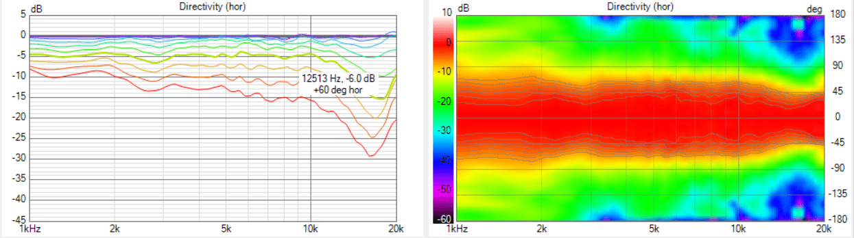

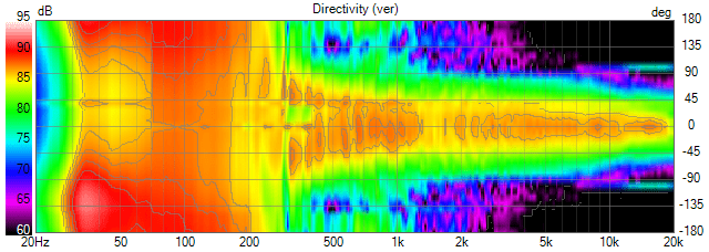

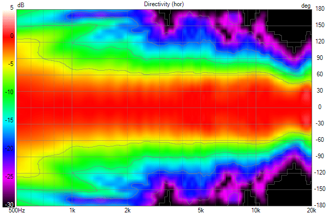

Sneak peek of a constant directivity waveguide with 60° beamwidth (-6dB) from 1Khz to 12.5 KHz:
And that's without a round over, facet or any kind cabinet edge treatment!
A round-over would improve the region between 2-3KHz
Courtesy @fluid.
Courtesy @fluid.

Just updated. Includes a few more drivers. I published it, normalized to on-axis, for now...
And I've left out the commentary, and with-held my own interpretations and thoughts. Let the diyAudio brains trust discuss, decide...

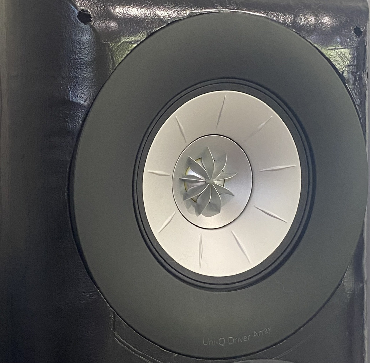

updated:
KEF Blade 2 Meta.
Sneak peek:
Actual SPL (non-normalised)
vs normalised (i.e. compared to on-axis)
Vertical actual SPL (non-normalised):
vs normalised
KEF Blade 2 Meta.
Sneak peek:
vs normalised
Not just complicated, normalized is the only proper way to see what's going on in terms of directivity.Is it it lot to ask to show us additional normalized on and off axis curves? It would then - at least for me- be much clearer to interpret the relationship between the on- and off axis curves. This now is visually quite complicated.
Non-normalized is only useful to see why the directivity at a certain frequency has a certain behavior.
But looking at non-normalized graphs for directivity purposes is totally useless.
Like you said, some frequency responses are FAR to complicated to understand what's going on.
Which very quickly leads to wrong interpretation and conclusions (and therefor misinformation)
You might as well just not post them for these purposes.
That's not an opinion btw. Sorry.
My point exactly. Thank you. If you want to see the effect of a round-over, a facet, a flat rectangular baffle, a spherical baffle, in combination
with what a particular driver does, this is advantage of non-normalized.
When someone says "Well I designed my speakers with DSP and it perfectly flat, but it sounded terrible" now you may see why a wiggly
on-axis response that is NOT totally flat might be preferable. eg. optimizing for power response.
If anyone just wants to compare directivity, you can straight to original source.
Spinorama.org is has it all, and more. No need view a remixed version here.
eg. KEF R11 Meta- out of the box:
Directivity, normalised: horizontal:
Vertical:
EQualised for flat listening window and downward in-room response:
Directivity: normalised, horizontal:
Vertical:
ie. there is NO CHANGE to a heat map in a NORMALISED VIEW
Here is the (non-normalised ie. actual SPL) heat map-
Horizontal
Before EQ:
After EQ:
Vertical:
Before EQ:
After EQ:
Normalised and non-normalised views each have their uses.
Just because it looks more complicated doesn't mean it's something to avoid looking at.

A great example of brute force equalization being a bad idea 🙂EQualised for flat listening window and downward in-room response:
