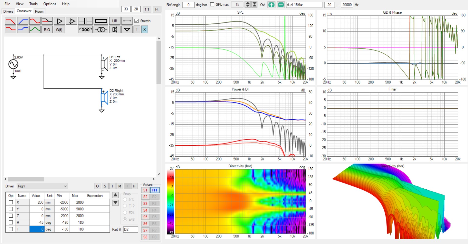

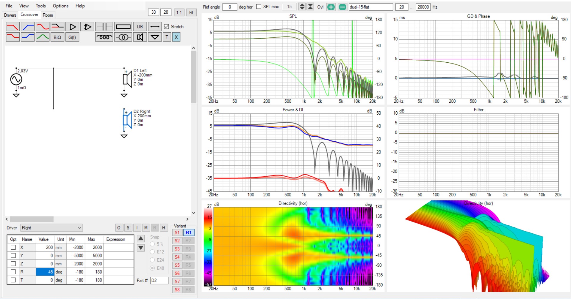

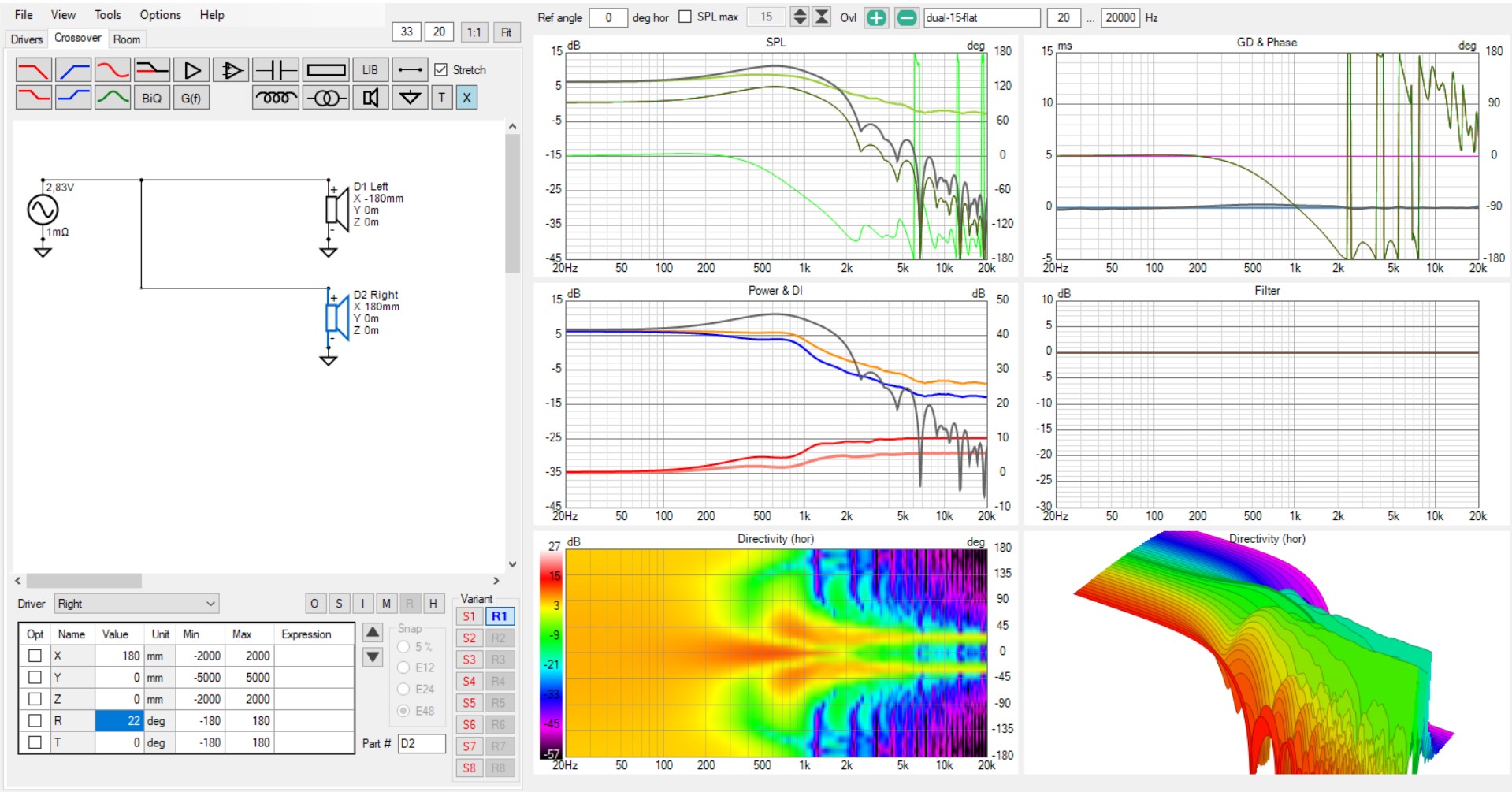

^ that is very intuitive and easy to think how it should work, but the data seems to indicate toe in works better in terms of easier integration to a horn. Unless I'm interpreting the simulation wrong, positive angle on right driver (that has positive X offset to the reference axis) should rotate it outwards and it looks like it but I'm second guessing because it feels like against intuition Anyway project file, diffraction simulation and the resulting measurements attached if someone wants to play with it.
Here is another set, the attachments are
1. baffle sim whose response loaded to the drivers, both use the same
2. toe in - rotation 22 degrees inwards per driver
3. toe out - rotation 22 degrees outwards
4. toe in - rotation 45 degrees inwards per driver
5. toe out - rotation 45 degrees outwards

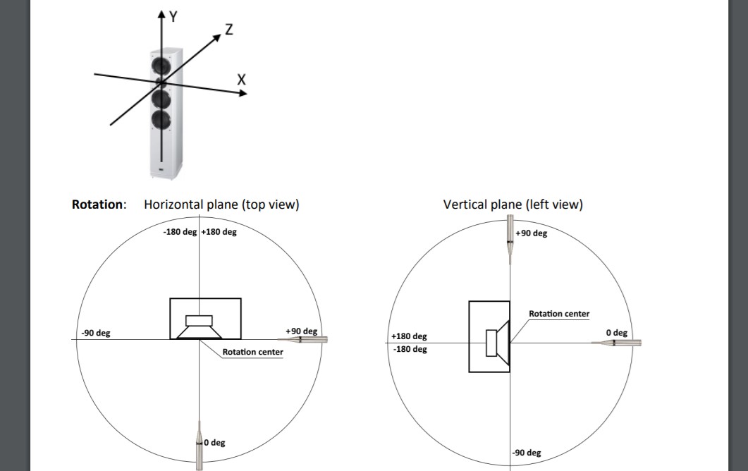

6. coordinate system
and the project ZIP.
edit. thinking of it the toe out responses are probably closer to real than the toe in where the drivers would obstruct each other a bit causing interference.
Noticed the 22 degree samples have bit smaller X offsets but that doesn't make much difference at all.

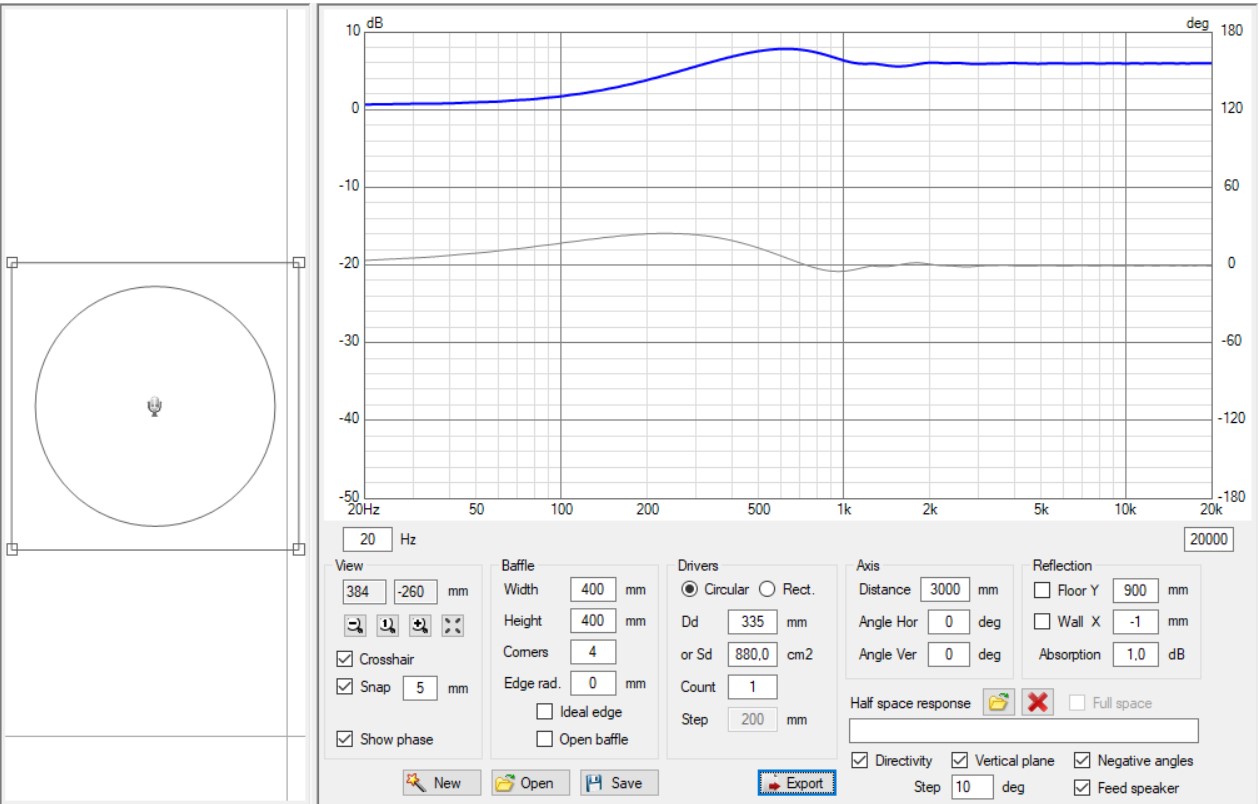

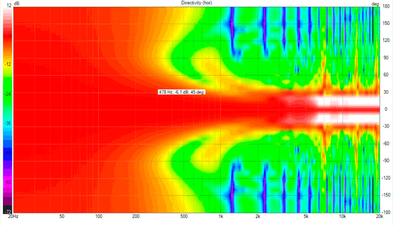

Actually there is some difference due to smaller X offset! When c-c is 360mm (180mm and -180mm on the drivers) the side lobes are not so pronounced around 1kHz. But increasing the spacing to 400mm nominal 90 degree pattern goes lower. The other has 90 nominal horizontal dispersion around 550Hz and the other around 470Hz.
If the 400mm wide test baffles were right against each other side by side flat, c-c would be 400mm. Rotate both about 22 degrees either way and the c-c becomes smaller, to about 370mm (if calculated using trigonometry and not just approximated . Or does it stay at 400mm on toe out situation, measured around the corner? Too late evening for serious thought.
Attached GIF shows toe in situation with 22 degree rotation on both drivers. c-c spacing is varied between 360mm and 400mm. The polar map is normalized to give good look on the pattern.
It is interesting to observe there is flat DI above ~1kHz in the toe in situation which can be increased or lowered by changing the rotation angle of drivers. Optimal angle seems to be somewhere between 10 - 35degrees perhaps, depending on what kind of horn there is to integrate with. Less rotation makes the pattern very narrow. More rotation and the patterns seem to get too wide and dirty. Less c-c seems smoother on the lobing sector but more spacing gives pattern control to lower frequency.
I suggest anyone considering such system to play with the simulation, it is very interesting to see what happens when parameters get manipulated and try to get a good balance

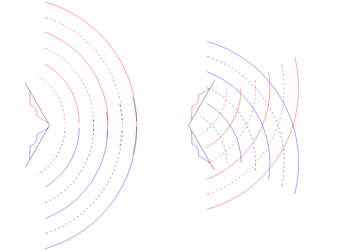

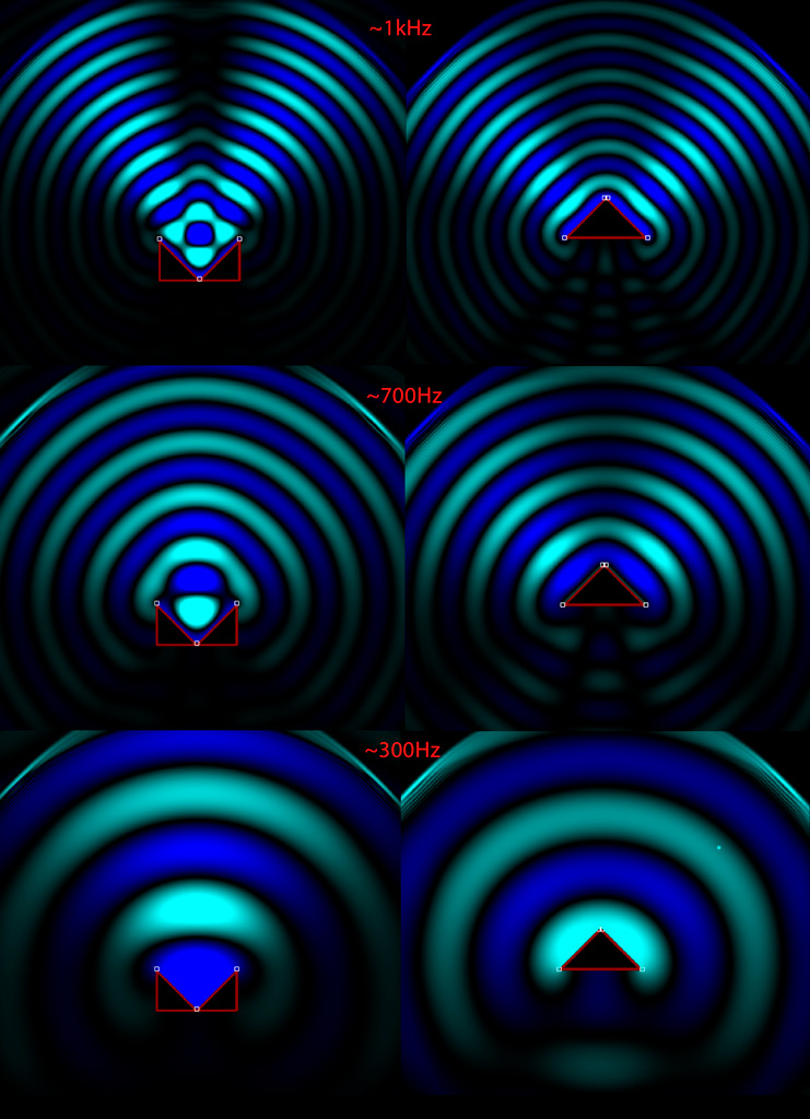

Few ripple tank sims, not too accurate since the UI is very coarse but should be in the ballpark. For anyone to test and wonder whats going on
Toe in ripple tank
Toe out ripple tank
Toe in ripple tank
Toe out ripple tank

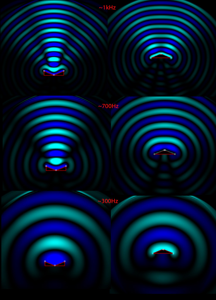

Here are 22 degree examples
toe out in ripple tank
toe in
Resolution should be ~50px corresponds to ~40cm, in which case the ripple tank setup should roughly match reality.
From the ripple tank tests it looks like the VituixCAD sims have the coordinates right. Toe in setup with 22 degree rotation has strong main lobe ~1kHz and weak side lobes. The toe out has narrow main lobe and wide side lobes, all almost equal in SPL.
From the ripple tank tests it looks like both have relatively few issues around where the crossover would be closer to 500Hz than 1000Hz. Although, the response may differ here significantly since both drivers interact with the physical construct which does not happen in VCAD sims I posted. I have no idea which one would work better in which situation. I strongly suggest build and measure since these are very quick and rough sims to give some idea how a system like this could work.
