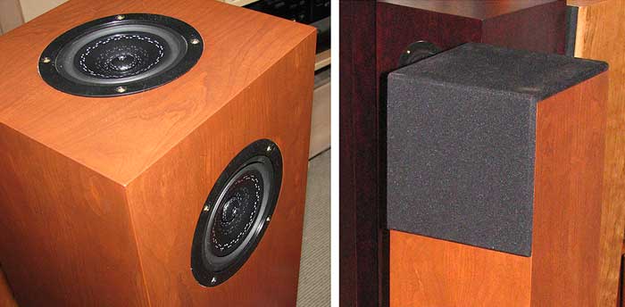

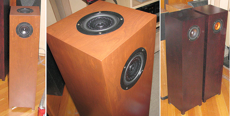

I do not know about bullet tweeters. The tweeters I mean and which I measured look like this (watch photo), it is a mix of cone and dome, usually with ferrofluid and they work perfectly with a single capacitor. It should be used a foil type capacitor for better sound. The measurements showed very good results - ruler flat and fine tone. I clearly understand why the industry uses them in thousands. They can be cheaply manufactured by machines.
I never tried the K design. I would like to test it with fullrange drivers in order to get better horizontal dispersion - l would like to read about this. I heard it is called "Karlsson Coupler". If you know a thread or a website about it, I would appreciate.

The side tweeters should be put at the height of the acoustic center of the main driver if you look at the box and you could look through the cabinet watching the main driver. (Look at the photo). This is in order to phase align as good as possible the extra indirect working tweeters.
The tweeters should give no output below 5 Khz because the ear can not hear phase distortions upwards of this frequcency.
If you have big fullrange drivers with a lot of beaming the side tweeters help "open up the sound" a lot.
