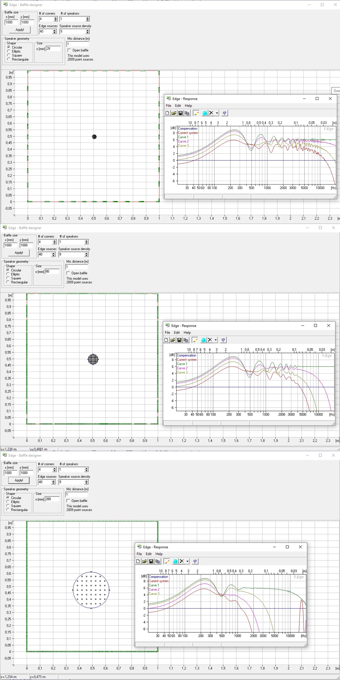

Edge overlays. Spl drop is exaggerated because with mic off-axis also distance gets longer. Mic offset 0, 250, 500 and 1000mm
Baffle diffraction changes too off-axis!
