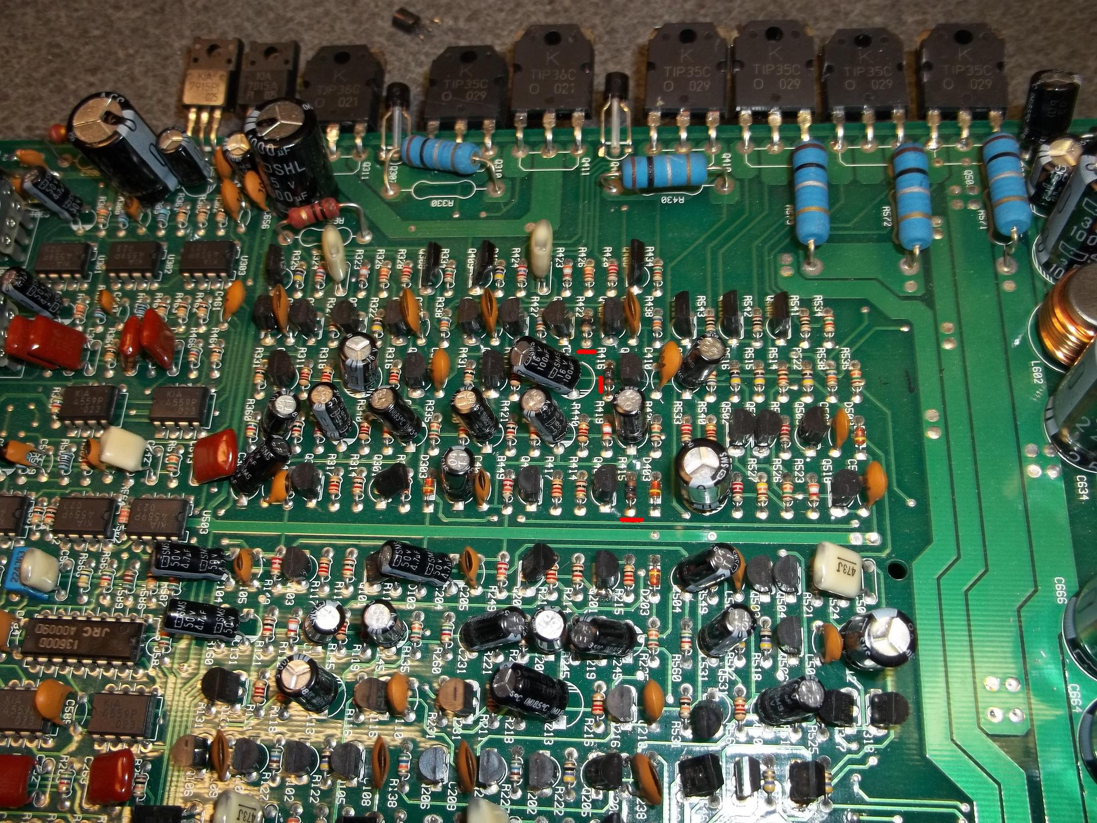

Pull it but be careful. The amp may draw excessive current. If it doesn't, check each channel to see if they produce clean audio.
Nope It just started burning resistors like crazy in the output section Even with a limiter in-line.
So now i have to replace 6 resistors.
Well, it looks like you only have one more channel to repair. 🙂
That channel obviously had a fault. Before you bypassed the protection circuit, you had no clue where the problem was. Now, at least you know which channel to look in.
