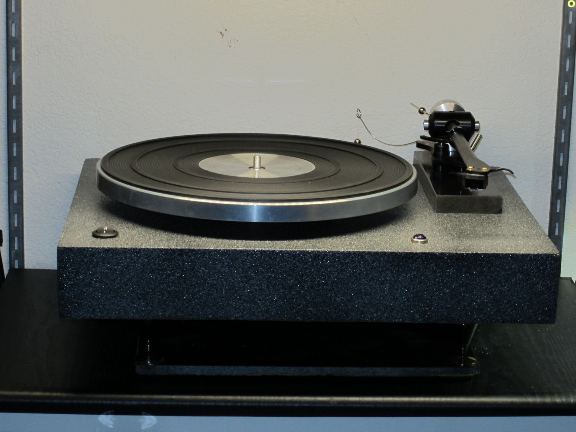

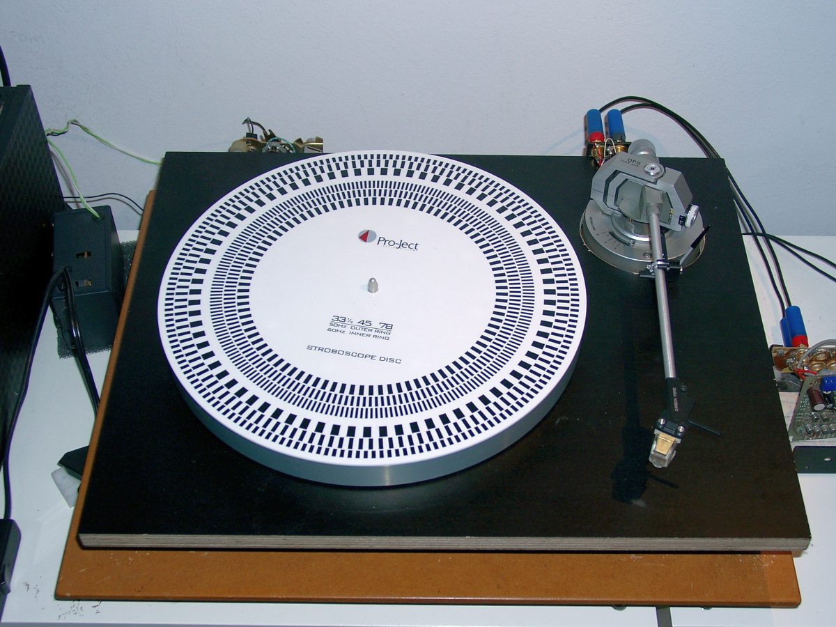

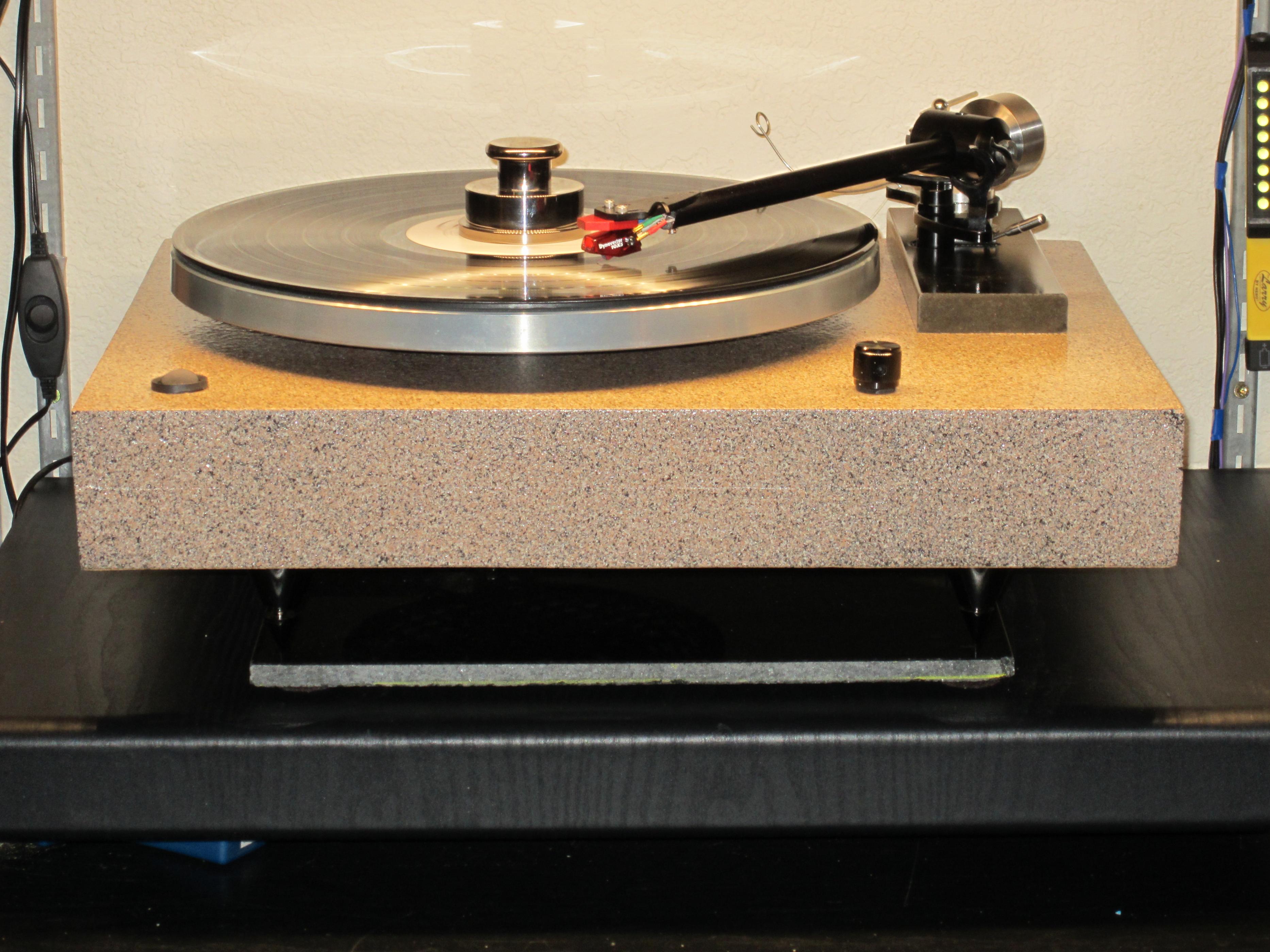

Hi, yes I used a Dual 701. It worked great. I had initial concerns that it would transmit noise though the plinth to the arm. Not to worry as it is extremely quiet. I used a composite laminated wood base made from a laminated plank that was about 1.25 inches thick and had around 12 slats. I laminated two of these together at right angles for the plinth. The rest was wood working. I mounted the power supply in a cavity of the plinth on rubber mounts. I used an Origin Live Alliance arm and it now sports an AT33PTG/II cartridge. Super sound. BTG I gutted all the auto parts from the Dual and used only the motor, PS and controls. The one photo shows how it looked with a The Alliance Arm and a Dynavector 10X5. The second one shows how it is now. I changed the finish to a pebble granite one with several clear coats.

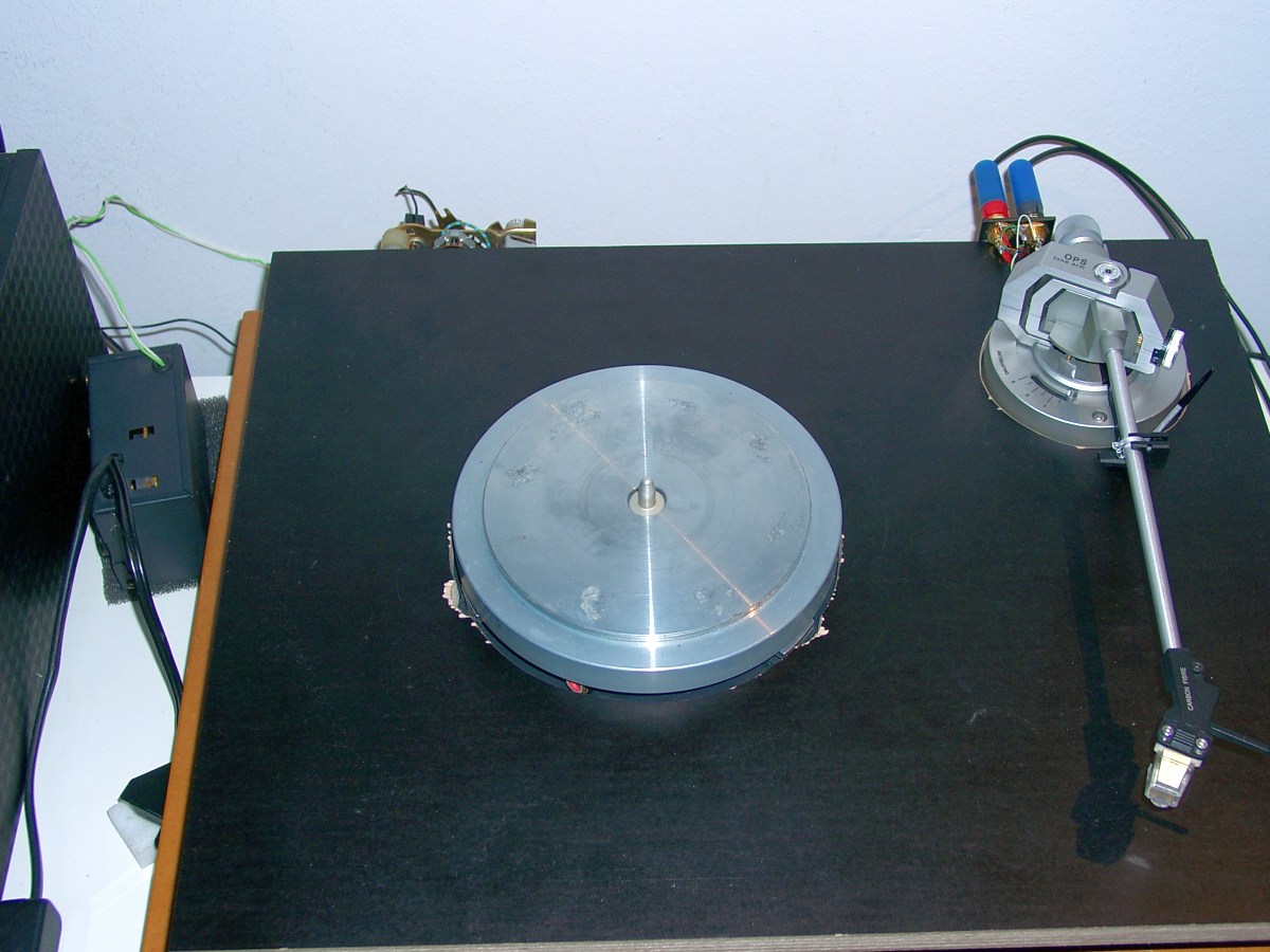

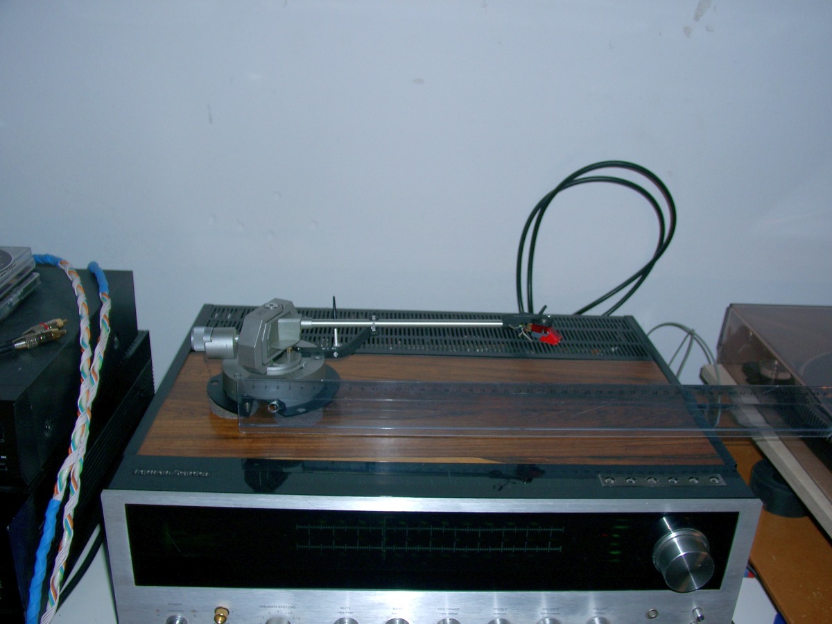

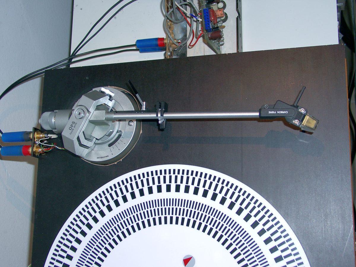

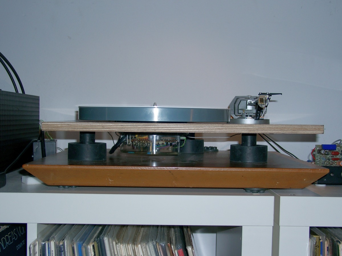

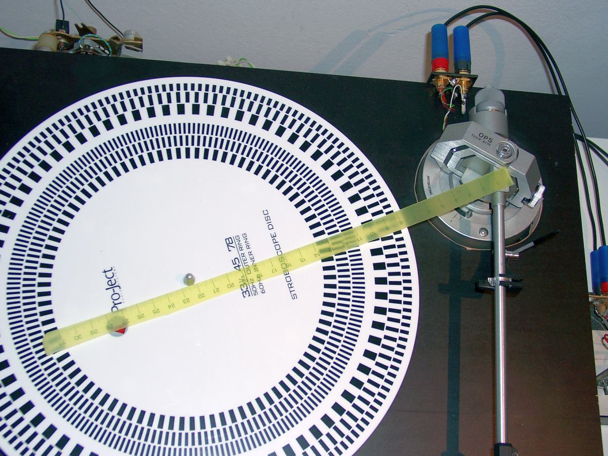

Here is my simple version of a DIY DD using a Dual EDS1000-2
and Dual OPS tonearm from DualCS5000, with a 9.5Zoll extended tube.
Inner and outerplatter came from a LP12, feets from Linn Basik.
