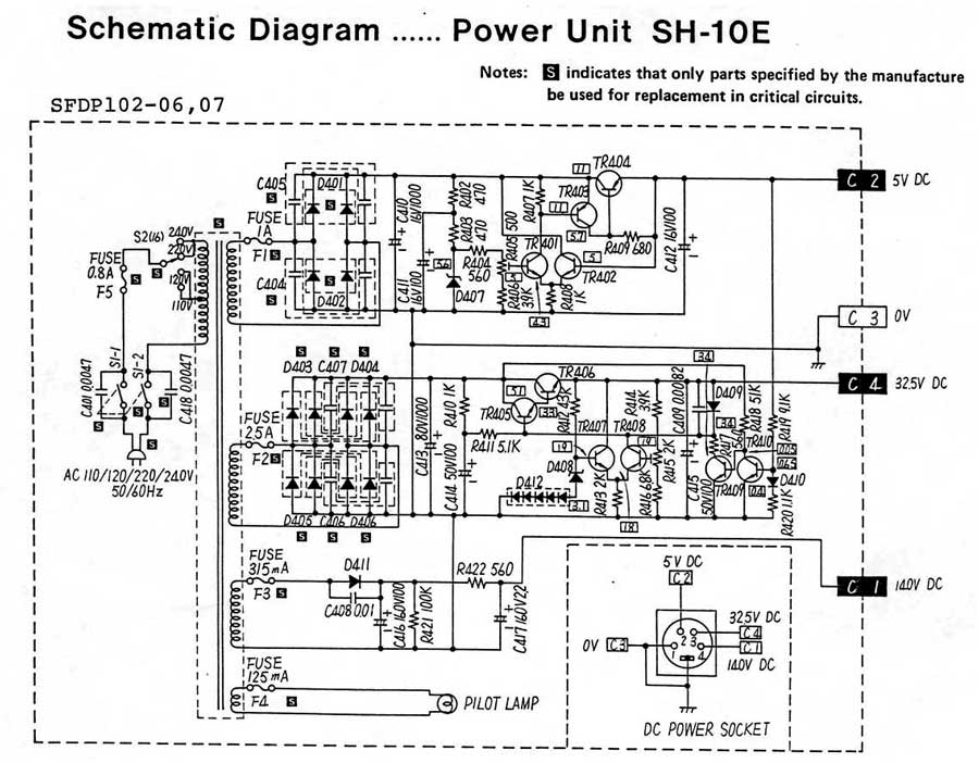

just in case
Zen Mod said:
just in case

brianco said:
Many thanks, but the PS is a sp10EP, I have the schematic, but the PS was modded & changed by the BBC!!!
You have email.
Many thanks again,
Brianco
that was why I wrote "just in case"
you have mail ,too
ps-mebbe you can post schm for your SP10EP (here or on mail) so we can try something together
