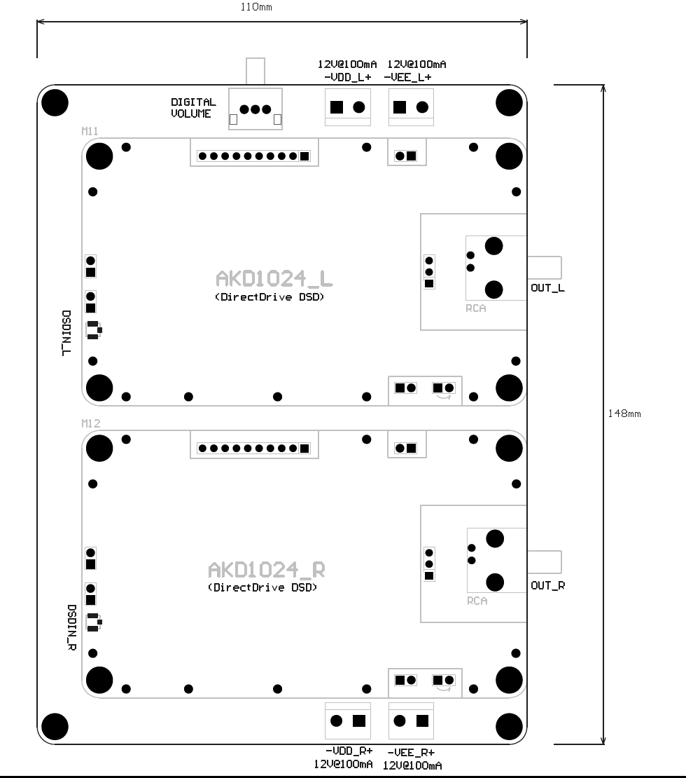

After I sorted out the relay problem on my simple LP filter DSD 'DAC' project I have been really enjoying it plugged into my main system over the weekend. I've been feeding it DSD256, upsampled CD rips on HQPlayer, and the sound is very musical.
My thinking has turned to how it will perform with a couple of your new modules, which should slip in very easily. With the future in mind for upgrading this project but also building a tube filter/buffer, some questions if I may;
1. Have you finalised the power supply requirements for the new direct drive DSD boards?
2. Is the DC servo before or after your on-board LP filter?
3. Is the server defeatable?
This info would help me to plan the projects and get ahead with some assembly in preparation.

Things are slowly shaping up. I am not doing another prototype so pretty much aiming for a release version with everything integrated. You will need dual independent 12V dc supplies (or bipolar types) as shown. Supplies can be raw dc also (12Vmin-18Vmax).
Servo sense is at the output terminal itself after the on-board LPF but being direct coupled it does not matter whether it is before or after. Servo is an integral part and cannot be disabled by user. It is not in the signal path and functioning well as expected. If servo is removed then you will need dc block caps or transformers that I am trying to avoid.
I will need some time to fine tune the layout and vol control firmware - no ETA yet. So until then you can go ahead with your setup and experiment with filters/tubes (and PCM vs DSD). Maybe you can get someone to loan their top-gun PCM DAC for a shootout 😉

Are you going to do a digital volume control in the chip?
Yes, already implemented
Oh cool. So you convert it to multibit DSD within the chip, and implement the volume control?
I am really noticing lately how processor intensive it is applying volume control to DSD via HQplayer.
The AK4490 can also do volume control to DSD like the 9018. But the way Sonny has it setup on his DAC, the DSD bypasses that section and goes straight to direct mode. It's supposed to sound better this way, but I don't have the firmware to flash it to the other way to compare myself.

Yes, something like that with its own processing unit. Can be bypassed also so comparisons will be made once completed.
Just thinking about the potential tube-based filter/buffer project. DC not such an issue then as it can be used for biasing tubes. To use the tube filter I would need to remove the onboard filter and tap the signal at the input to your filter, which would have the affect of taking the servo out of circuit?
1. Do not use this dc to bias tube or other stages. It is like a variable offset and you wouldn't want to use this as a bias voltage.
2. The servo and filters are separate circuits and do not interact. The filter is a simple LPF and is part of the internal output stage. I am currently using 50k cut-off but may decide on a 100k for the final cut. There is no need to tap into the circuit, just connect additional filter stages to the output as required.

What's your thinking about raising the LP cut-off to 100KHz - won't that restrict it's use to some people or are you saying it shouldn't be used below a certain DSD rate?
This is the intention, based on understanding of DSD so far. So, yes, moving away from Scarlet Book DSD64 that is not exactly great and requires heaps of filtering. At DS256, filtering becomes more relaxed and we can take advantage of the wider bandwidth
You can bring down the cut-off frequency by adding caps on the output side and there are pads on the board for this. Of course, if you are adding external tube buffers/filters that are set to 50KHz fc then these will dominate.
Output is voltage-mode (Zo~600 ohm), easy for HiZ stages but can also be driven in current mode with 20mA p-p max if this is more suitable for your amplifier. Alternatively buffer is required. What is the Zin of your amplifier?One of the reasons I've been contemplating a tube stage is that my power amps seem to thrive on a high-current capable source - any thoughts on that with respect to your output stage?

Thanks Ray, no problems, happy to help as much I can 🙂
I am curious about the effect of buffer added. Good you brought this up and requires further investigation
Technically speaking 100K Zin of your amplifier is very easy to drive with just 0.6% drop of signal and 30uA load pk if connected to this DAC. It has a pure resistive Zout of 600 ohm for the entire audio band. The output drivers can supply 20mA peak. Anyway, something to think about and I will also see if adding buffer makes a difference. You can also use the JG Buffers here with blocking caps
