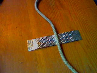

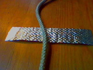

Materials fore the corrugating shown below, I found those in five minutes, just looking around
Rolling a piece of flagline over an old T-shirt
Mind you, this foil is the heavy type, and not the one I recommended
But it will still work fore a very good sounding ribbon
Regarding corrugating patterns, its all about imagination, and experimenting

Very interesting corrugation technique. However, I would be worried about fatigue life with regards to microcracks forming on the surface of the ribbon due to stress concentrations imparted by the corrugations. Definitely something worth testing.
Gold leaf would be interesting as well.
Tinny ,
No that was not the corrugation i was talking about , Is that even deep enuff to call corrugating ?
I cannot comment on such small dimpling of the surface as shown , i would think it would be better than the typical corrugation used by most DIY .
The only downfall from what you have shown is that the ribbon will have no suspension . I would corrugate the ends and leave the dimpled surface shown .

The ribbon is the suspension. It should be linear below the proportionality limit.
Ok
If you use a ribbon diaphragm with plastic film backup corrugating is not needed, but also not possible
It is tho exstremely essential when the ribbbon is pure foil only
Without corrugating it will rattle, a lot
Maybe it was wrong of me to bring it up, knowing that you will do it with backup film
It is possible to get a feeling of how a material will sound
Hold the diaphragm up between your fingers and blow gently on it
And you will hear how it sounds, and how it changes with different tention
