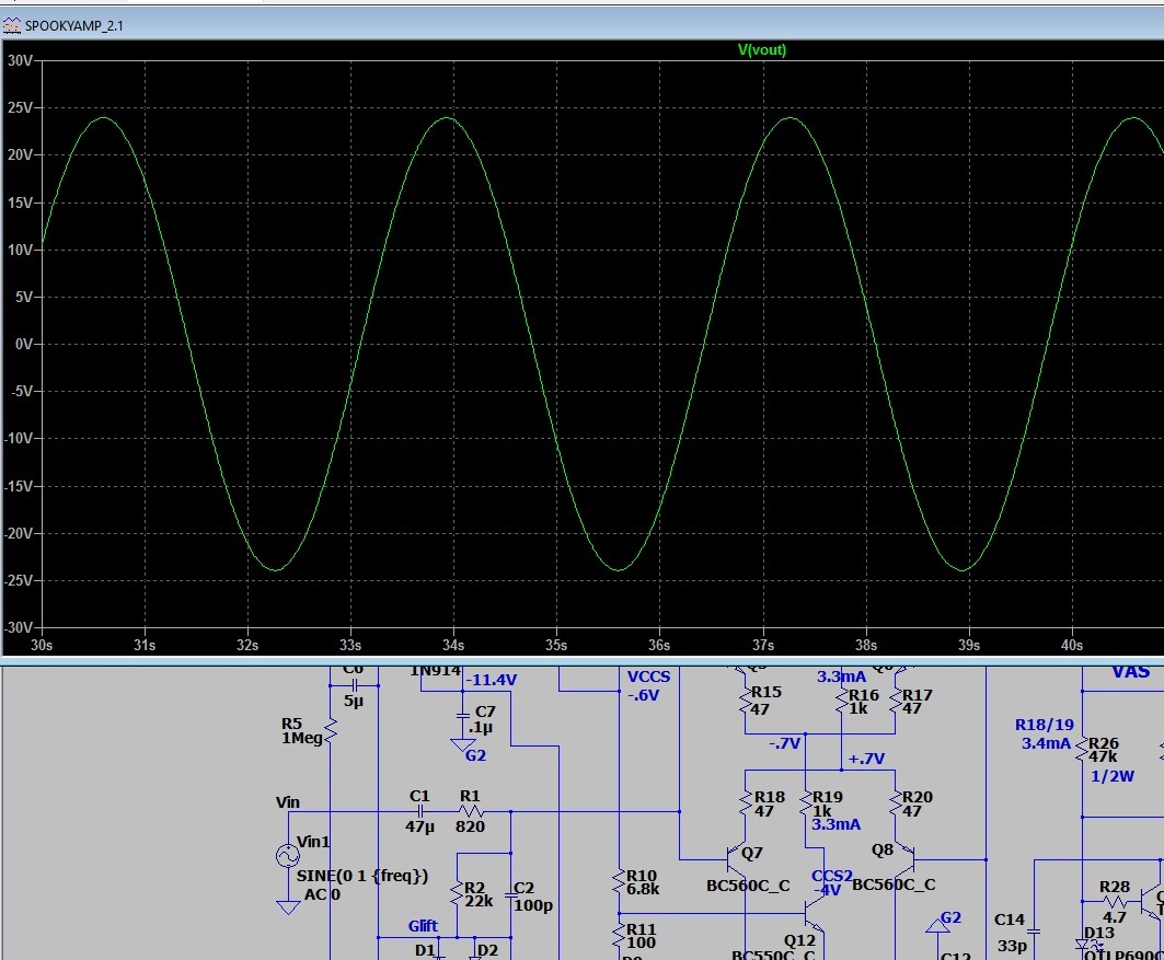

Servo is limiting factor. A servo Fc below 2-3hz is rare for an audio amp. I specialize in sub amps , I like <1hz!
DC blocking cap (in the design) will also roll off below a couple hz.
Below , my type amp will easily do 1hz , even with the safety of both a servo and AC input cap. I can watch my sub (pump) at 1-2 hz at nearly
full power. But not for long ... 1-2hz will overheat even a well vented , quality sub voice coil.
3K$ damn .... I could make a dozen 500W <1hz amps for that !!
Even without tweaking the circuit , 1hz is easy.
OS

All the advice in previous posts is good. You also may be able to find a used audio amp with sufficient power. As long as it features "direct-coupled" output drive and an available service manual, it's almost trivial to bypass a couple of capacitors and yield an amp with flat response to DC.

If a typical amp with a split supply doesn't already run down to 1Hz, you just need to upgrade the input cap and the feedback decoupling cap a bit and you have a 1Hz amp. DC is also possible, but a servo has a cut off frequency where it sees low frequencies as offset. You might be better off with a offset trim-pot.
