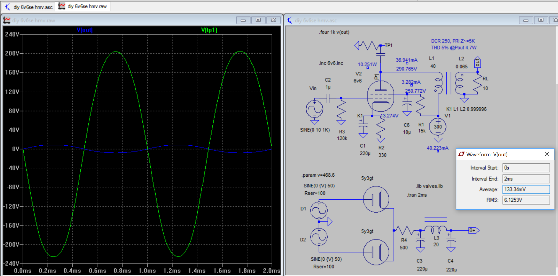

You can add a current tap instead of resistor, so if 5mA, 480/5~=100k. Bleed resistor 100k in your sch will not drop B+ output, but it does clamp unloaded peak or floating voltage from 470V to 460V, i.e. about 10V. The other thing is that C1 can not be too large, for 5y3GT it's 22uF, but since the inrush rectifier current is limited due to the use larger input resistor R1 500 ohms, I guess that might be ok(?).

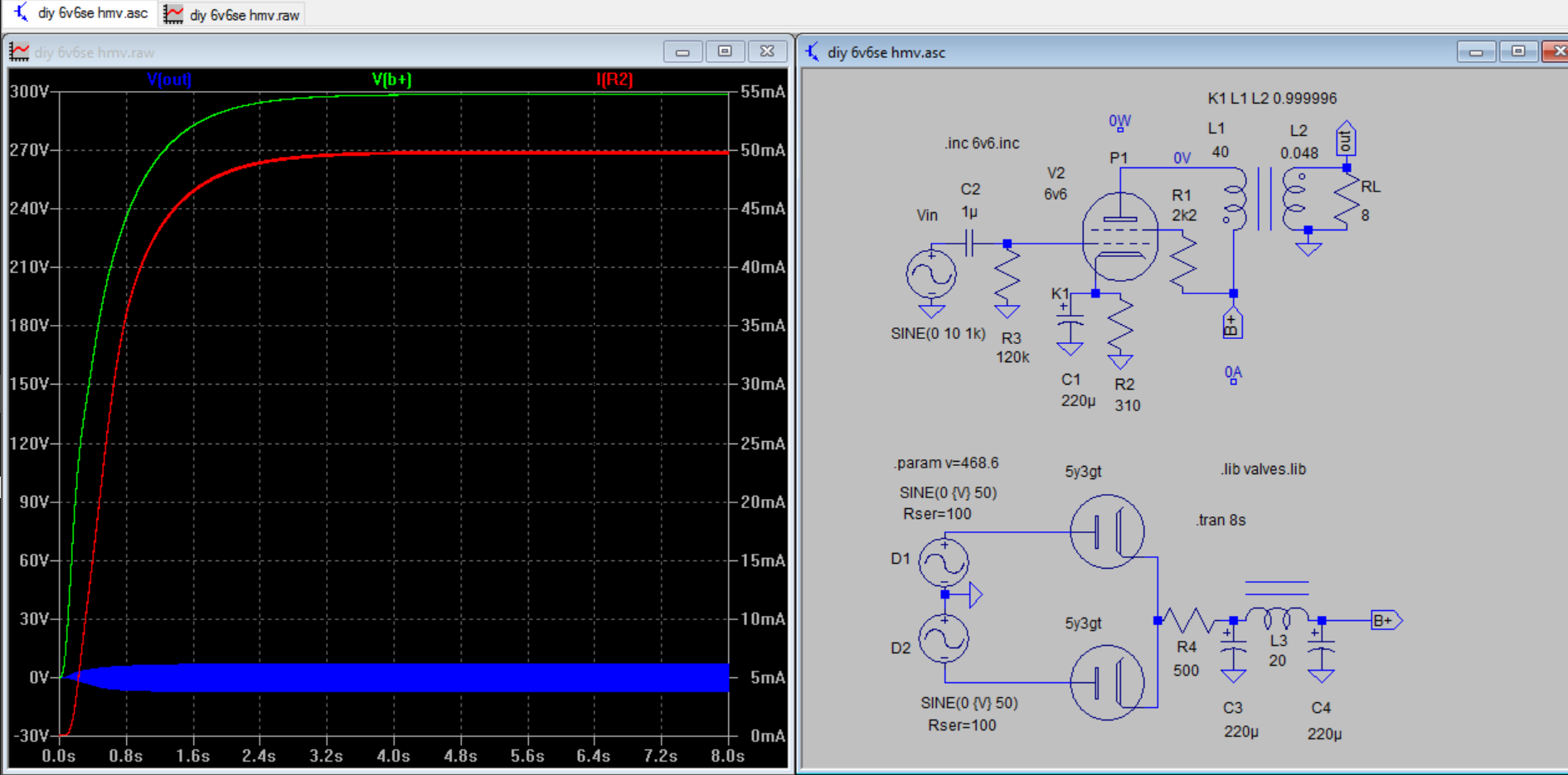

On the third schematic, you have 309V on C2, and a 50mA load.
309V/100k Ohms = 3mA
Put a 100k Ohm resistor across C2. OK so the voltage will go down to maybe 308V, because the load with the 100k bleeder added is 50mA + 3mA = 53 mA.

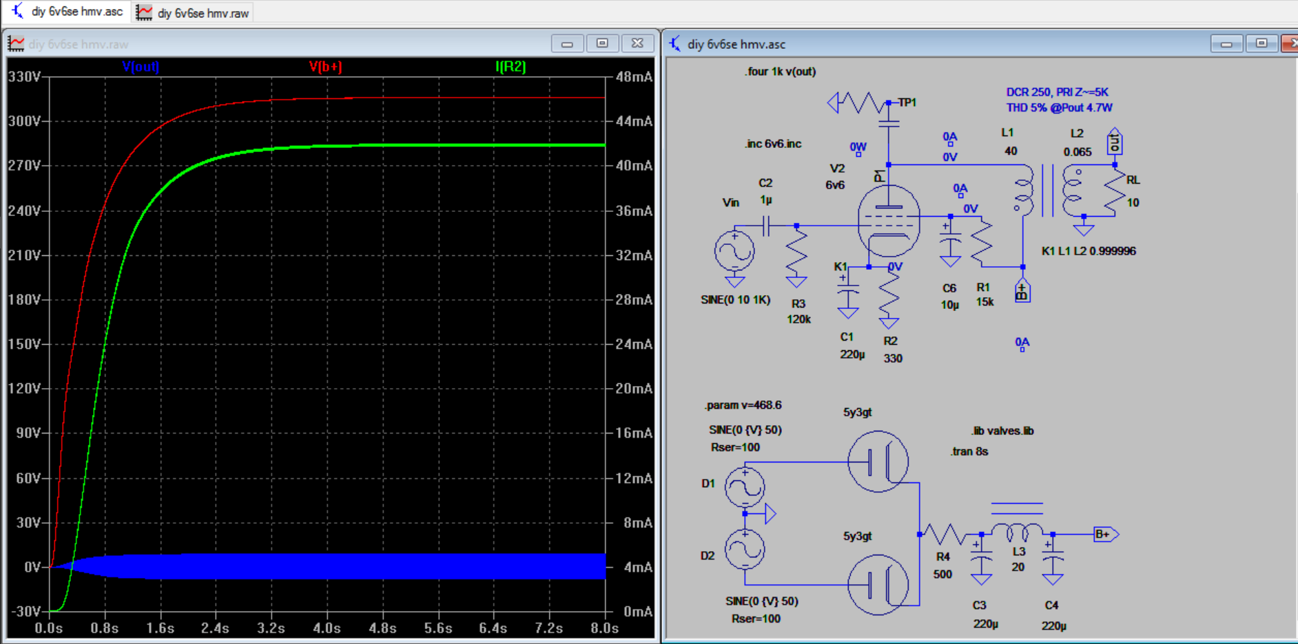

Whit the regards to the inrush current, I did not get the alert from PSUD2 so it should be ok (you can try changing for test the 500 ohms to 100 ohms).

Then 308V will be sufficient for powering up the amp schematic? Otherwise I can decrease a little R1 (of course looking at the IFRM - 0,44mA - limit for 5y3gt) to get little extra B+ in order to achieve 310V while the bleeder resistor is in place.

Yes, 300V is sufficient. I put it together now in LTSpice. This gives you about 5V rms over 8 ohms load or 3.1 Watts. You may need to adjust the bias by varying the value of cathode resistor of 6v6 so that it draws 50mA, depends on tube you're using. All is fine now, wish you all success and maybe send photo the progress of your amp.
Thank you so much for the clarification! How I can find the correct value of R2 (of the LTSpice model you have done)?

Simply cathode voltage (also bias swing)/0.05. If bias swing determined is 12.5v, then R2=12.5/0.05=250R
The bias swing is in term decided by the gain of stage. Your screen voltage Vg2 is about 290v, the gain is somewhat higher about 22 than if Vg2 is 250v. You can reduce Vg2 to 250v by increasing screen resistor to 12k, so make it easier to refer to standard datasheet based on Vg2 of 250v . The gain would be different if you use a different OT, so the bias swing would need to be adjusted to get full output. Of course you can have slightly more bias swing for more headroom, between 12v-15v across R2 is fine
You need to consult 6v6 datasheet to determine the bias voltage using the voltage across the tube and plate current. You also need to deduce the screen current Ig2 about 3mA, so that actual Ip=50-3=47mA. If DCR of OT=200R, then 200*0.047=9.4V, and if cathode voltage (bias) is 12.5v, the Vp=300-9.4-12.5=278v.

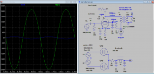

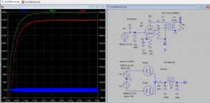

Here is another variation, the screen voltage is adjusted down to 250v and bypassed. The OT PRI Z is slightly reduced by 1K so the output is increased by about 1.5W. B+ will increase slightly by 20V and last one shown is for B+ 320V, the Pout is 5W.

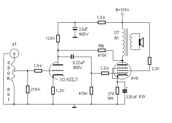

I have doubt about adding a volume control. If you look at the schematic I drawn I added a 100k pot just after the RCA input. It can be good? Or is better add a volume control between the input stage and the output stage?
The volume control belongs at the input jack, never inside a feedback loop.
Almost all tube amp designers tacitly mean to use 1/2W resistors unless specified otherwise, but you should also think about resistor voltage ratings. In this case, Rfb probably should be uprated to 1W or 2W just to insure good linearity with large signal voltages across it.
In that last schematic the volume control is right outside any NFB loop.
I would always use 1W resistors as the default, not only for linearity reasons, but also because they have more suitable voltage ratings for tube amplifiers.
