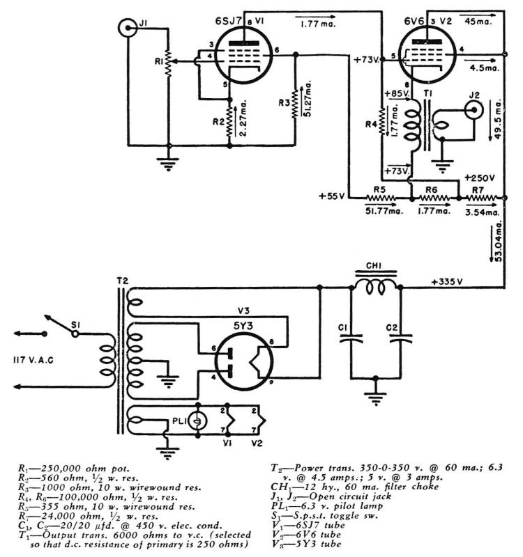

Currently I'd like to undertake the construction of a small direct-coupled amplifier (designed I suppose in 1949) capable according to it's designer of wide frequency response with small amount of components and with the minimum distortion (I suppose less than 2%?).
• As T2 - Power transformer, I found the 373BX by Hammond (http://www.hammondmfg.com/pdf/EDB373BX.pdf)
• As CH1 - Filter choke, I found the 157J by Hammond (Hammond Mfg. - D.C. Filter Chokes - (153 - 159 Series))
• As T1 - Output transformer, I found the 1629SEA (Hammond Mfg. - "Classic" Single Ended Tube Output Transformers - (1627 - 1642 Series))
Please see the attachments.
As regards these components I have some doubt about the CH1 (I did not found any perfect match). Do you have some suggestion ? Are the other components suitable for this amp?
Moreover I'd like to add a tone control, would you be so kind to explain me precisely how I can made this modification to the circuit?
And finally have you some other suggestion in building this little amp?

I'd use the 157L choke instead.
This is the kind of amp that might be best built on a piece of plywood. Getting output stage current dialed in properly will require adjustability somewhere, as your output transformer will not have the same DCR as what that amp was designed for.
Tone controls aren't going to be easy to add to this amp, you'll need more gain stages to drive them.

The 157J should work ok also, but has less inductance. There seems to be plenty of B+ voltage,
since 50mA x 429R is still only around 20V drop.

The schematic specifies the output transformer to have 6k/8R windings, with 650R primary resistance, and 50ma DC handling. That leaves the Hammond 1629SEA as the best choice from their offerings, as you found. Only 11 pounds.
I vote to build it on a piece of plywood so that you can easily dial in any changes that you may need to make.

Yes, 250R, sorry for the typo. Generally, mismatching the primary impedance can affect power, distortion, and bandwidth. Here, the difference is small and shouldn't make any difference.

At first look at the schematic I was skeptical about the damping factor.
The bottom of T1 has a fairly high impedance path to ground.
1355 Ohms to ground; & >100,000 to the right.
Apparently, the path from the bottom of T1 to the screen of the input tube is to give negative feedback. That will reduce distortion.
But the high resistance also reduces damping factor.
A second look shows the following:
The 6V6 GM is about 4000uMhos (250 Ohms).
The un-fedback damping factor is about 6000 Ohm primary driven by 1605 Ohms.
6000/1605. The un-fedback damping factor is 3.74, pretty good. The negative feedback to the screen should make it a little higher.

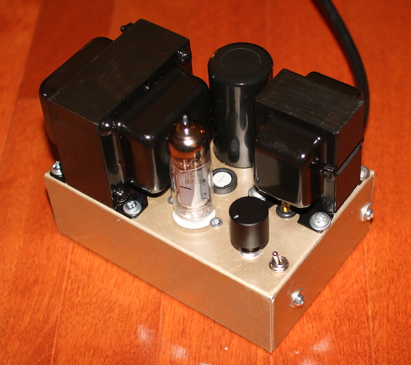

Cool project - I love the whole retro look. I made a spud amp ( http://www.diyaudio.com/forums/tubes-valves/280167-yukon-gold-spud-amp.html#post4460585 ) on a small metal chasis with a see-through perspex bottom panel and it's a great conversation piece plus to sounds ok too. It is crowded inside the little box, so I prototyped mine on a large metal experimental chasis first to get the part values to my liking and then I re-built it on a small box (see pic).And finally have you some other suggestion in building this little amp?
I tried using small transformers to keep the size and weight down. I don't think those large Hammond output transformers are necessary here. I'd suggest one of the small power Edcor output transformers instead and you can paint if black if you want to like I did (power supply choke is inside the box).
Hot resistors should have some way to stay cool, possibly bolted to the chassis if you can do that safely. Thermal considerations would suggest solid state rectifier, a personal choice of course.

There's nothing fussy here. Today, 1N4007 and 100uFd-100r-100uFd power may be cheaper or smaller than 5Y3, 20uF, and choke. Diddle the resistors to get 50mA in the 6V6.
I don't see how this can make a whole Watt output. Which may make THD and damping rather moot.
