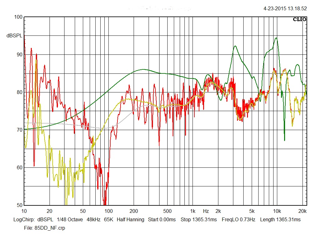

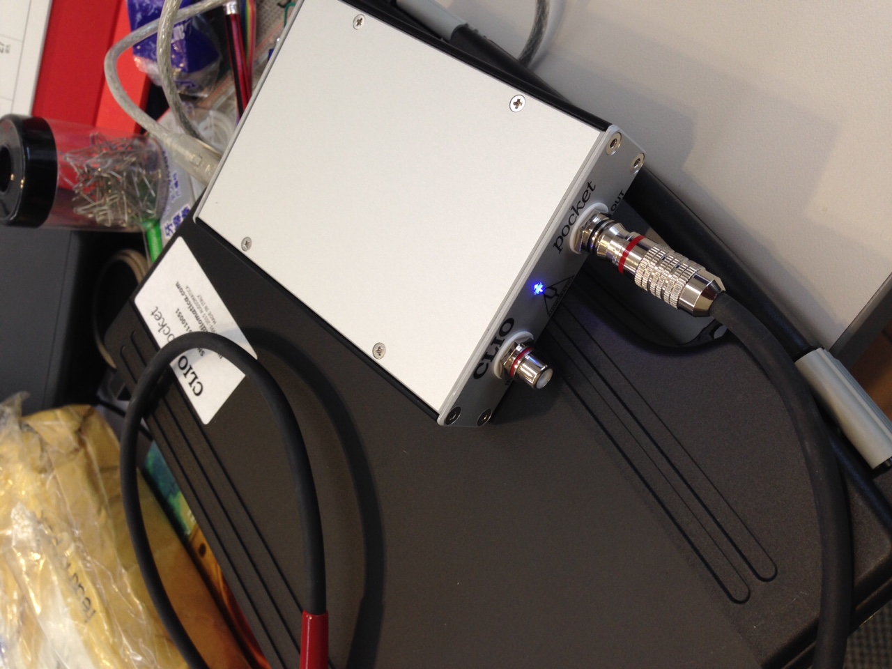

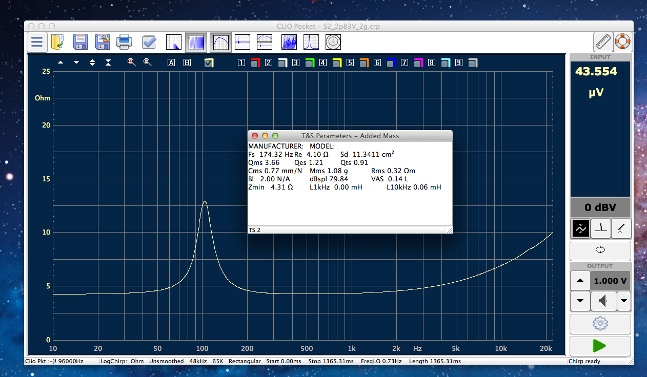

My CLIO Pocket has arrived! I like it using USB and the software supporting both Windows and OSX. It was initially tested in both WIN 7 PRO and OSX 10.7 (MBP) without any issue.
The current software does not support post data processing (add, subtract, etc.) as CLIO-10. For near and far-field splicing, I need to export data to ASCII files first and do that in, say, Excel or Response Blender by Charlie and Jeff.
I have been using LogChirp in other software like ARTA and REW. It is as good as MLS. In fact, LogChirp has better low-freq noise suppression in my test environment.
When you use it as an LCR meter, sampling frequency must be 48 kHz. It should not be a real limitation in practice. Since I will use it only for speaker measurement, 96 kHz is very sufficient.

The software limitations, nearfield/farfield splicing, is disappointing. But if you have Clio 10 software, I suspect they can be imported there?
Logchirp is definitely superior to MLS and also much faster.
96KHz is OK for most things, agreed.

The Pocket software can import MLS files generated by CLIO-10. However, it save in a different format CRP (logchirp).
I ordered it from a UK dealer. It is £439.
Sorry, you can do near and far-field by the merge processing.
Math processing: Add, divide, merge, dB shift and mic in box. Impulse data can be exported as WAV file for further processing.
The current software does not do THD. On the other hand, it measures DC resistance of a driver. I can't recall whether CLIO-10 has this feature or not.
