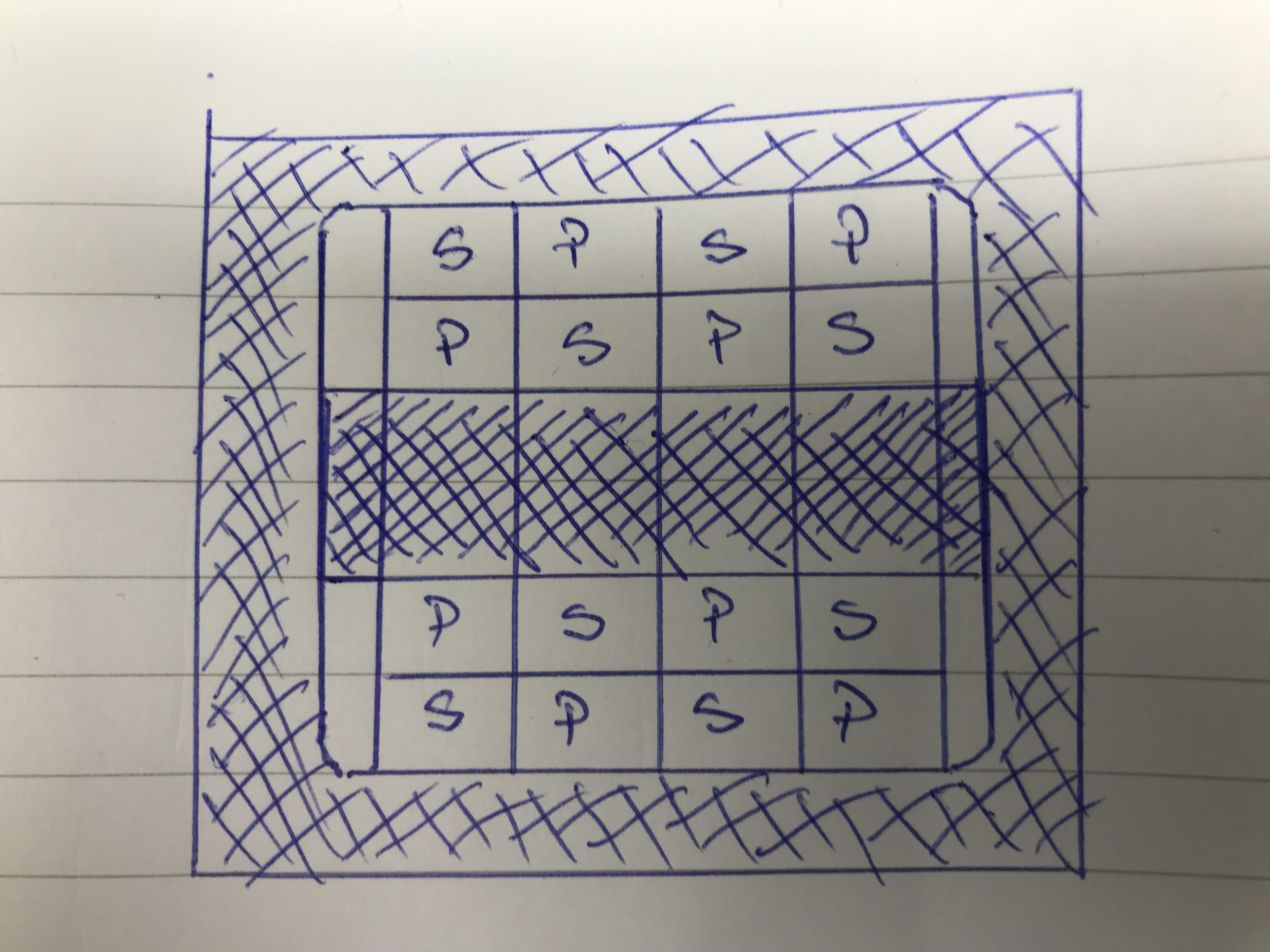

You can also do a williamson type output transformer but with 4 sectors instead of only 2. You will have very good low end and high end also because the coils are wound symmetrically.

I need to think about it using a clear head, which is not possible atm... too immersed with my problem.
Your stuff seems to be a hybrid between PI winding and interleaving, right?
P.S. I'm having extremely good success by distrubing the capacitance more across the primary to primary layers than to the secondary layers. Now the resonance is almost gone and reaching 200kHz.
Well it's not my stuff... I base it on old ham radio books and my experience with high efficiency and high frequency switch mode power supplies.
Best transformers I used were wound like that... You get good coupling from primary to secondary. Best method for insulation transformers (when primary and secondary are identical) is to twist the wires and then wind with them.
My proposal is similar it's an interleaving of the primary and secondary and should have better frequency response and lower copper losses.

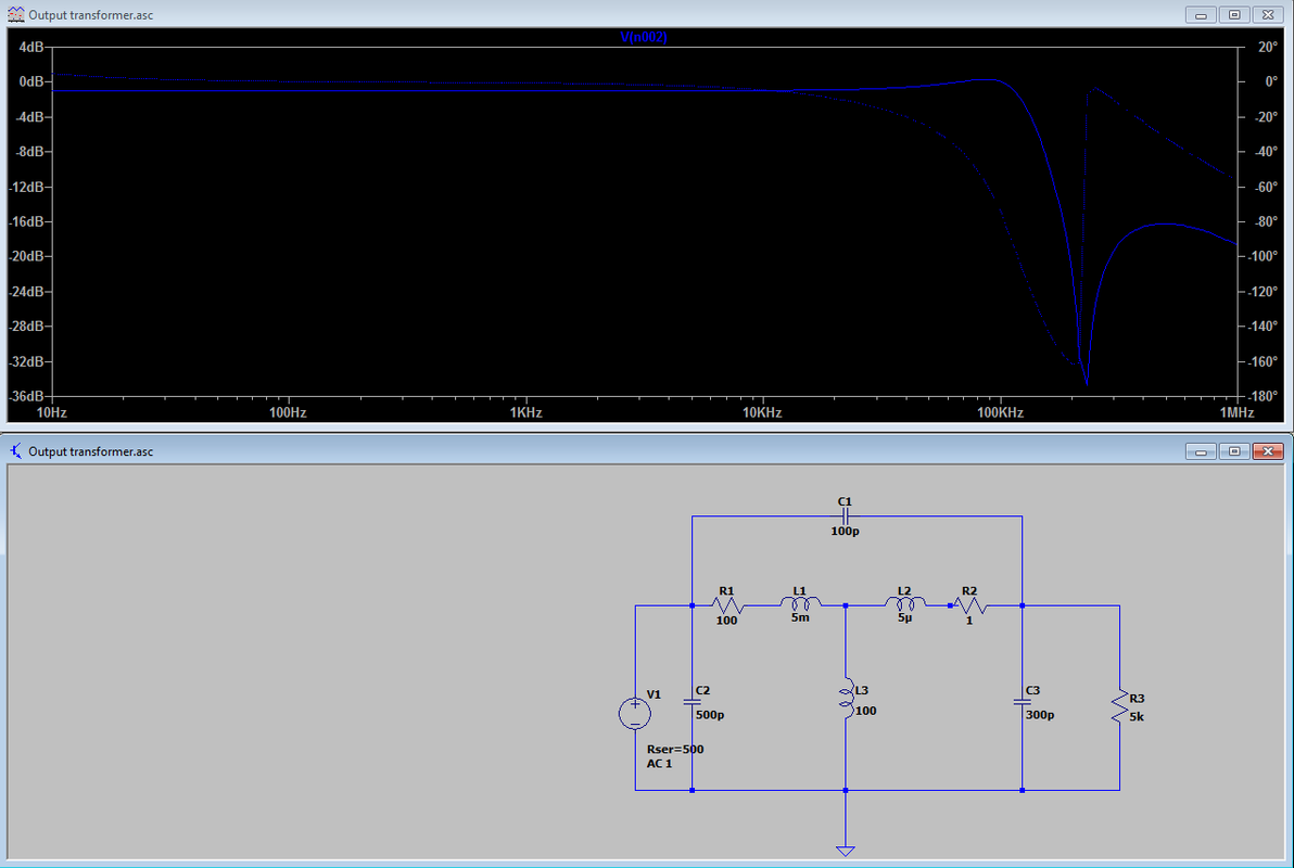

Thanks! The document you posted actually leaded me to even more valuable literature. I found "Wideband transformer models" by Chris Trask. The model model he published on his work makes a lot of sense actually.
The dipping capacitance can be seen as a result from a high C12 interwinding capacitance mixed with leakage primary and secondary
inductances.
Here is a SPICE sim with practical values.
inductances.
