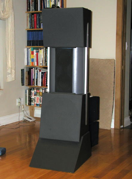

They look good either way! Nice design work. Could we see a rear shot of the "cabinet"?
Nielsio -

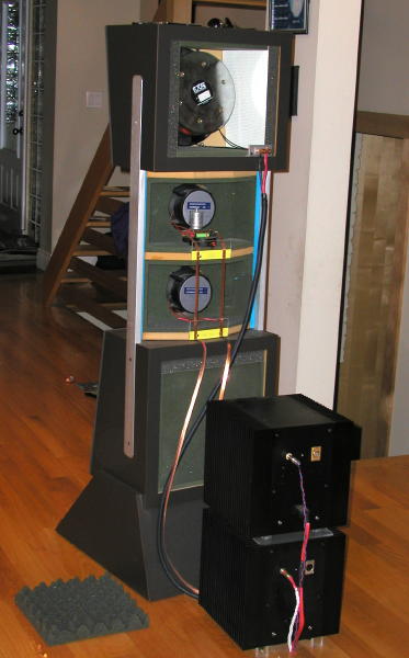

The plywood baffles were prototypes and now live in my garage (anyone in NYC area want them?). Here's a shot of the rig after the design was finalized and built.

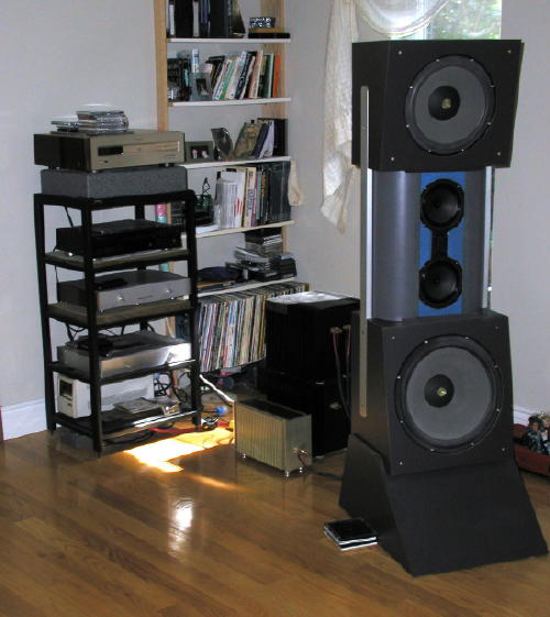

The PHY-HP has response up to ~9kHz, though I am no longer using it that high. PHY has a coax driver that does better.
Ribbons work well with open baffles because the cone drivers can better match the ribbon's transient response when evenly loaded, as they more or less are in an OB.
The woofers are 15" Lambda dipoles running on single coils for a qts around 1.5. Wrapped in the OB K-tube, they have outstanding transients.
Ah! That's what I recognized in them (seen pictures of them like that before, here).
How far down would you say your subs go?
