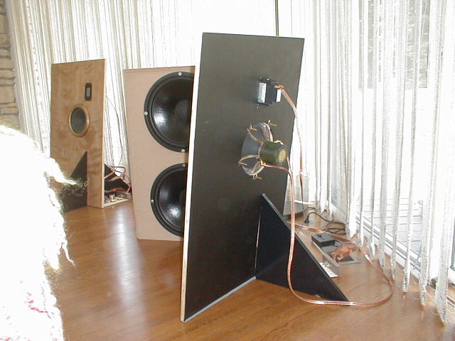

First off, major thanks to everyone who responded so far.
I'm starting to think that dipole may be the way to go for the L and R speakers at the least. It does look like maybe it's not the best way to go for the center speaker, since that's pretty much back right up against the rear wall.
The only major stumbling block may be the distance to the back wall. I can easily have about 2/3 meter to the back wall. 1 meter might not be too unreasonable. Does putting some sort of sound absorber or diffuser on the back wall seem like a reasonable idea?
I actually haven't seen anything saying they need ~1m or more behind them. Paul Spencer - where did you read this? Perhaps you could share a link with some further reading. I'm still reading through all of the linkwitz stuff - it's really great that he's written all of that down and shared it with everyone.
I think I can probably manage a ~.6 to 1.0 meter wide baffle with the space given. Looks like that should get me down to ~80 Hz or so without needing a boost (f=0.17v/D, right?). I imagine I can either xo to subs at that point, or boost a bit to get the mains down to 50 Hz or so and then xo to subs.
I think I'd prefer a flat baffle as opposed to the H pattern, as then I don't have to notch out the upper resonance. Right now I'm leaning towards all active crossovers. My reciever will XO to subs at anywhere between 50 and 100 Hz. From there I can split the mains with a 3-way active crossover (probably pro-sound equipment -- any suggestions?). Seems like active xo's avoid a major hassle in sorting out a decent passive xo, and will let me try different drivers easily w/o having to constantly re-work a passive xo. I have a fair number of adcom amps to use.
So current fuzzy concept for L and R speakers would be:
3-way
all active xo's
tweeter - not sure
mid - PHL 6.5" or 8"
woof - probably eminence 12, 15 or 18, high Q
I generally look for drivers with high BL / low Mms and high efficiency
baffle probably ~.8m on the bottom tapering up to ~.4m ? on the top
Any thoughts so far?
Going with an 18 for the woofer would probably allow me to try things out with a boosted lower response. I could then turn off the subs and be true dipole and compare all dipole vs. dipole from 50Hz up. I did play with the room responce calculator on FRD Consortium and found a sub location that gives a reasonable response w/o any nasty peaks or dips. So I think there's a decent chance I may be OK with monopole subs below 50 Hz.
Kuei Yang Wang -- that glass baffle is awesome! Not sure I want to attempt that with a 3-way though. Very nice.
- Robert

Kuei Yang Wang said:Well, design a dipole right (from the right materials) and the visual impact is small.
The glass idea is nice but it still occupies more space than a conventional speaker of comparable output, which was my point. For some this is not acceptable. I may well be building an open baffle with a glass baffle in the future, the transparency appeals and it mirrors the open baffle concept nicely.
Kuei Yang Wang said:Why? The basket and magnet of the driver by far protects the rear better than the plain open cone on the front....
A conventional speaker would have a grille on the front and the rest is box - nothing that attracts the attention of children as something to touch. Without a grille, a speaker is likely to be fascinating to children, they will want to get their hands on them. Even worse if they have scissors or a knife - you know what some kids are like!!! ... my ideal of the glass baffle with no grille on front or rear may be hard to realise ....
Kuei Yang Wang said:Is it? I didn't notice when I designed mine....
If you look at Linkwitz site and his description (if you haven't already) you will see that it's not for the faint of heart! Yes a simpler approach is possible, but it wouldn't be my preference.
Kuei Yang Wang said:How do you come up with that particular delusion?
It isn't a delusion. Please be respectful of my views.
Granted, OB can be done without active filters. Implicit in my statement but not explicitly stated were a number of goals along similar lines as Linkwitz which make active filters virtually essential.
regards,
Paul
Konnichiwa,
This is less critical than you think, as you can see with the placement of my own speakers. You can get awa y with less than 1m distance.
A baffle of around 0.8m X 0.6m will show a -3db point in the 50Hz region, based on the Math present by Backmann in his AES Paper. Placing the baffle on the floor (with no or only a minimal carpet filled gap) will add the floor image boosting the LF SPL by around 6db for frequencies starting (+3db) at a frequency with a wavelength around 4 times the distance to the floor - so with 35cm driver distance to the floor you get around 250Hz as the point belkow which the floor boost becomes noticable.
I use a main driver (8" Fullrange) with Qt = 0.8 and Fs = 50Hz and cross over at 50Hz to my (sealed box) subwoofer. Even without subwoofers the speakers sound fine, broadly in line with a decent standmounting 6.5" 2Way speaker for general LF performance.
Absolutely agreed.
Get (a) digital one, like the Behringer DCX2496, modify this (Op-Amp's, Capacitors and added PSU filtering) and then build decent Chip-Amp's (say LM3875 Bridged for MF and Treble plus LM3886 Bridge/Parallel for the Woofer - select 4 Ohm or lower Z woofer).
With a digital X-Over you can easily eqaulise drivers etc in addition to the X-Over function.
My choice would be likely Aurum Cantus R2S ribbon.
Use the 6.5" that is development on from the AUdax PR170M0 (ask Andre Perrrault - he will know), perhaps 2 of these in a MTM with the ribbon?
Have a look at the Eminence Kappa 18 - we used this one quite succesfully in a dipole woofer.
Thanks, it's based on ideas from this speaker
http://www.dietiker-humbel.ch/micromag.htm
I use the Supravox 215 Siganture Bicone Driver, giving around 50Hz-18KHz on this open baffle, 96db/2.83V/1m and an easy 8 Ohm nominal load.
Sayonara

batdorf9 said:Kuei Yang Wang -- that glass baffle is awesome!

I used 15mm Acrylic, cut and finished (including speaker holes) by the Plastics Supplier (they supply vaious clear plastics for windows and the like) for < $ 100 per baffle, the L-Piece is "natural" stainless steel, < $ 50 for the Metalworks company per piece but agonising long wait.
I'd suggest you use a suitably large "Midrange" (consider the Supravox 215 Signature without whizzer) and a 100Hz X-over point, where you can then put the woofers into a compact folded baffle and where the baffle can be a little smaller. You choose how and where to place the ribbon.
And yes, my wife likes my new speakers VERY MUCH, she polishes them up (she never went near my big Tannoys.... ;-) ) and she and I like the sound as least as much as the looks.

I showed the glass baffle speaker pic to my girlfriend and she's now convinced that this is what I should make. 😱 she'll probably be pretty bummed when she sees the ugly prototype monstrosities that get created. perhaps a lexan baffle might be easier to build?
