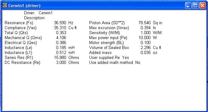

Okay,
I got them out.
They are Cerwin Vega! Re30 Series speakers, including a 12" woofer (gotta love the exclamation point). I've done some initial measurements, with the results posted in the attached picture.
The problem is that I have absolutely no initial parameters. I haven't the foggiest notion how to measure Qts by myself, and I'm a little under-confident with the Vas measurements. All measurements were done with the Wallin Jig II and Speaker Workshop (oh! what a treasure!).
Oh, and DC Res is 3.0
Any help?
Thanks,
Dave
I got them out.
Any help?
Thanks,
Dave
Try to measure most parameters by yourself if you can...
http://www.diysubwoofers.org/measure.htm
You'll need your computer with a tone generator, a multimeter, a 5W resistor of 4 or 8 ohms and an amplifier.
