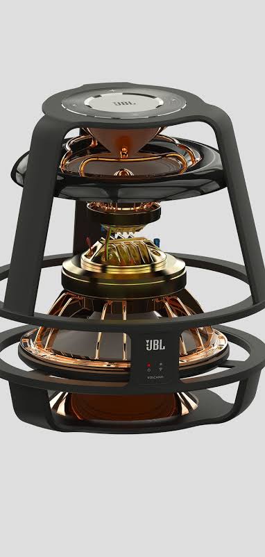

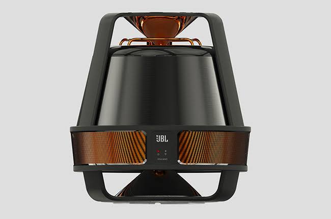

@goodguys Can you show us the actual picture of the speakers. Otherwise there will be lots of misinterpretation. If you like diffused sound field look at some omnidirectional speakers, like jbl volcano types or some linkwitz designs.
