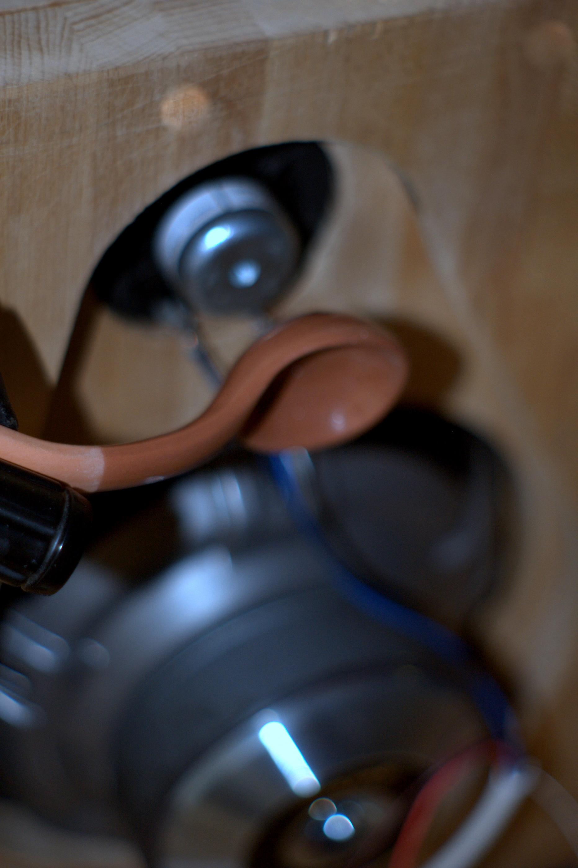

LOL, and why not pumice??? It's hard, dense and can be honed to various shapes. It also has those nice holes which may add surface area as a diffuser. To date I have tried a stryofoam cone, a baseball hack sawed in half, a tennis ball half, and my personal favorite, a ceramic serving spoon. The spoon (convex side toward the driver back) seems to have the perfect dimensions and is being held in place by a gooseneck. The gooseneck microphone boom has the added advantage of being able to angle the curve and experiment with reflections. The baffle is now infinately more usable at close distance to the rear wall.

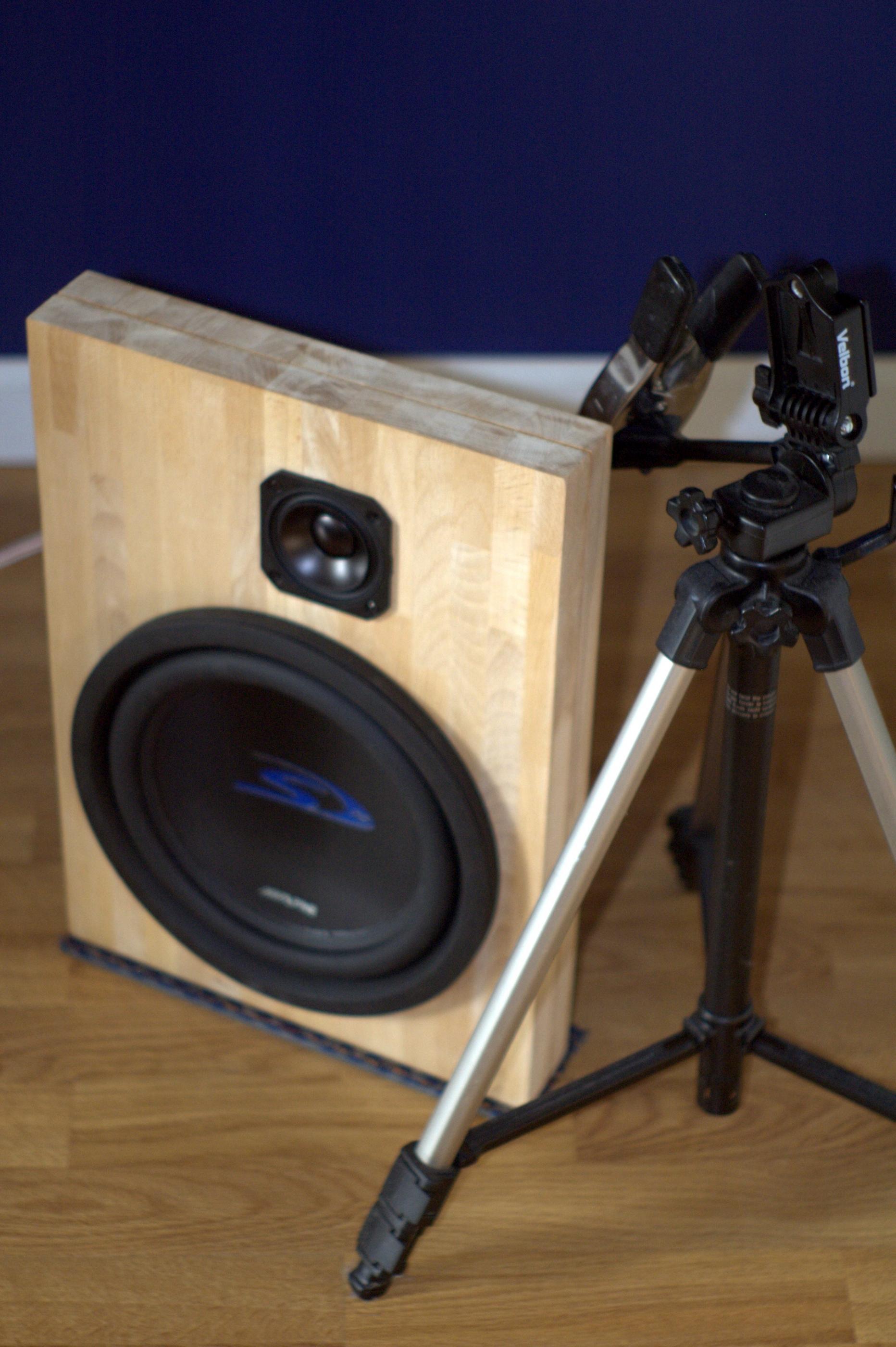

Have you got a picture from your serving spoon
arrangement ?
Oliver,
Sorry about the picture quality but you can get an idea how the convex shape of the spoon diffuses the frequencies from the full range driver.
The tripod and alligator clamp was the rig i used to test various materials placed behind the 3" driver, with varying outcomes.
