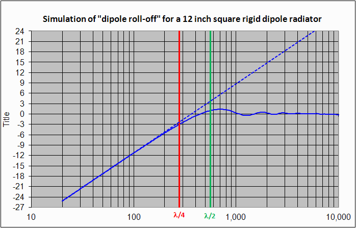

This plot shows the simulated response of a 12" square rigid dipole radiator.
Solid blue line ignores beaming, dashed blue line includes beaming.
NOTE: if you placed the 12" square radiator in an infinite baffle, or wall, the response would be flat up to about lambda/2 since there would be no dipole cancellation.
Above lambda/2 the response would transition to the dashed blue line as the radiator still beams.

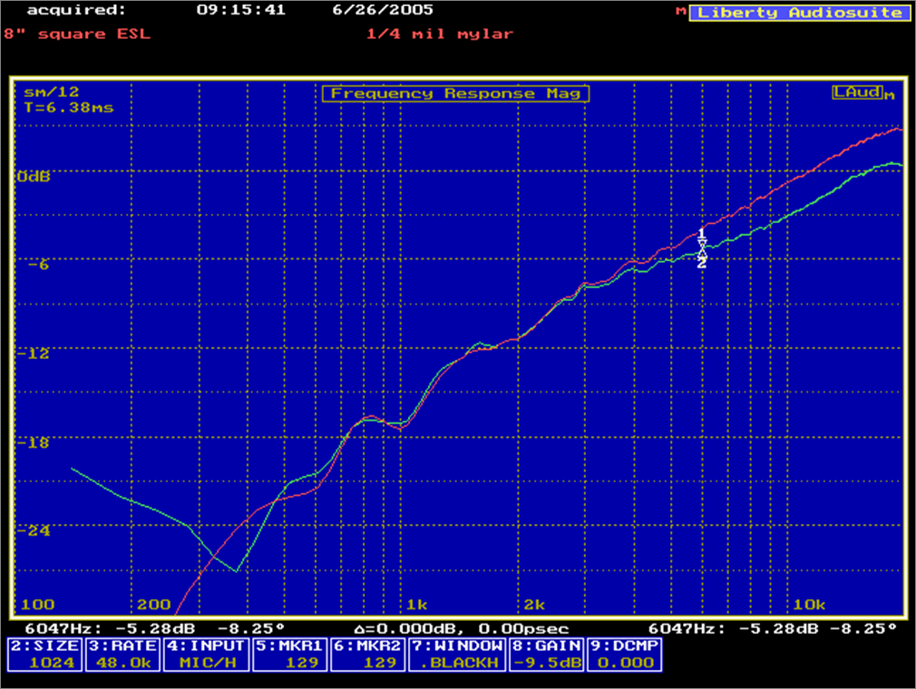

Some measurements I took several years ago of an 8" square ESL.
The Red curve is on axis...note near constant slope throught the whole response.
I took measurements of this same ESL in an infinite baffle to verify the NOTE above, but can't seem to locate it right now.
