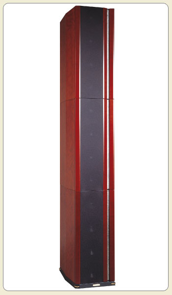

Hi Magnus,
Only your ears can provide the final dipole vs. monopole answer, but you can avoid mistakes and do-overs if you can find local audio stores or friends that have dipole line sources like Magnepan or Apogee, mixed monopole bass and dipole ribbon tweeter like DALI MegaLine, monopole bass and planars like VMPS or kits that follow Jim Griffin's line array design rules. The easiest DIY might be copying a well reviewed closed box Jim Griffin line array design using planar tweeters.
http://www.audiocircle.com/circles/index.php?board=127.0
http://www.audioroundtable.com/misc/nflawp.pdf
http://audioroundtable.com/ArraySpeakers/
If you DIY a monopole ribbon tweeter, you will need to have extensive rear sound absorption material to keep the rear waves from reflecting back upon the ribbon foil..
If you DIY a dipole ribbon tweeter, a full 3-way dipole line array design would match the best products.
