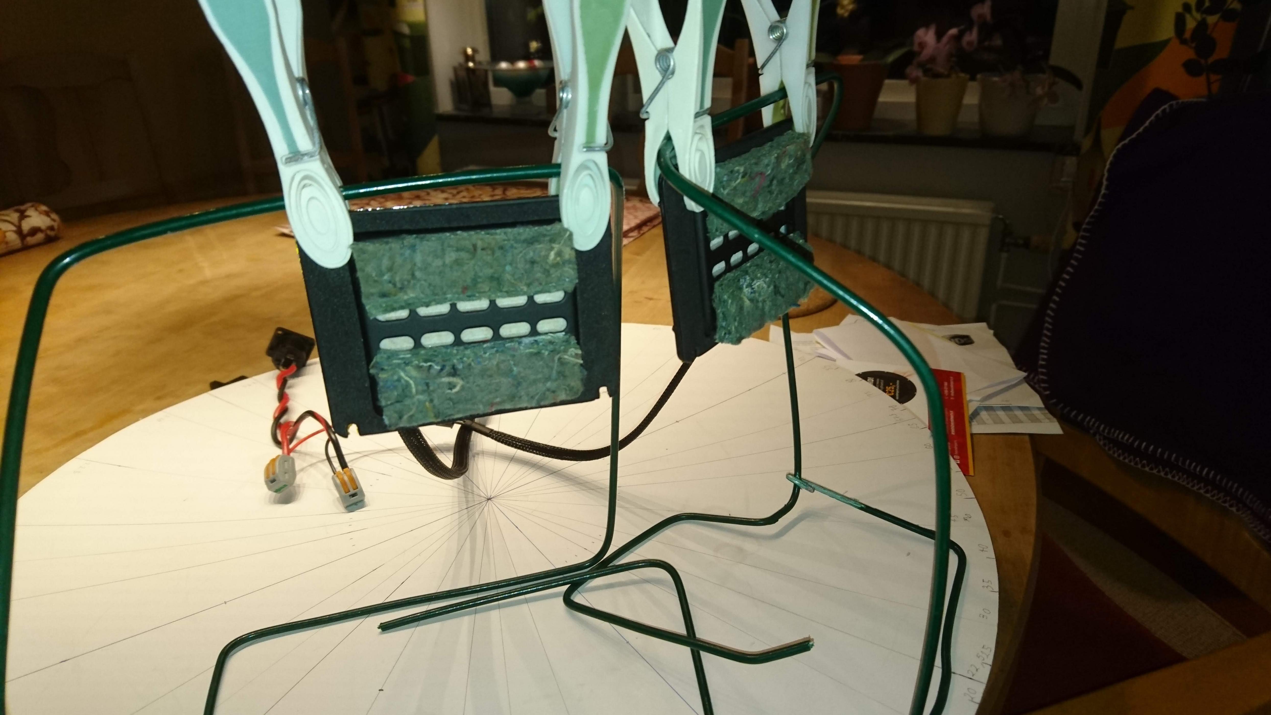

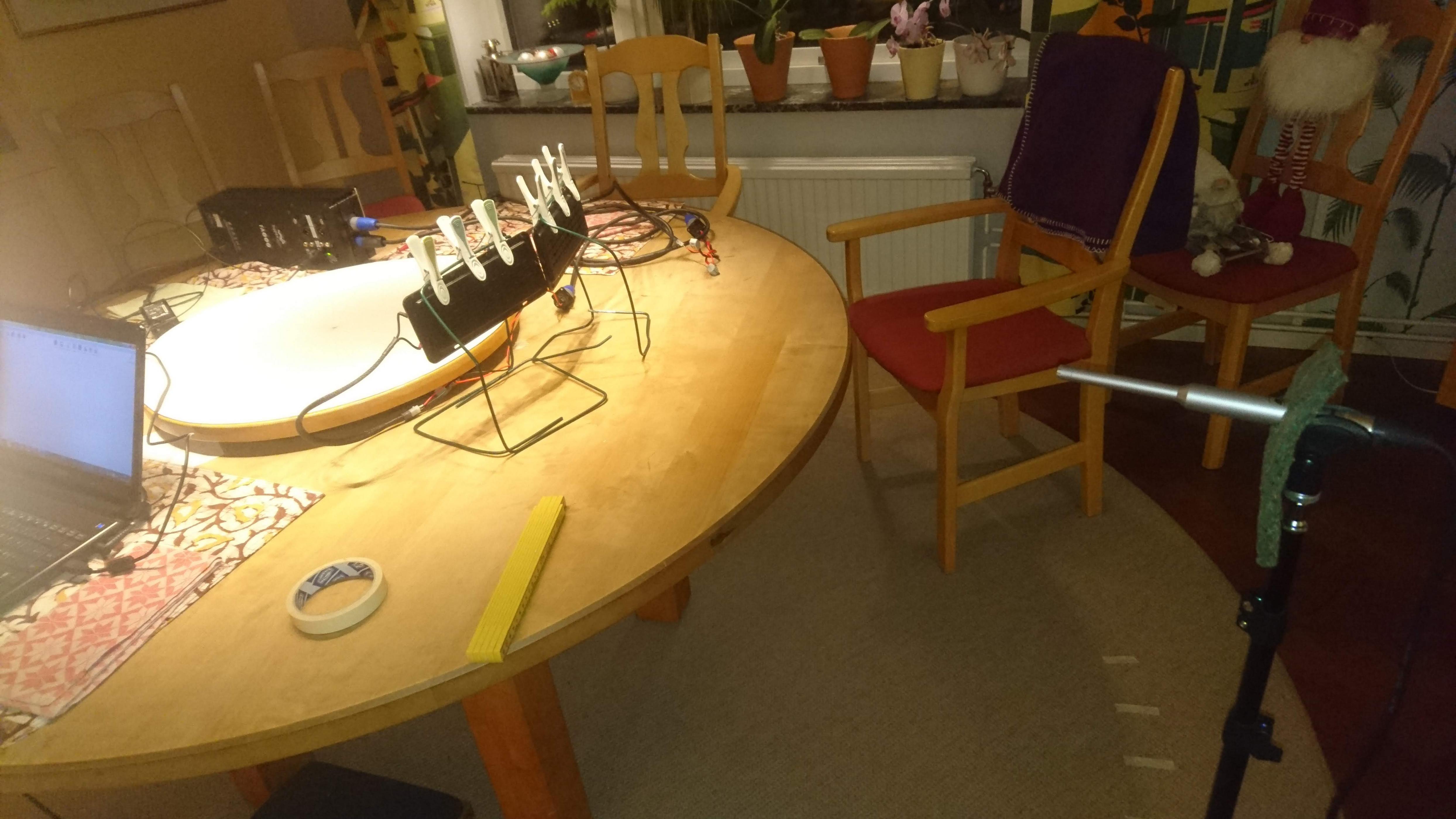

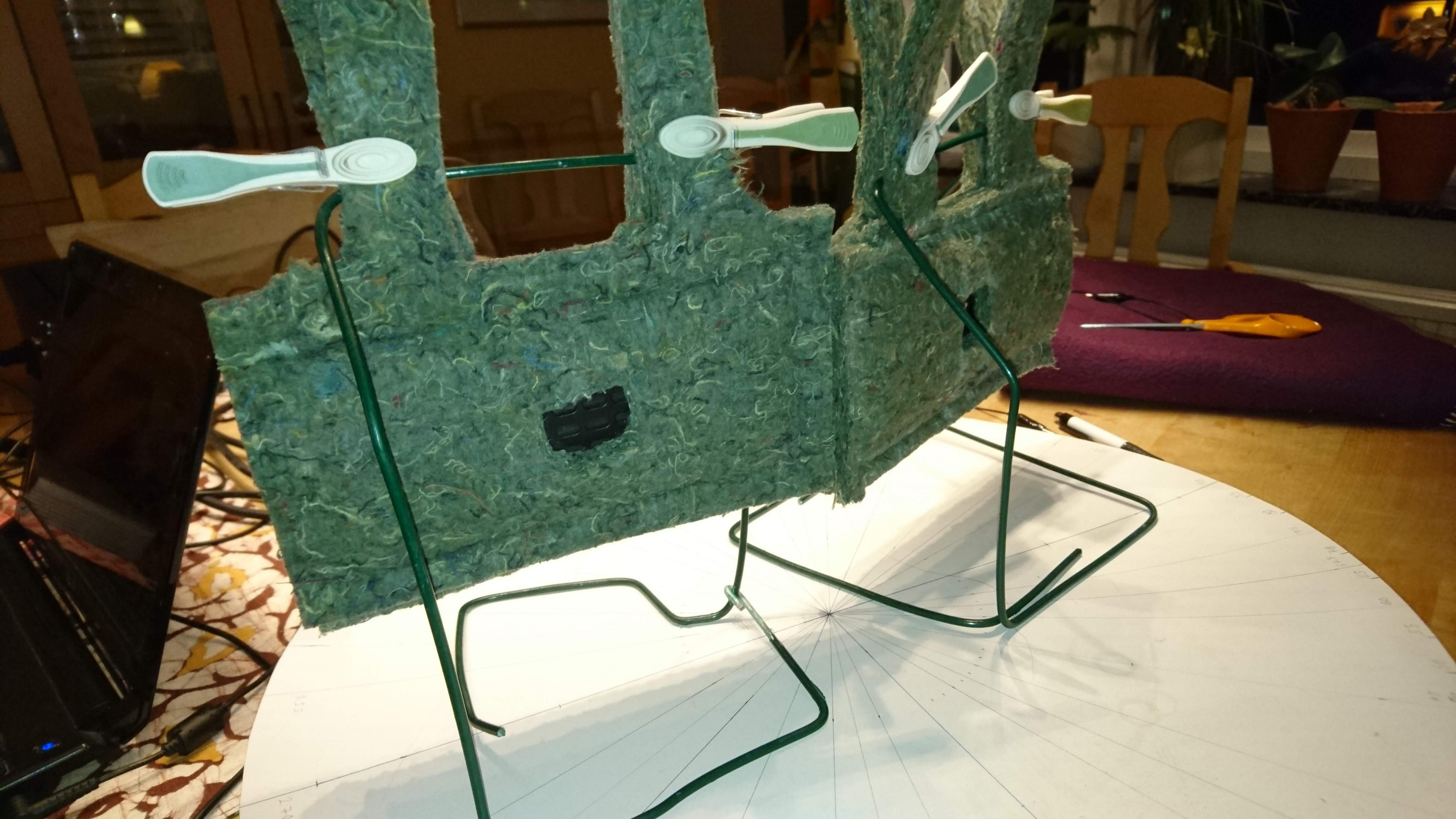

A Mini-CBT vertical array of Neo3 tweeters, more specifically Mini as in 5 drivers in a non ground plane 90 degree arc. The 0 degrees in the measurement is in the center of both, and then in 5 degree increments to the right. The idea is just to see how good the transition from driver to driver is.
This experiment is only with two drivers, one at full power and the other at -2 dB. (cosine CBT function). This would be the vertical dispersion, however, and I'm suprised it measured so well. Without the -2 dB shading it was awful but with it it measures beautifully. As you can see in the picture the tweeters aren't even that close to each other, but it still measures that good.
Next step is to try a full array with 5 tweeters. My spreadsheet says that they should be at the following angles and corresponding shading:
34 cm radius, drivers 10 cm spaced apart to give me some headroom in the construction.

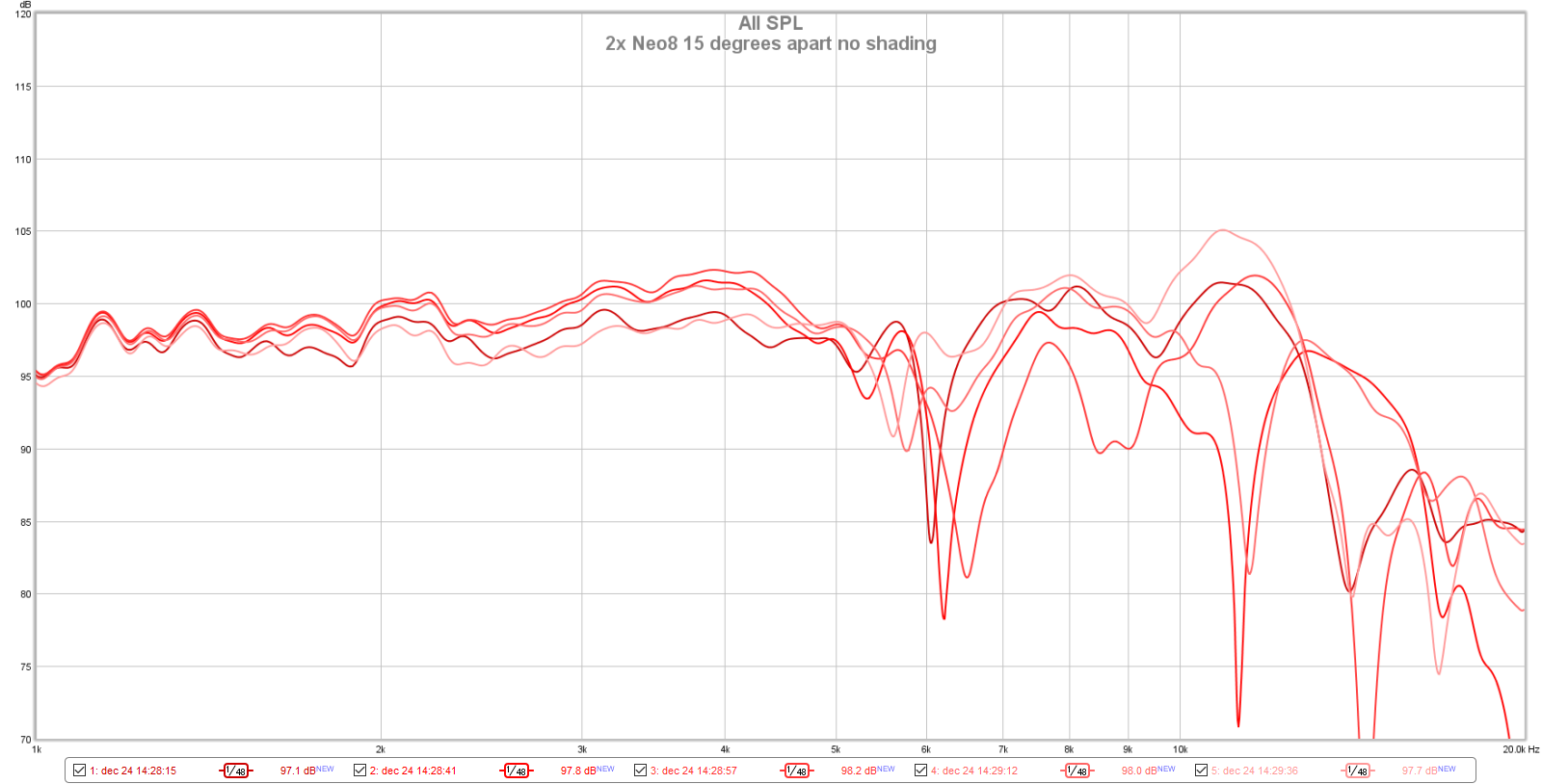

I actually did try with Neo8 first:
It didn't work at all, that was before I tested shading so might be worth revisiting to see if it fixes things. Especially considering that the Neo3 measured like garbage before shading too.

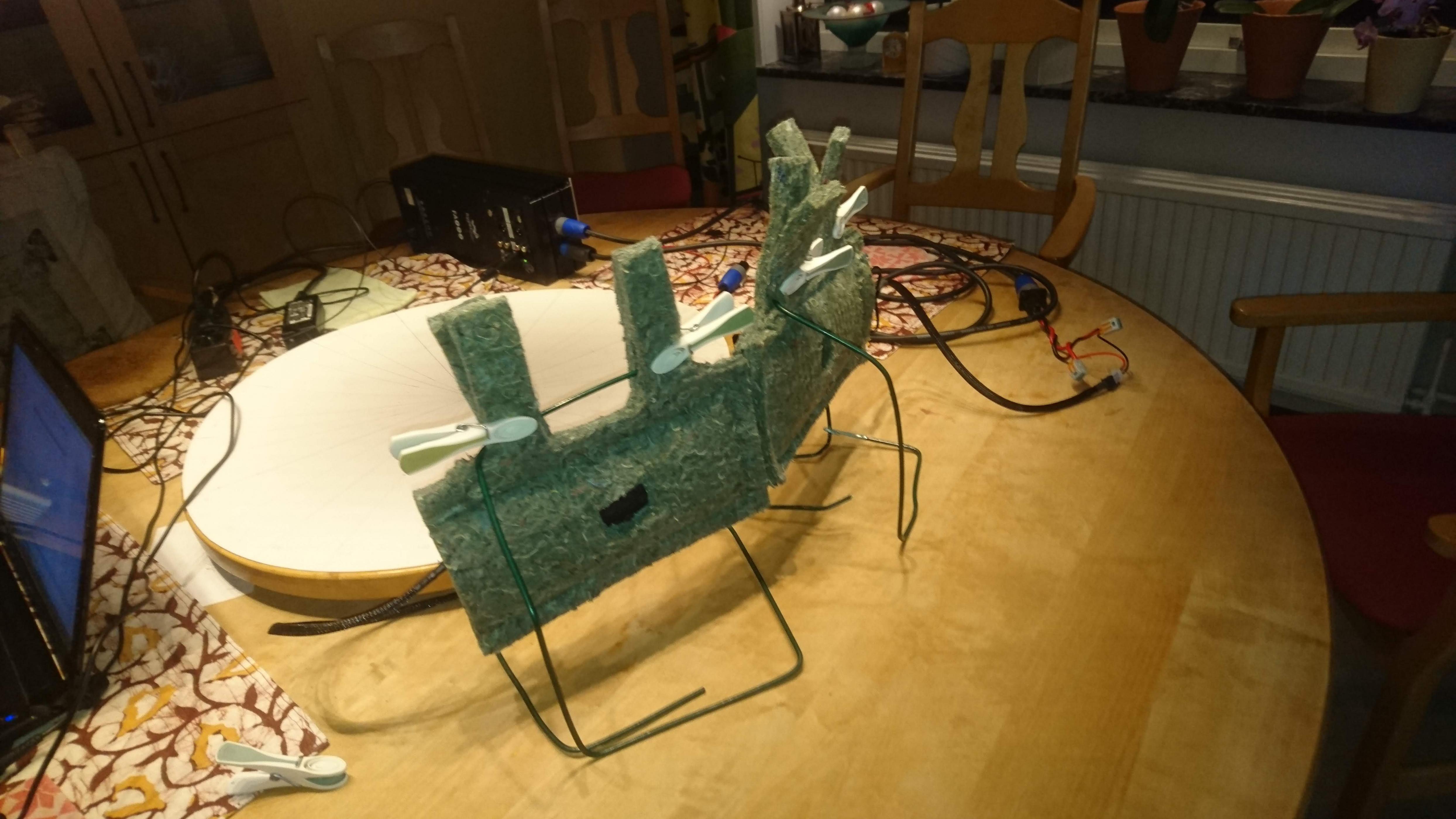

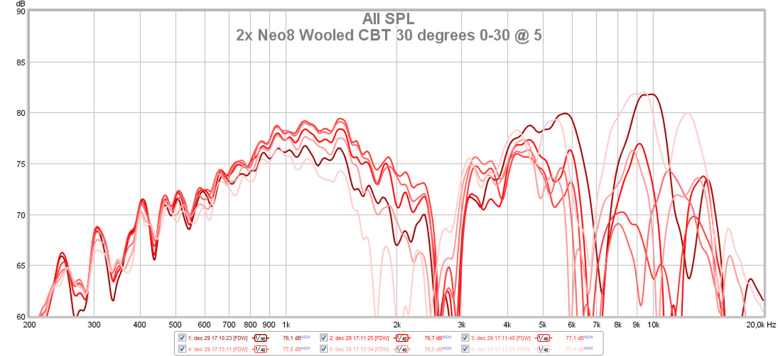

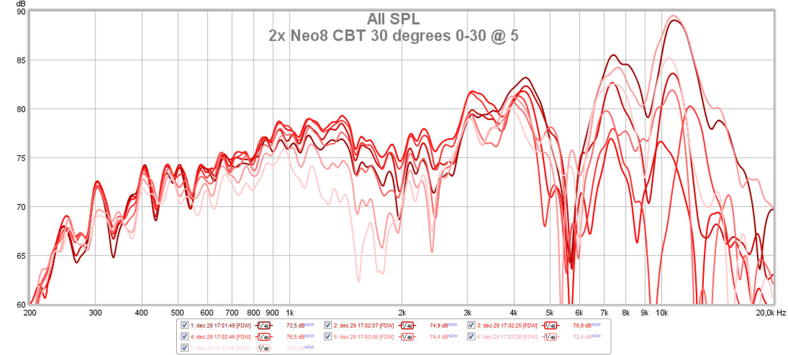

I'm not sure it would work, or at least not in the traditional CBT shading way. My measurements are in the vertical plane and only in between the drivers, so to extend it to say +- 75 degrees you would need more drivers. The vertical dispersion of the Neo8 is not the same as that of the Neo3 so you want to cross low. I crossed at around 2.2 khz on my earlier speaker.
If I add wool and make a semi PDR Neo8 then I can get the horizontal dispersion great all the way to 15 khz so usable without a tweeter, if not for the pitiful vertical dispersion.
And in my experiments to CBT the Neo8 the results aren't as smooth as the Neo3 test:
Those experiments are with 37cm radius, -1.3 dB shading.

I believe you'll get better polars if you add some shallow fins, like Follgott did in the project above.
Basically you don't want the "fins" to extend very far, just enough to keep the radiation from the NEO3's apertures from interfering with each other.
See : Line array prototype (with waveguide and CBT shading)
Sure but then the speaker becomes huge =)
I'll also get problems crossing the midwoofer to the Neo3 array, ideally I want the midwoofers to be beside the neo3 array. I tried such a configuration with a waveguide around the neo3 but the bigger dipole baffle started making the response much uglier than minimalistic baffle. I could solve it by going even bigger but I want a non huge speaker.
Also the plot in #1 is the vertical dispersion with 2 drivers, which if it extends to +- 90 degrees with 5-7 drivers is already good enough.
