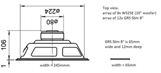

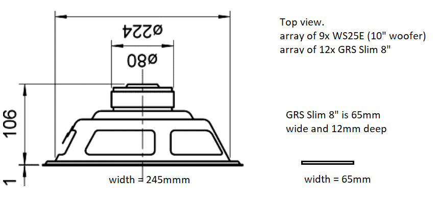

I have been thinking how to arrange the arrays to each other to obtain the “best results”. One consideration is the gap (distance) between the woofer and slim array: higher value would probably be better to let either array operate without influence from the others array “baffle”, OTOH the distance should be low thinking about the “ideally less than ¼ of wavelength” distance between drivers.
The other consideration is alignment of the acoustic output, for time (or phase) alignment of the drivers. It can be expected that, seen from the top, the slims will have to be shifted back for best time alignment. But that would put the woofers in the way of the dipole radiation of the slims, which I do not think is a good idea. So maybe mount the slims aligned with the front of the woofers and add the delay in the crossover, like shown in the picture?
I will have a wooden plate attached to the ceiling and will be able to shift the drivers in an area of about 360 (wide) x 200mm (deep), so there will be some experimenting on its way. Still, very curious about your opinions!

To me your ideas above seem reasonable, but you are getting close to uncharted waters and will likely need to experiment a good bit. While some of what you are doing is known, how all the elements influence each other and the room is much harder to predict. I'm not sure about using the drivers without any baffles, your bass losses on OB are bad enough with a baffle, with none at all won't you just get mids?

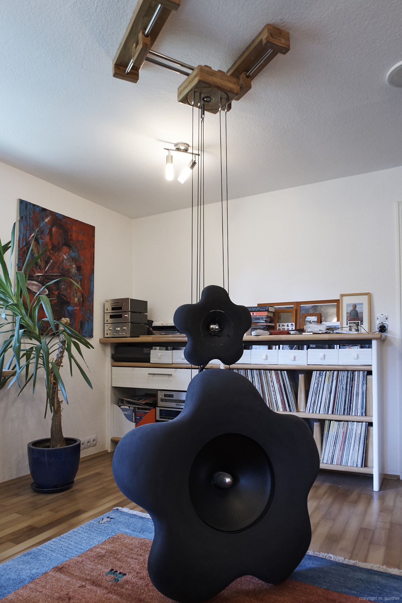

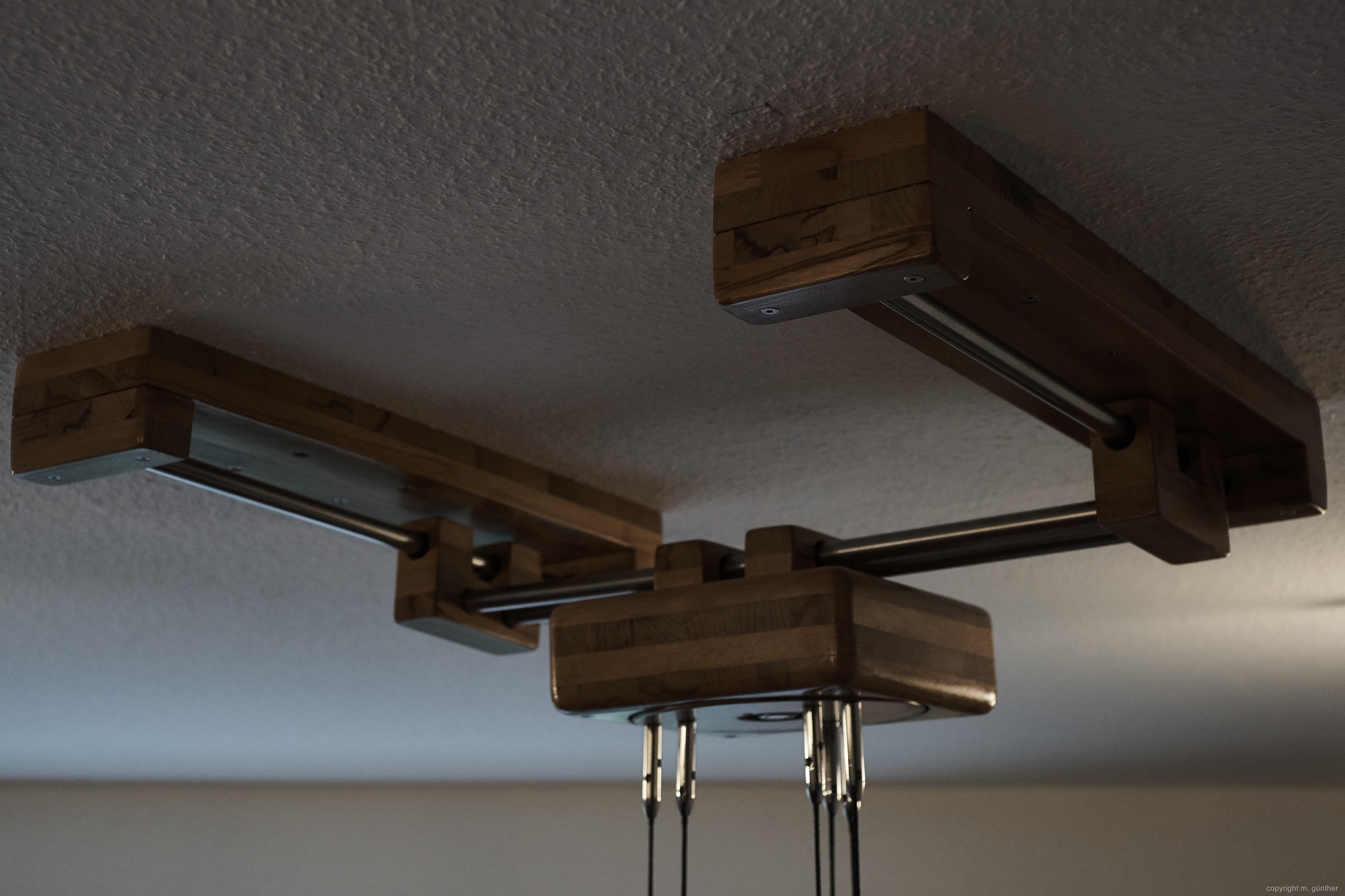

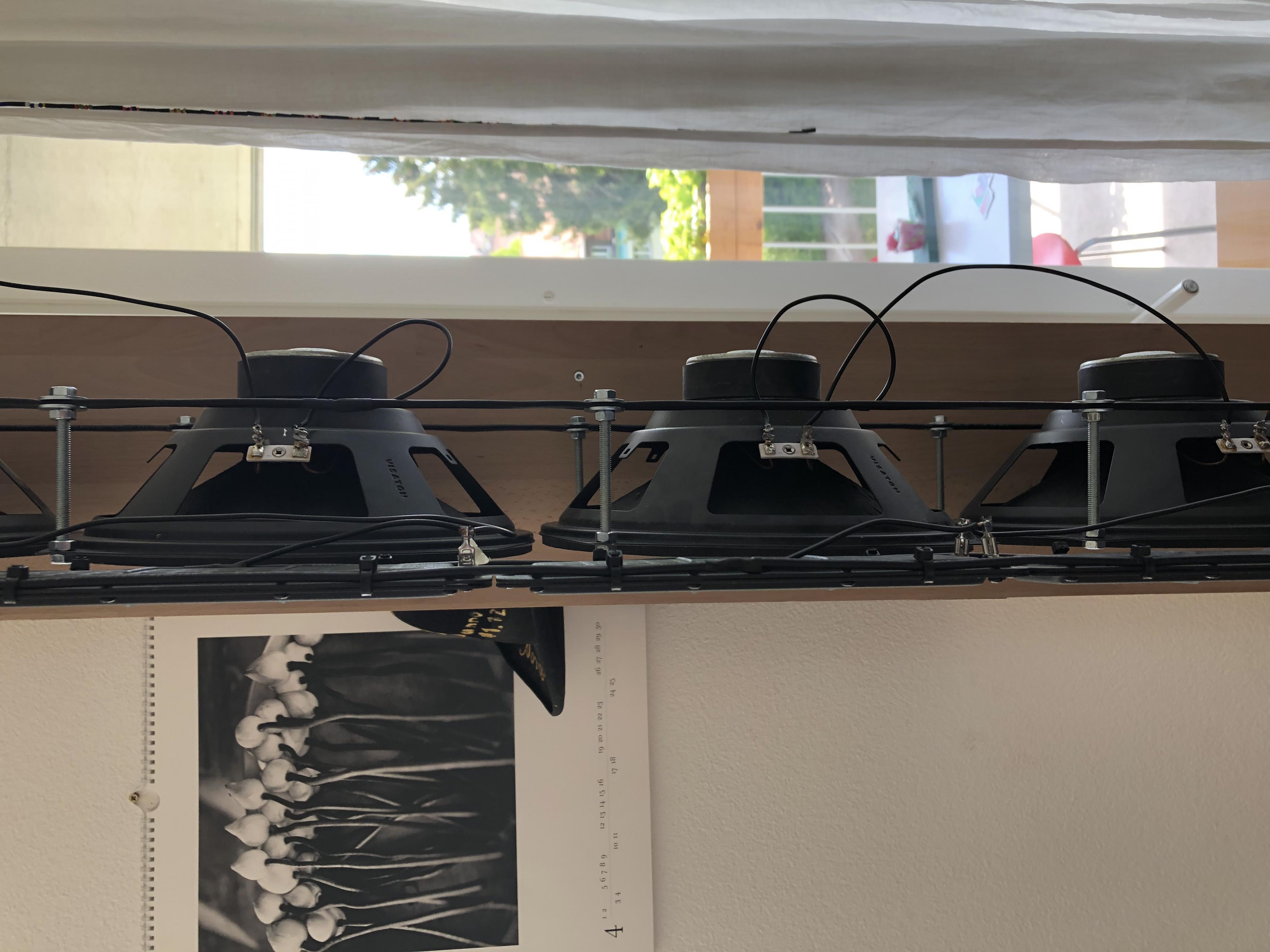

I´m not sure if it is helpful, but as I´m flying my black flowers from the (well reinforced) ceiling as well, please find 2 photos of my mounting device attached, which allows for shifting positions and adjusting angles. Maybe it´s good for some inspiration.
Another issue is the ratio between moving mass of the bass drivers versus physical mass, which led me to added weight at the woofers motor. I ended up around 1:250 and found that quite a bit better than around 1:120 I had before, bass was more precise and clear, even better located in space. Just a thought...
Mattes... fascinating build. Is there a thread where you discuss performance?
I am no speaker expert, but it seems you have incorporated many good concepts here.

Hope Erik don´t mind too much if I answer you in his thread: The Black Flowers have been shown in the ultimate baffle gallery, and there was a little bit of discussion, but I never opened a thread for them.
They are not active, I prefer passive crossovers. Despite this, low octaves are there, in-room response is fine into the middle 20´s.

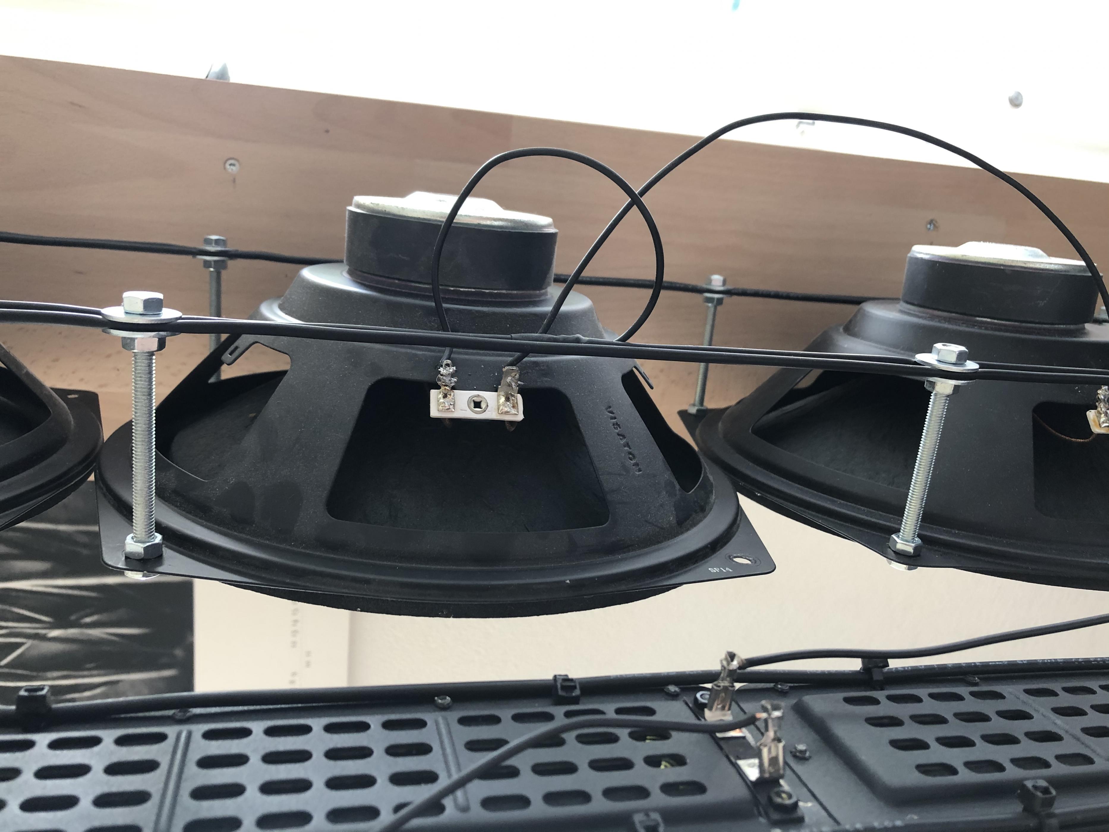

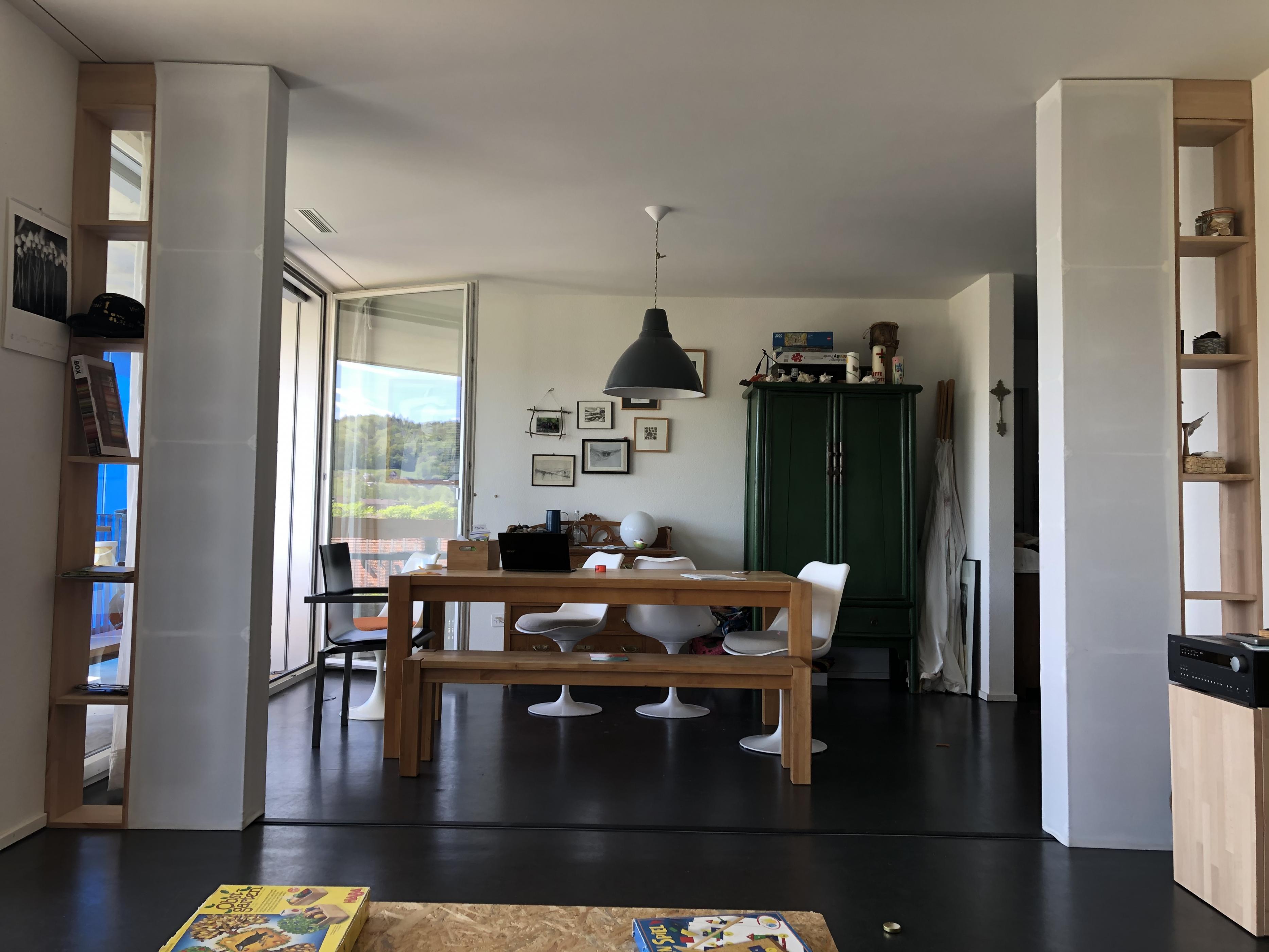

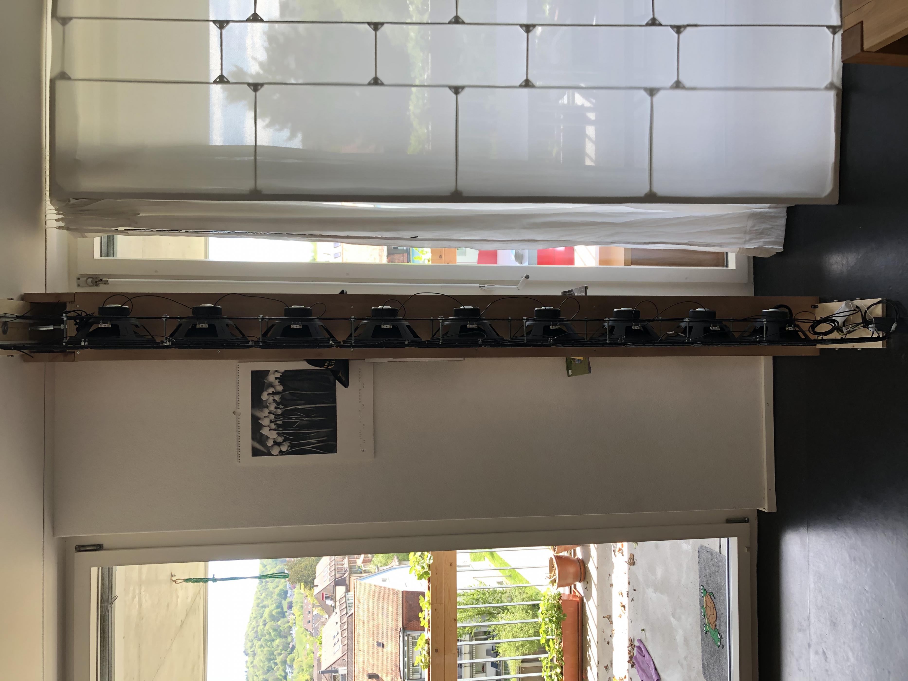

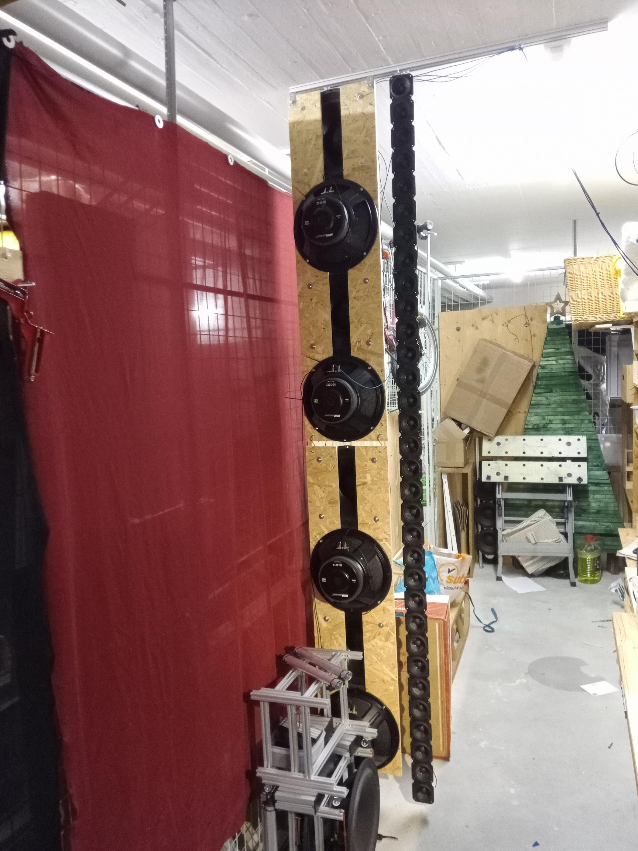

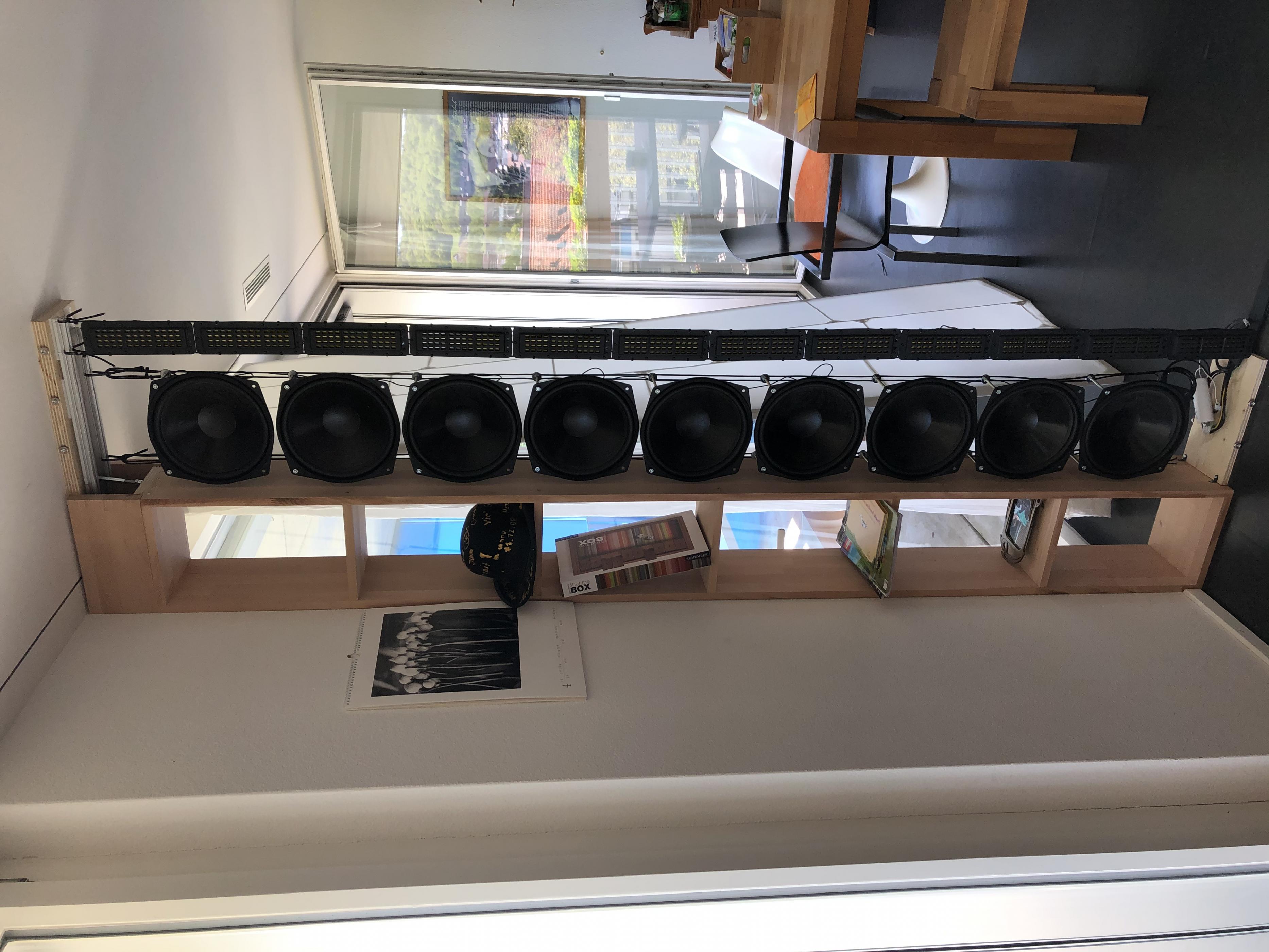

I “finished” the speakers in mid January and doing the fine tuning since then.
They are at about 40% of the room (like a room divider). The shelves are 23cm wide and 20cm deep. My wife liked the idea of the shelves, and I think they are indeed good to allow the space for the figure of 8 to be formed (at least theoretically). The overall construction is about 56 cm wide, 250cm high.
The 12 slims are connected in groups of 4 in series, and these in parallel, for about 8 ohm load. The 8 ohm woofers are connected three in series, and then in parallel, for 8 ohms. Theoretically there is space for a 10th woofer, but that would make for a weird impedance. No shading is applied.

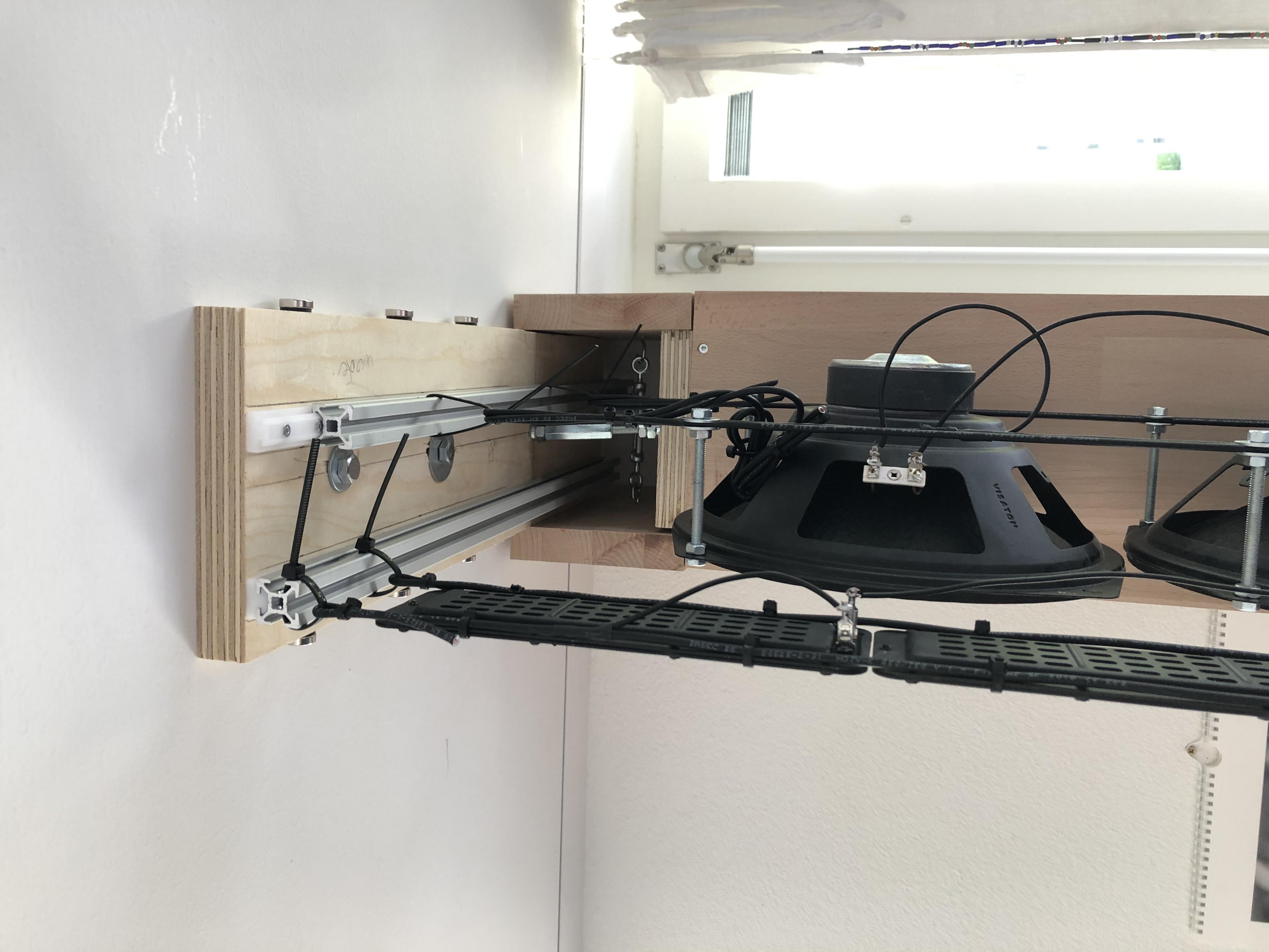

I am using 2.5mm2 stranded wire to both hang the speakers and feed the music signal. The Slims are attached with tie wraps, the woofers with rod ends.
The speaker cloth is stretched on a frame based on 2020 aluminum extrusion profiles, m6 rods, some 3D printed parts and a lot of tie wraps. It can be taken away relatively easily, also the speakers are hung from some rails, so that for “serious listening” I could move them farther from the shelve part, theoretically becoming “more naked” and better dipole behavior. I haven’t actually done it yet.
The initial xover was with a miniDSP, but since replaced with an analog xover that applies 600Hz 24dB LP on the woofers and 12dB HP on the mids. A protection cap does another 6dB and the dipole rolloff does the other 6dB, for a theoretical total of 24dB. I apply some equalization in the the moode audio player. This part is very much in progress… an Arcam multichannel receiver is used for powering everything. One of the first measurements is attached.
Things I am thinking about:
I used the WS25e woofers because I already had 12 of them and they are actually used in a couple of dipole projects. From about 35Hz they play well with enough SPL, but that leaves almost a whole octave with lacking SPL. Adding woofers arrays is not possible, so I am thinking about two possibilities:
- I still have some 12inch dipole woofers (SB34NR75-16) that I am thinking of putting into a (mono) H frame subwoofer to play the lower octaves (maybe up to 60Hz), extending the range and taking some of the burden from the WS25e, but where to put this box in my room…? I will start by doing some sort of baffleless experiments with these SB’s to see how they integrate with the WS25e
- Replace the WS25e with the 26W/8534G00 https://www.scan-speak.dk/datasheet/pdf/26w-8534g00.pdf This woofer has a FS of 23Hz, and is used by daudio.nl in their C1 speaker. Would cost some 2000 euros to replace all 18 units, and a lot of work, so reluctant.
- Also looking forward to see how these play with tube amplifiers, another subject I like a lot!
For the moment I do like them a lot! Currently I am mostly in the mood for some jazz and world music (ala Anouar Brahem), so I can live well without the bass. I like the soundstage a lot, even at low volumes everything stays into place, and there is no perceived distortion at higher SPL levels. I must admit that I do not have much reference in the current room, so I will probably see if I can borrow a pair of speakers to do some direct comparison.
