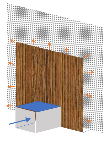

dipole H-frame subwoofer using wall to form rear tunnel
Interesting idea. It should work. Just i think you have to decouple that big baffle from the driver. Such big area baffle will be prone to vibration.
It's dawning on me that while it might work, it will have to be a one-off permanent installation and the planar baffle needs to have some good mass and rigidity. Also, how to measure and tune/EQ it in-room?
I'm not sure I will actually build it, and I am looking into other options that will be smaller/easier/cheaper to build. For example, I already have a 36" L H-frame that I could easily convert into a U-frame or offset H-frame to obtain less dipole cancellation and more LF output. Or I could supersize the driver. I am currently using an 18" driver but the H-frame can accommodate up to a 24" monster like the Stereo Integrity IB-24.

So i see two options here.
First:
Do dipole with big two drivers in w shape arrangement.Connect them together with some rods so force cancelation will be perfect. Thats rock solid approach. No vibrations at large displacement. You can do U shape baffle with this approach.
Second:
Place two monopole subs with large distance between them and use them as dipole with large separation.Sit somewhere but not at dipole null🙂 You can sit close to one off them so SPL will be more than enough🙂
If you increase the pathlengts between front and back with x2 you get 6dBgain.
So that tunnel may well give you 3dB.
Pathlength is WERY important if you want SPL at low frequency.
