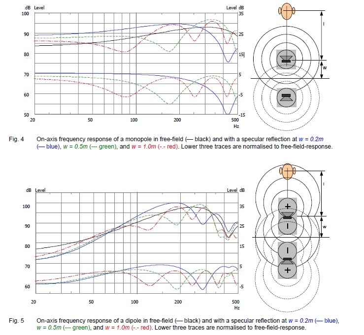

I don't think I misunderstood anything and I am aware that there is a complex interference pattern and also room modes, but we're talking about a primary strong reflection off the wall at a short distance, which makes it very strong.
Precisely because the monopole backwave is in-phase (while the dipole is 180 out of phase), you have:
- for dipole: you get a first and strongest peak at the 4 x distance_to_wall wavelength (the back wave travels 1/2 wavelength to the wall and back and adds in phase to the front wave)
- for monopole, you get a dip at 4 x distance_to_wall wavelength (the "back" wave travels 1/2 wavelength to the wall and back and adds out of phase to the front wave)
Sure, this is all superimposed to the other peaks and dips of the complex interference pattern plus room modes, but with a strong reflection those first peaks/dips are very dominant.
I don't see why you get less reflection at low frequencies. You probably mean you excite less room modes, which is a different story.
This is the picture off the back wall reflection.The pattern is the same only peaks and dips are shifted. Response is never as in free space. Need equalization.In example at 20hz monopole adds 6db(simulation model) and dipole subtracts 6db
Less reflections from side walls(actually floor and ceiling as well) that's why you excite less room modes. You inject less energy.Sum power response is less with dipole for the same on axis spl(at low frequencies). Less energy in, less reaction out.
