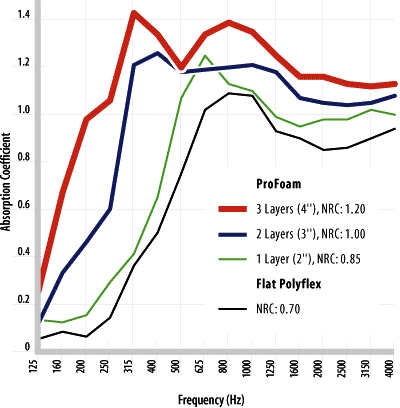

Here is another idea. Put a sound absorber behind the dipole speaker. You want very little absorption below 100 Hz, but significant attenuation at the frequencies where the first 'diple dip' occurs. This should smooth out the upper end a bit, but still retain the advantage of the dipole topology at lower frequencies.
