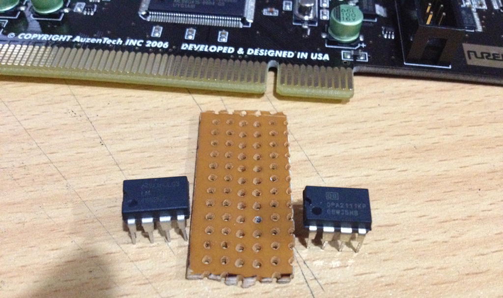

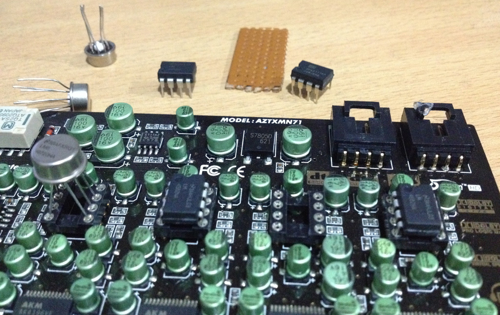

I beg your pardon to all member of this thread. i am very much novice electronics hobbyist! i can't figure it out. I want to use my PC sound card Center/buss Chanel with a Dual mono OP AMP.
Resource:
1. Auzen X-meridian Sound card.
2. LM4562NA & OPA2111kp OP AMP.
3. veroboard.
I NEED a schematic to make DIP8 MONO TO DIP8 Single Adapter with LM4562+OPA211KP.

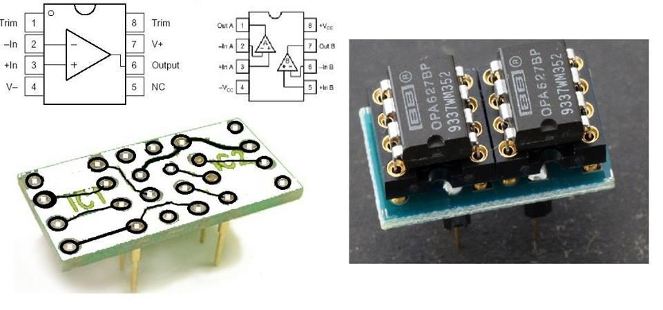

All you need to do is map the power pins and in+, in-, and output of ONE of the op amps in the dual package to the standard pins of a single op amp (use NE5534 pinout for reference).
dual op amp pin 1 -> socket pin 6 (output)
dual op amp pin 2 -> socket pin 2 (in-)
dual op amp pin 3 -> socket pin 3 (in+)
dual op amp pin 4 -> socket pin 4 (V-)
dual op amp pin 8 -> socket pin 7 (V+)

Need to build a PCB from this prototype
Why on Earth would you make such an adapter?
Instead of using 2 single Op Amps (think TL071 for example) , use the dual version (in that case TL072) and call it a day.
Unless you want to use a "superior", "NASA approved" single exotic Op Amp which does not have a dual version (yet).
Believe me, being as is a part of a PC soundcard, where 99% of the Audio processing is digital, "improving" the humble Op Amp which lives there, and which probably is not more than a buffer or a low gain stage, will not change sound at all.

My main objective is watching Home Cinema with 5.1 DTS and Dolby Format.
There are lots of good opamps that don't have a dual version - LT1028, LME49990, OPA627, OPA827, AD797B, etc. People use these all the time for upgrades, using a Brown Dog or similar adapter that allows plugging 2 single opamps into a dual opamp socket.
