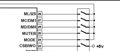

Hi, firstly I apologise for being so thick! I am trying to experiment with dac chips. I am using this site
DAC Final
as a guide for construction techniques :just to learn. I want to use this guy's technique of using DIP switches to set , high or low, the control pins for the WM1870 (and other dac chips for that matter)
http://www.wolfsonmicro.com/documents/uploads/data_sheets/en/WM8740.pdf
The fellow goes into a lot of detail here but I cannot for the life of me figure out how to wire the switch to the 5v rail / the ground/ and the dac. I realise I could just solder the pins to 5v rail or ground rail directly but at the end of the day I am still clueless as to how to use the DIP technique also the switch would allow very easy A and B listening to try various filters on and off...Can any body help explain? I am going to use a single 8740 in stereo mode so I take it pin 6 is left floating instead of connected to 5v when used in mono mode. Thanks Alan

Look at the datasheet, page 5. Some inputs have internal pull-up resistors, some pull-down. If these inputs are left floating (unconnected) then those inputs with internal pull-UP resistors default to logic 1 - hence connect a DIP switch to this input to the GND connection. Conversely, those inputs with an internal pull-DOWN resistor connected default to logic 0 if left floating, hence connect a DIP switch to the positive going rail (DVDD).
Pin 6: DIFFHW. Internal pull-down, activated by pulling high to DVDD for 'MONO' mode (i.e. if using 2 of these ICs). Hence yes, leave it floating for your application. Data sheet not too clear on this really.

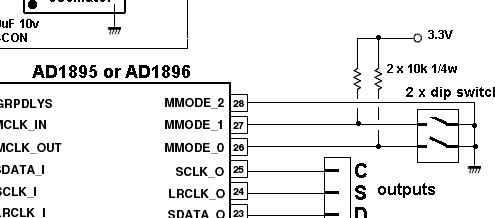

Again I apologise for being so thick! I am really struggling with this. The site says "if you see the dip switch ON then connect to ground: otherwise to 5v". The circuit diagram of the switch is confusing me. There are no resistors because dac has them. So do you connect all the pins to the side of the switch closest to the dac to 5v and solder the pins of the other side of the switch to "ground" so when the switch says "on" the pins go to earth/ground? BUT!!!! Surely then you would just send 5 volts into the ground plane ie making the ground a power rail?
If I look at the ad1896 example its different here. The power rail actually passes through a resistor when the switch is "on" and a power rail can go to ground through a series resistor, just as say Salas suggests to do to test one of his power regs..
So surely what the guy on the site really means is that with the wolfson
pin 23 : switch off then pin connected to nothing
switch on then pin connected to 5v!! indeed : not earth
pin 24 : always to groundie not switched
pin 25/26/27/28: switch off then pins to nothing
switch on then pins to ground
Or am I completely wide of the mark?Like I said sorry for being so thick.
Correct. Some are connected to DVDD, some connected to GND.There are no resistors because dac has them.
NO!!... because:So do you connect all the pins to the side of the switch closest to the dac to 5v and solder the pins of the other side of the switch to "ground" so when the switch says "on" the pins go to earth/ground?
BTW, 'ground' IS a power rail.BUT!!!! Surely then you would just send 5 volts into the ground plane ie making the ground a power rail?
Connect the DIP switch as stated in my first post. Connect the logic input pin to one side of a DIP switch. The other side of the DIP switch is connected to either DVDD or GND (to DVDD if the input has a pull-down resistor, to GND if the input has a pull-up resistor).
SO, this is what happens to a pin that has an internal pull-DOWN resistor:
Dip switch to input pin, other side to DVDD (+5V).
-Dip switch OPEN (off): the internal resistor pulls the voltage level to LOGIC1
-Dip switch CLOSED (on): the DIP switch pulls the voltage level to LOGIC0
*If input put left 'floating' (no DIP switch connected, or DIP switch is OPEN or off) then the pin will be at LOGIC0
SO, this is what happens to a pin that has an internal pull-UP resistor:
Dip switch to input pin, other side to GND (0V).
-Dip switch OPEN (off): the internal resistor pulls the voltage level to LOGIC0
-Dip switch CLOSED (on): the DIP switch pulls the voltage level to LOGIC1
*If input put left 'floating' (no DIP switch connected, or DIP switch is OPEN or off) then the pin will be at LOGIC1
Does that now make sense???
Andy

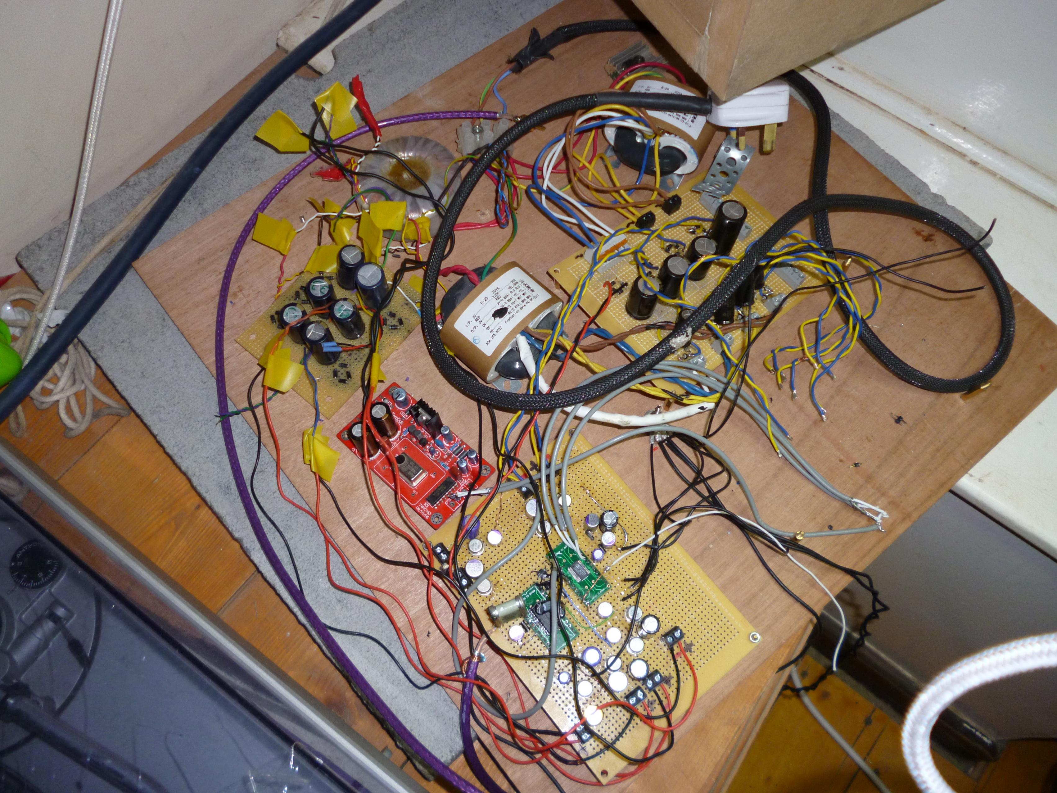

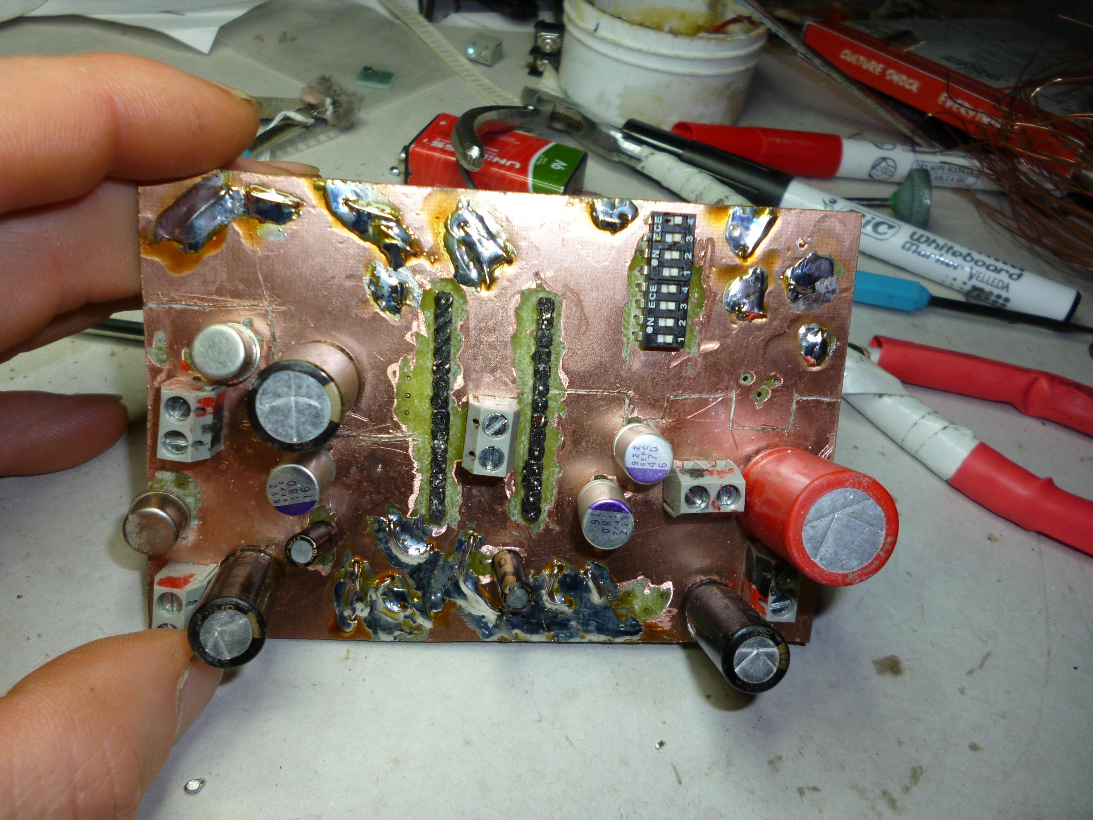

Theres no schematic , I did it copying the Italian guys site. I put the cs8416 and AD 1896 on the same board and wired point to point. This will make dac changing easy, I want to try and rig up a a/b/c/d/ testing dac so I can change by the click of a switch.I believe this is the only way to truely test things.
I had a Cs4397 chip but smoked it . I gave every power pin in that dac its own transformer winding and reg. OVERKILL but the sound was nuts..Never heard anything that comes close but that statement means nothing as I have no access to bona fide HIGH END KIT...All I know is that I was very very happy and amazed by it and the memory of that is my marker.
So I have done the same thing here to all but a few pins. I have lost count of the regs...but its very complicated. So to ease the build I had a go at a pcb and just made it up as I went along on the free version of EAGLE....I messed up putting the wrong side of the image face up , so had to invert the chip so it works on the board but this is good because I can solder bypass caps almost dead on to the pins now! I used an adapter board for the wolfson because I have has trouble with the etchant dissolving the tiny pin traces so gave up.
The 5v regs are LT1021 given steroids with pnp 2n2905 transistors. I suspect this ruins the regs superb noise rejection but I know they are cheap and sound superb.any 3.3volt pins have the lt1021 then a ams3.3 reg thats the best I can do or know how to.
The grounding I never fully understand. My present conception is that we have digital and analogue. They should be separate.They should meet in a castleated shape.The ground is noisy before a reg:quiet after. So I put the quiet analogue and digital ground under the chip and linked it to the copper on the other side of the board by numerous vias. And having just read about the castleated thing just this minute cut a castled trace out so its a bit rough looking.I did not dare try and make a double sided board with eagle incase I messed up. It was my only board . The quiet grounds of all the chips in the dac will go to the star ground of a tubed pre amp.
The tubed pre amp was a tubed output for the cs4397. But I have read the wolfson has a very strong output so need no output stage. So by moving a few caps and a couple of volume pots I the output stage is now a pre amp.
I hope it works . I still have not put the dip on the ad yet. Had enough for today...If you got any tips or critism Andy feel free to say because I am clueless to what I am doing I just have a go..
