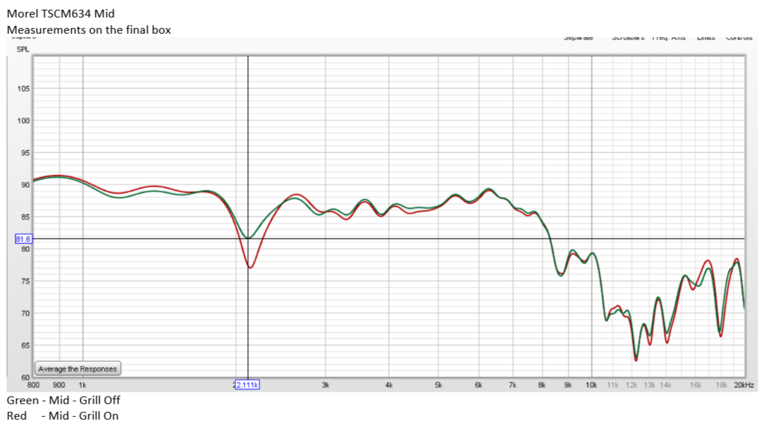

"Mid off axis - straight connection (No xo)" Strange result if direct coupled. Same on both? Compair Distortion tabs between L & R, to see if one have had a coil melt.
Both looks the same L and R.

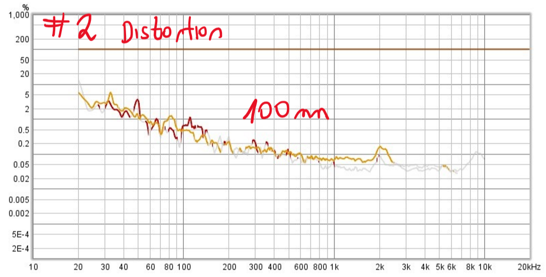

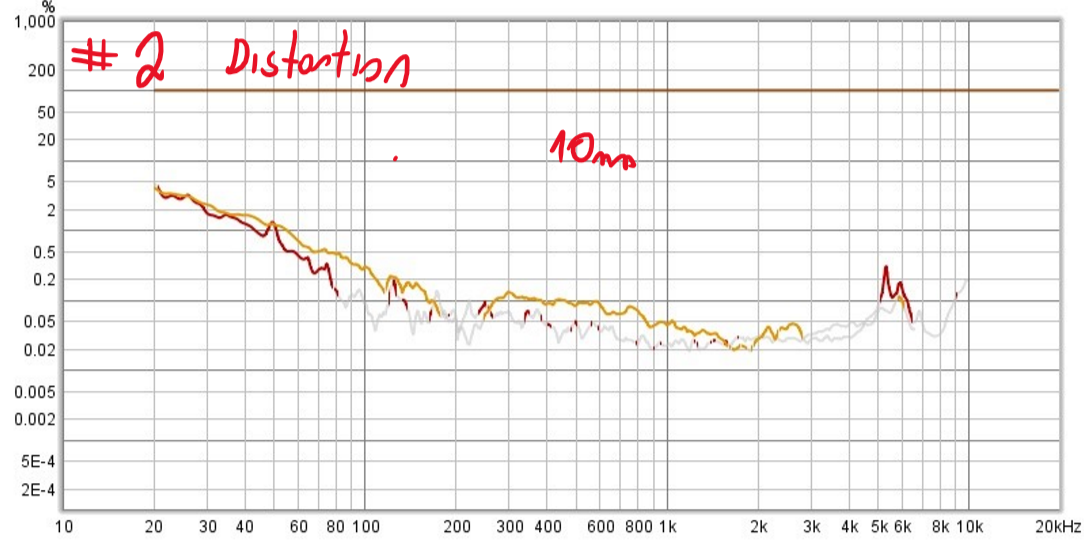

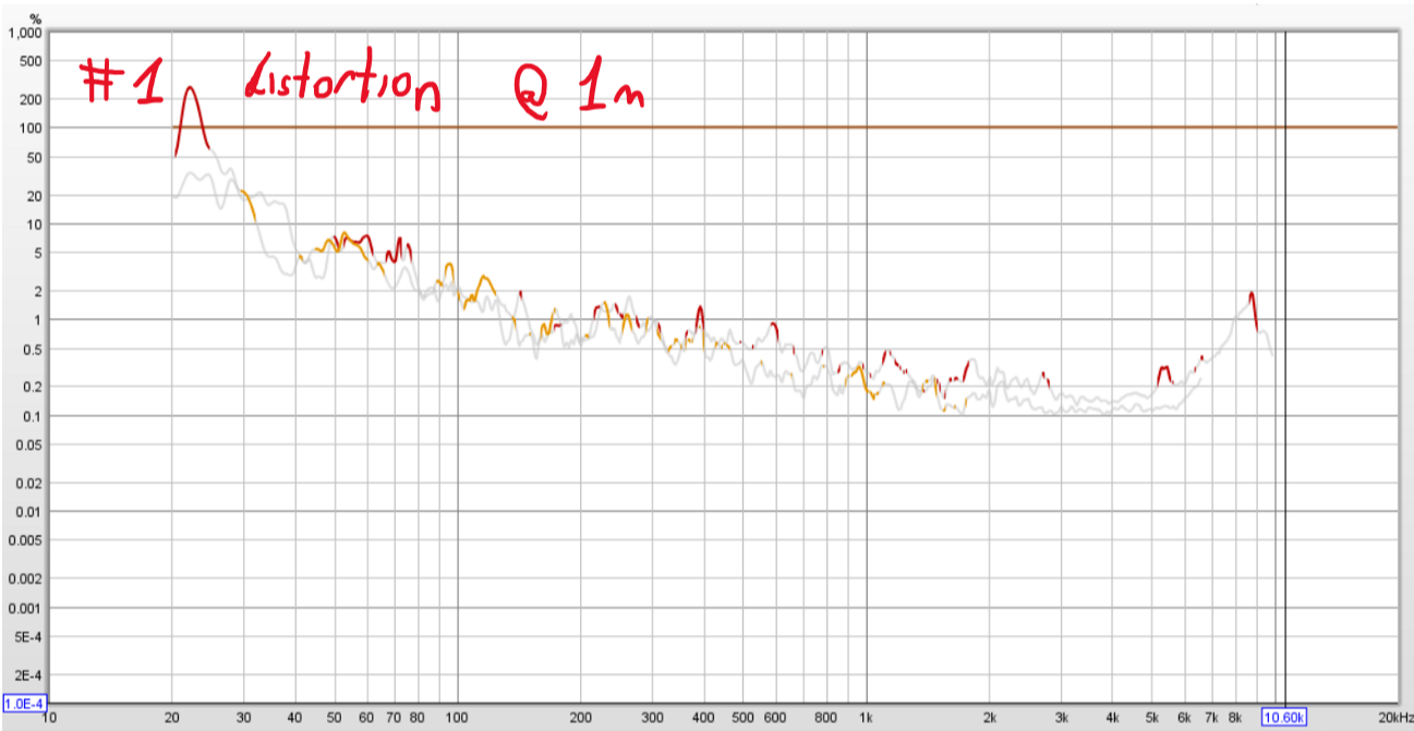

Distortion measurement looks good. I will upload it.
add near field measurements
Added two measurements sessions.

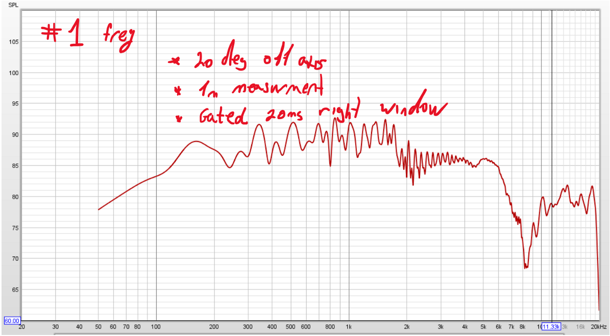

Number 1 are from 1m with gated window of 20ms 20deg off axis.
Number 2 are near field: 10mm and 100mm 0 deg off axis

Maybe this midrange is very picky on angles or else it running the staircase.

Well, the nearfield measurement compared with the measurement on 1m still don’t rule out a weird kind of baffle step function, combined with a too fast decay above 2k of this specific unit.
I’d measure the driver on a big baffle, preferably IEC dimensions, so one should read data sheet values. If that’s the case, design another baffle of your speaker, as virtually every critical distance is in the range of the wavelength associated with 2k. But I suspect the driver not to be fully OK.

As long as the mid alone has this almost step function at 2k, trying to design a crossover is pointless. Just my 2ct.

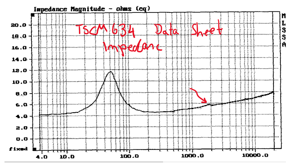

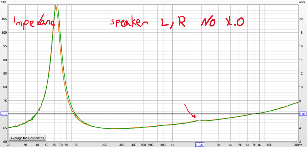

Btw Just noticed the data sheet shows a little bump in the impedance curve. Where? At 2k! Did you measure your impedance curves?
Attached are the impedance measurements:

IEC should be 1m x 1m. I'd try that driver on anything you have handy that isn't the same size of your finished baffle, just to get a handle on what this is. The impedance wrinkle seems too small to have that big of a result in frequency response. Almost seems like the driver has a mechanical issue like non-linear suspension compliance.

It could be cone breakup (the 2k dip). But once that occurs, irregularities in the response rule. This measurement shows a dip, followed by a rather clean response higher up the frequency range. Strange indeed. The fact that the dip persists off-axis would indicate it is not diffraction-induced cancelling.
@ OP, how is the mid enclosure constructed? Which internal dimensions, what damping (acoustic stuffing) is applied? Are you able to produce CSD or BD plots? Were the impedance measurements done in free air or in the enclosure?
I'm as yet uncertain that breakup can be summarily dismissed based on the current information, but willing to be shown otherwise.
If the extant problem is only response irregularities, then can't we equalise it?irregularities in the response rule.
Ran, try put the naked driver on the bench and run a measurement, if the dip still exists then it's most probably related to the driver itself and other variables can be ruled out.
Well, I don't rule it out either. But this graph keeps me puzzled. Why would a grille (cloth on a wooden frame) be maleficial to a cone breakup? Waiting for the CSD/BD-plots!I'm as yet uncertain that breakup can be summarily dismissed based on the current information, but willing to be shown otherwise.

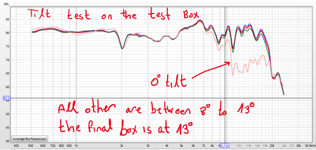

If you giving a tilted box a tilt, you get no tilt! Keep us confused 😀
🙂 the tilt test was done on the test box which add no built in tilt
