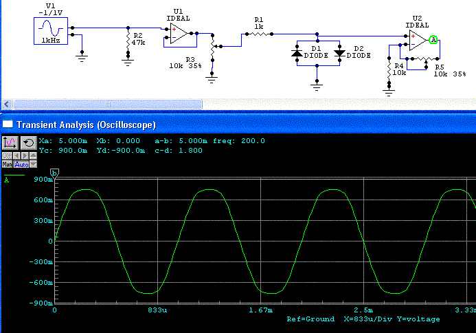

I have a bass guitar amp that has opamps in the input section of the preamp and tubes in the driver and output section.The first stage is non-inverting and has (2) 1N914 diodes in parellel and reversed from each other in polarity between the non-inverting input and the inverting input terminals. What pray tell does this arrangement of diodes provide for this 1974 amp. Can I remove them to improve sound quality because I have never seen them used in a musical amplifier before.😕 😕 😕 😕

Those diodes placed anti-parallel are there to protect the amp against too high input signals, and so to avoid the clipping of the amp. When a (sine wave) signal with too high amplitude is applied the sinewave will be flatten instead of cut off (see pic).

The diodes are there to prevent the common-mode input range of the op-amp being exceeded.
On many op-amps exceeding the common-mode input range causes permanent degradation of performance, that may not even be noticed at first glance.
Andy.

The original poster stated that they were connected between pos and neg input terminal. That in my view makes them limit the differential input voltage.

But inverting and non-inverting input of an opamp will have the same voltage only in case of linear operation. In case of output clipping or saturation the feedback does not work and inputs can have different voltage - diodes will protect it. Maybe they were necessary for old opamp with low value of input difference voltage.

🙂 Thanks for all the input everyone and I get the jist that these diodes were for input protection of an old and obsolete Op-Amp, one of the first good ones of its day,but not needed for a OPA-627 or Analog Devices 843 or 8010. I am assuming because I have not seen any kind of diode protection on the input on current designs. KMcC
Thanks for reminding me to to look at the data sheet, I did and found the answer I was looking for. The B.B. 627-637 data sheet states that if the input voltage will exceed +Vs plus 2V. and -Vs plus2V. that the input diodes should be used for protection, although not configured between inverting and non-inverting inputs. That would mean if the input exceeded +17V. or -17V. I would need clamping diodes. Not going to happen with a bass guitar with even active electronics after the magnetic pickups. They did say the added diodes would increase input bias current by a factor of 1000 if 1N4148 diodes were used.They also echoed the response of someone on this forum that light falling on the diodes increased leakage current. It all goes back to the addage that simpler is better.😀
