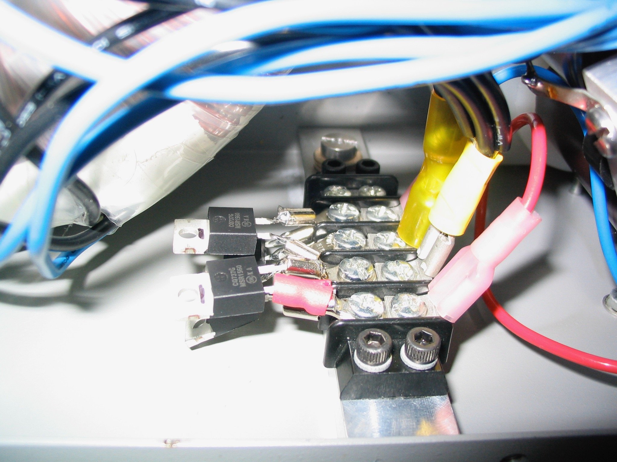

I like big rectifiers too. Last SS amp I made that DIDN’T have a 35 or 50 amp block in it was in a boom box. And then it was a 10A SIP package, mounted to the main heat sink. I bought 100 of the 35A/600V blocks from Digikey recently. In that quantity they are just under two bucks.

thank you very much Then considering the low cost i cant see cons in oversizing I will make some tests on on expendable ampsI like big rectifiers too. Last SS amp I made that DIDN’T have a 35 or 50 amp block in it was in a boom box. And then it was a 10A SIP package, mounted to the main heat sink. I bought 100 of the 35A/600V blocks from Digikey recently. In that quantity they are just under two bucks.

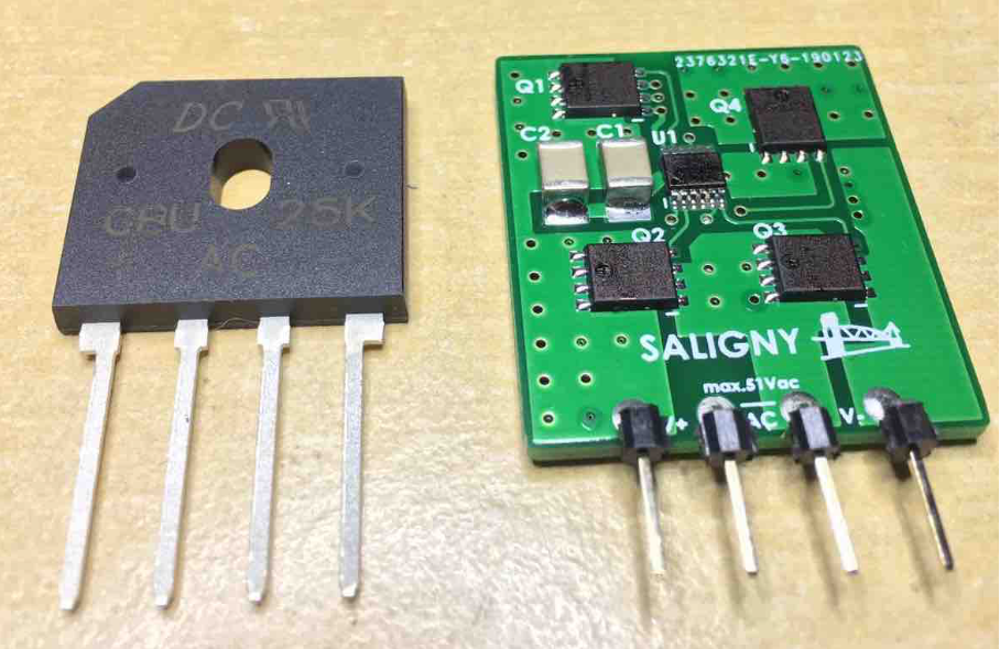

15 years ago I wanted Ultra-Soft Recovery diodes, but today in 2024 we should be coveting active rectifier stuff based on LT4320.

Hey @Andersonix maybe you could post an estimate of the price difference between (4 MOSFETS + 1 LT4320) and (Ultra-Soft Recovery diodes).
Maybe the difference is (in) significant? Maybe not?

Definitely cost is the hurdle for me. Even Prasi board group buy is ~$20 EACH.
