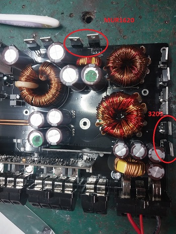

Yes those are MUR1620CTR not MUR1620CTG

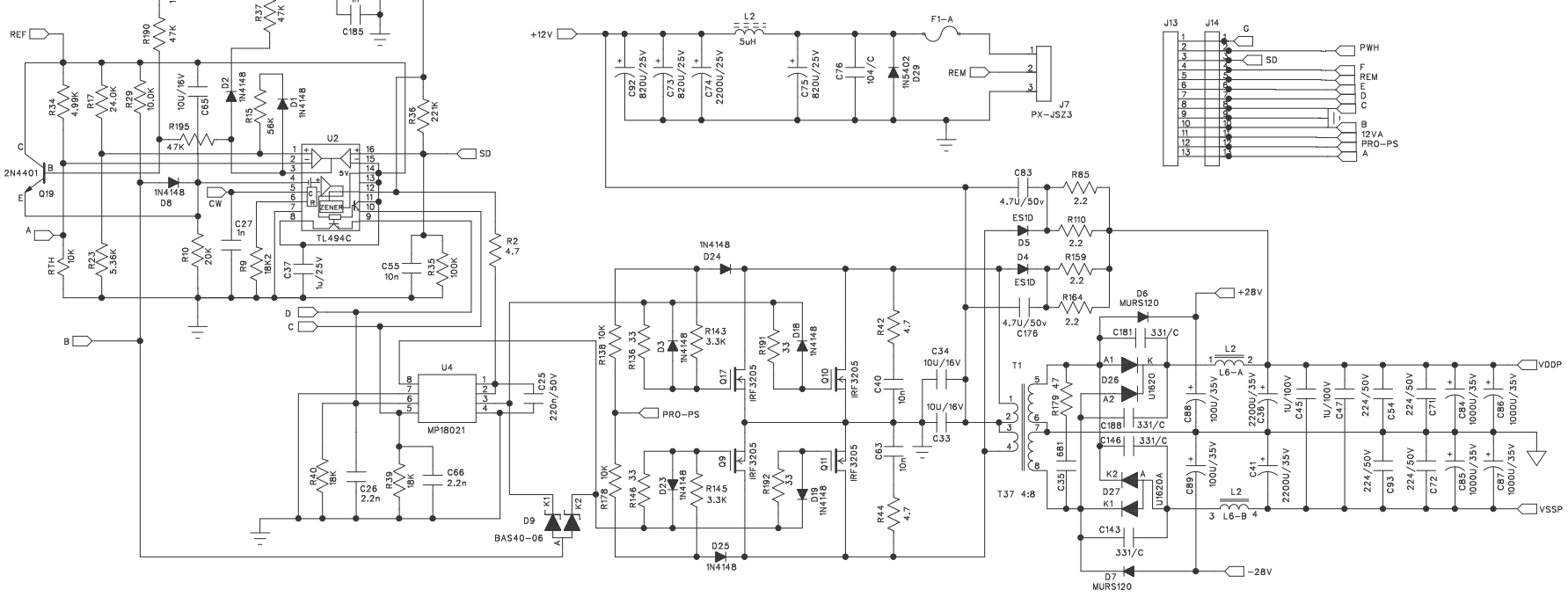

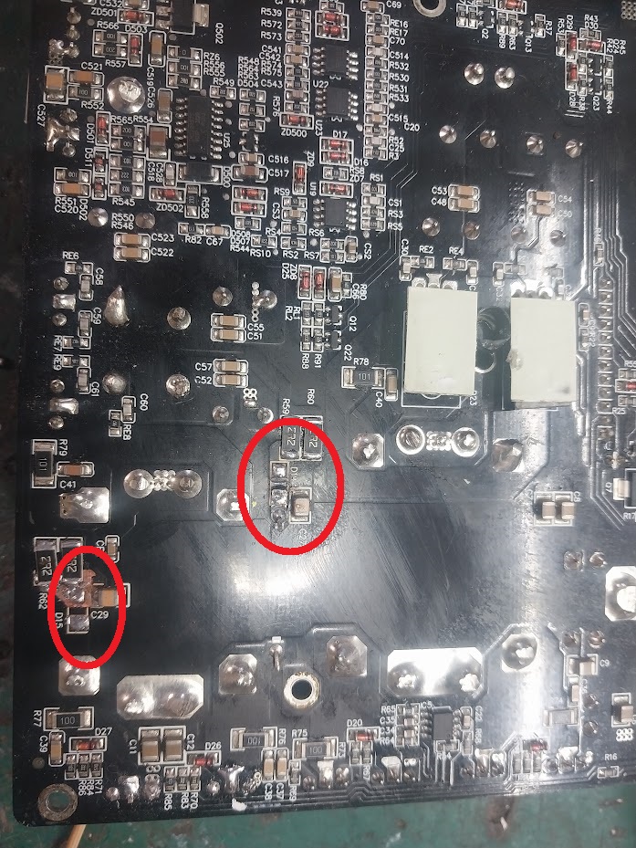

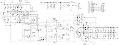

Q: Do you have a PC# on this amp?
A: The only numbers I found was on the back sticker
(2000001175-62) and on the PCB board (R600X5 and P086R00X5)

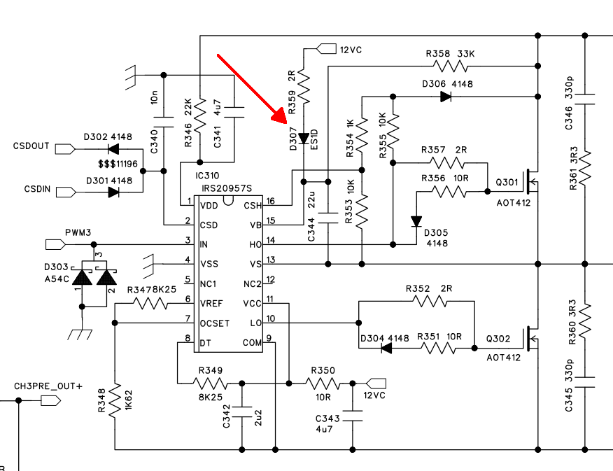

The MP18021HN-LF-datasheet.pdf datasheet is in the semiconductor datasheets folder. Ctrl-f the tutorial files for that and it will come up or go to the folder.
You can see that pins 5 and 6 are INH and INL (inputs, high and low). What is driving those terminals.
Attached is a typical circuit (not Rockford but should be similar).
Q: What's driving the input terminals? Do you see a square wave on the input terminals?
A: I'm not sure how to find whats driving the inputs or how to test the input terminals. I did put my oscilloscope on ground and positive side of the input but I remembered I took out the MUR1620's. Should I put them back in and test again?

Q: First, let's get everything set up to get waveforms on the PS FETs. Set the scope to DC coupling, 5v/div and 10us and probe the gates of the PS FETs. What waveform is there?
A: Let me setup the amp and see if it will stay on long enough to get a good reading and send you a picture.
