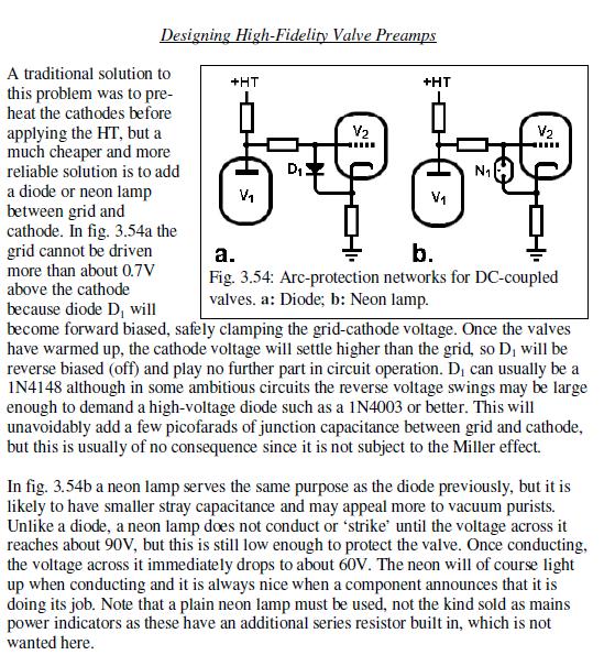

Hi, I have noticed in many schemes the presence of a diode between the grid and the cathode.
I would like to have, if possible, all the information about it, if it is useful and when, if there is a degradation of sound ... etc ..
I also notice that there are those who implement it with a resistor ..
What is resistance needed?
What value should it be put on?
Thanks! I attach some pictures ...
I will throw my guess in the pot on this one. I suspect it prevents excessive positive grid to cathode voltage when the tubes are still cold but B+ is present. Seems like a good practice for a direct coupled stage.
On the spot correct !
When the circuit is working the diode is blocking and has no affect on the sound, it only comes to play when conditions are dangerous for the tube.
It's needed for any direct-coupled cathode follower to prevent grid-cathode arcing at startup. It does not affect the sound at all.

You are correct that it can protect grid-cathode arcing at startup. But there are few million Marshall amps out there without one. Certainly not a high failure rate.
Having said that, one tube that did have a high failure rate in that position was the Sovtek 12AX7LPS. I am thinking the diode would have certainly helped.
The diode has another purpose than just for direct coupled circuits . . .
For RC coupled stages, where the designer of the circuit insists on sub-Hertz frequency response, there will often be a 0.47uF, 1uF, or larger coupling cap from the previous stage's plate, to the grid of the next stage.
A capacitor that has 0 Volts across it, is a dead short when the amp B+ first comes on.
If the tubes are still cold, the previous stages plate load resistor passes exactly the same transient current to the next stage grid . . . Just as if it was a direct coupled stage.

The resistor is only found in guitar amps, to ensure the diode does not make the clipping too 'solid state' when driven positive. You don't need it for hi-fi (it isn't really needed for guitar either, to be honest).
'Light bulb' needs to be a neon lamp:
https://uk.farnell.com/multicomp/mc08310015/neon-lamp-wire-ended-t2/dp/1139256?st=neon lamp
Many Neons, like the NE2, fire at about 90V, and then stabilize at about 60V.
If you think 60V from grid to cathode is OK . . . well then OK.
If not, then Not!
At least, probably not on Audio Tubes.
If the first stage of the DC coupled stage triode goes open, then 60V will always be at the grid with respect to the cathode (not so nice).

It does not matter, any general purpose neon bulbs will work, they are all basically the same. But why not use a diode?

60V is fine for standard audio tubes, they don't seem to care until you exceed 100V.
