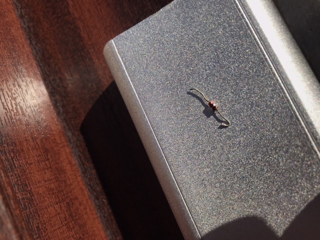

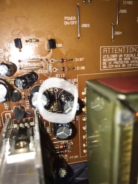

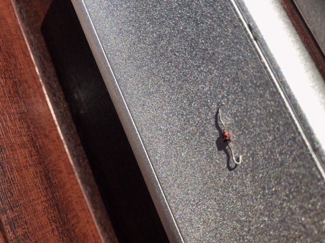

Can anyone identify this diode and it’s values for me please, I cannot find a schematic so this is my last resort I believe.

Sorry, it’s from what most will consider a waste of effort piece of equipment but I’m determined to bring it back to full working condition.
Denon UCD-F88 , CD player separate from a midi system, I believe ( or hope ) that the diode is responsible for the dim display.
It's called ZDsomething, so it is probably a Zener diode. Judging by its size it must be a 400 mW or 500 mW Zener. The photograph is too vague to see what the Zener voltage is.

You first need to know what the correct Zener voltage is. If it is used as the reference for some sort of voltage regulator, a too high voltage could easily lead to damage beyond repair. Can you read any part of what is printed on the diode?
