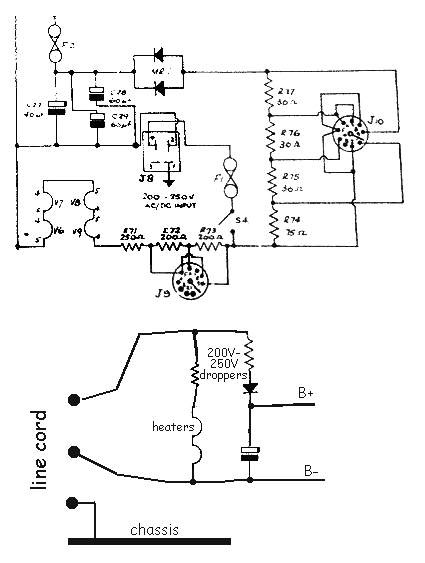

Yes, B&H was dominant in the US. However this amplifier looks like UK design. Perhaps B&H hired designers familiar with UK production practices and economics of parts. Perhaps it is actually another make sold under the B&H brand-badge.
That schematic is drawn as a maze. Here is the core of the power business.
Ouch!!!
yes, that´s a *deadly* amplifier, doubly so in 240V fed UK lines, but they were never safe under 115V US mains.
You NEED an isolation transformer, or even better, just cannibalize tubes, sockets and Output Transformers and build any suitable project, WITH a proper Power Transformer of course.

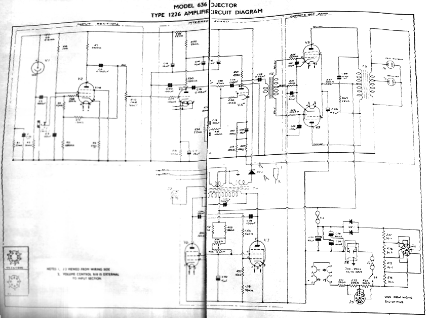

> Here’s a copy of the whole schematic....
Dang PhotoBucket!! Images don't load; or they do but it pops-up girly-pictures. (Not even good ones.)
This forum has an image attachment feature. Here's your plan, rotated and cleaned.
PRR
Joined 2003
This one is truly odd. It does have a Mike jack. And it appears to be 1/4" (guitar plug). How can that be safe?
Wander around. The push-pull pentodes at bottom are a power oscillator. This was often done on optical-sound projectors; at the time it could be cheaper than making really-clean low-Voltage DC for the sound head lamp. But it has another tap, rectified, feeding the B+ for the preamp tubes! And if I trace-out the returns, this small B+ supply does not return to the wall-plug. The audio power tubes' B+ supply is line-hot, but the power stage is *transformer-coupled* input and output.
So just as it stands (not considering any failures of 57 year old parts) this is "Apparently Safe" from Mike/Guitar Jack to speaker.
But if someone left rattlesnakes on my doorstep, in a 57 year old basket, I'd be very wary.
Well I changed the diode and replaced the wire which was acting as F2 with a proper 500mA fuse as specified in the service manual and I’m still not getting any heater or HV for the preamp sections. Since the initial idea is to make it into a guitar amp... than I would definitely prefer doing something with a similar preamp stage but change the whole power supply and output sections to suit an EL84 pushpull circuit. Thanks for all the help
