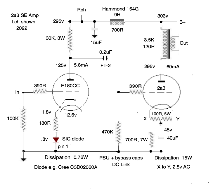

Reviving this thread to see if anyone else has been trying SIC diodes in series with a resistor. I'm finding the sound is smoother with a resistor to add some feedback. Plus I'm only using a single SIC diode, not a string. No cathode bypass.
You ask about series one resistor + diode, but would be interesting with two diodes in series and parallel one resistor, diodes lock the voltage and resistor help to flow the feedback, I think that diode in series cut the feedback loop with the grid. But I never do
