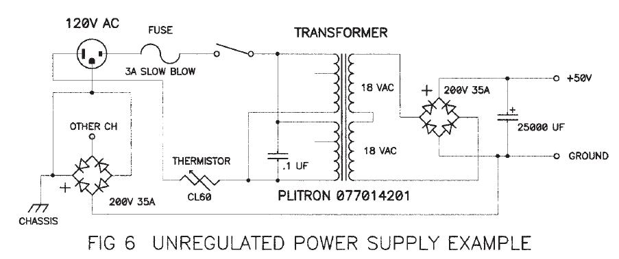

Mr. Pass wrote in the ZV4 docs:
As it is in the attached image.Note in Figure 6 that we have chosen to isolate
the two channels through a rectifier bridge to ground, with each
channel’s ground appearing on one of the AC legs of the bridge.

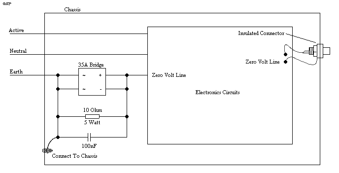

Mr. Rod Elliot wrote:
as it is in the next attached image.Note the way the bridge is wired, with the two AC terminals shorted, and the two DC terminals shorted. Other connection possibilities are dangerous, and must be avoided.

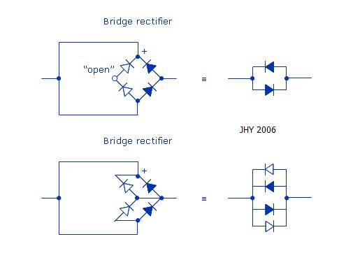

I hope the attached sketches show the understanding.
The horizontal flip is always direction-free symmetry.
Either end of (+/-) or (~/~) could go the gnd.
For a ground loop breaker, besides the diodes you should put a 5 to 20 ohm resistor in parallel, as well as a small cap as HF bypass (0.1-1 uf). Make sure the diodes are rated at sufficient current so that in a fault situation the fuse on the hot mains line blows!
Nixie said:For a ground loop breaker, besides the diodes you should put a 5 to 20 ohm resistor in parallel, as well as a small cap as HF bypass (0.1-1 uf).
Why?
In most ground loop breakers I've seen, the diodes are there as protection in case of fault where the resistor would just burn out. It's the resistor that's doing the ground lifting--you just need sufficiently different resistances on each of the legs of the ground loop. If you just have diodes, the circuit ground is floating within the one diode drop from earth, with no connection to earth; with a low value resistor, I find it still breaks ground loops, but the circuit tends to stay closer to eart. The bypass capacitor allows earth to sink HF interference. With the scope I see less RF on the circuit ground when the cap is added.

both ESP and Pass circuit are correct. But they are different and for different purposes.
The Pass circuit is a for a 2channel amplifier and isolates the two channels from each other thus breaking the ground loop and avoiding hum. The disadvantage is the 35A rating of the safety connection from audio ground to safety earth.
The ESP circuit is for a single channel amplifier and has the advantage of 35*2 =70A rating of the safety connection from audio ground to safety earth.
The additional capacitor and resistor can be added to either the ESP or Pass version of the circuit. They are effectively optional and may work better for some amplifiers/user's ancilliaries/house earthing than others. I tend to use the dual Power diode //cap//Power resistor for EACH channel. i.e. the ESP version. The Pass version is basically a money saving exercise.

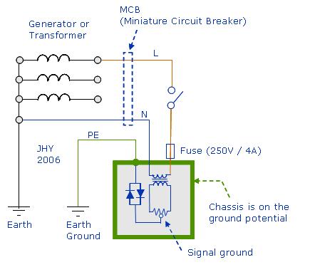

The paralleled diodes in the opposite direction each other are to break current between the signal star ground and the protective earth (connected to the chassis) – to break possible ground loop. Then, the signal star ground would not see the small signal noises coming through the ground loop. But, this works only when the potential difference between the signal star ground and the protective earth is less than about 650mV. When the potential is greater than this value, the diodes are shorted for current flow with no resistance, and the current will blow off the fuse installed at the entrance of the live (active) line or switch off the house wall breaker – for safety.

I hope you are able to look into the attached concept.
