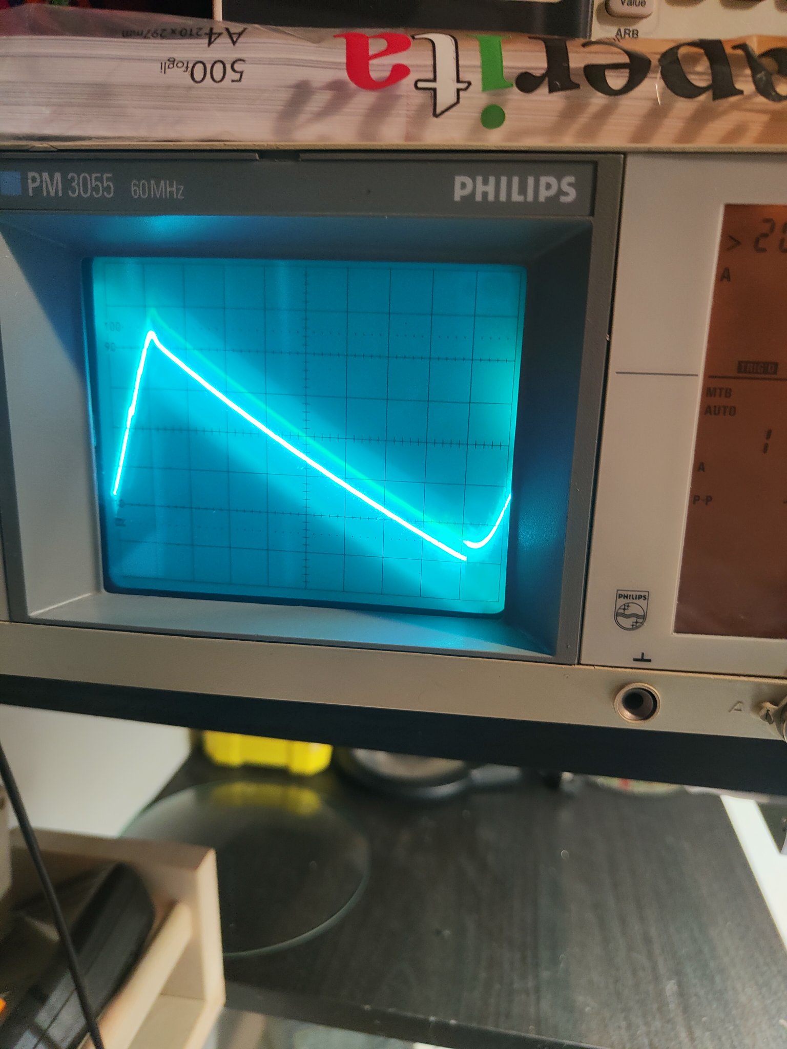

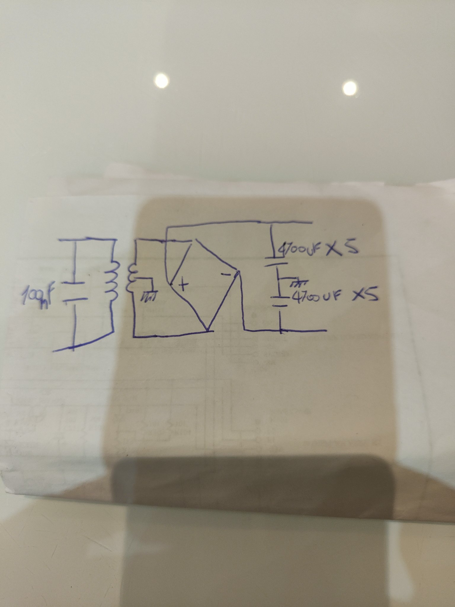

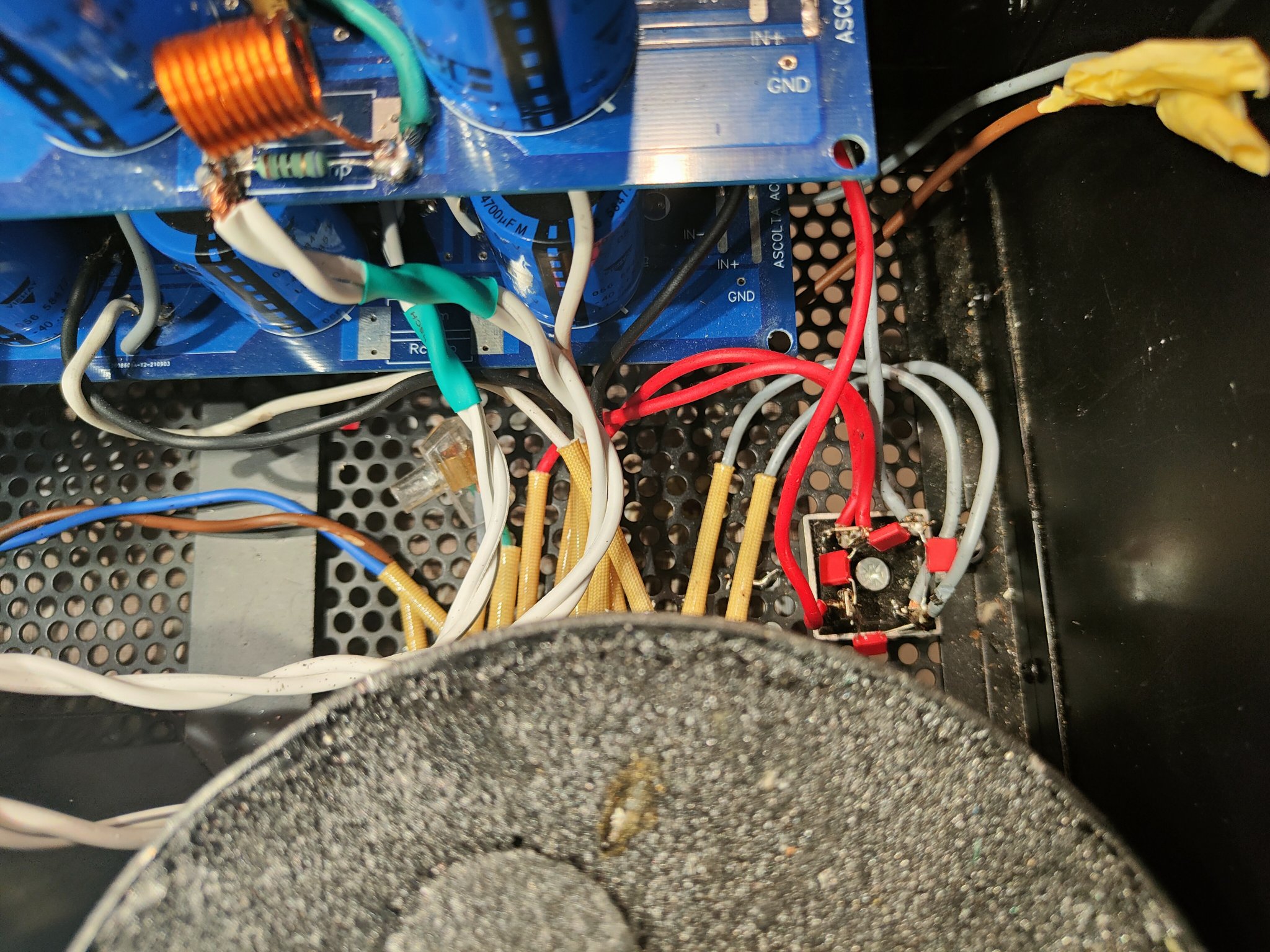

i'm building a power amp that i designed. I noticed that the triangular waveform shape of the ripple has an overshoot, a peg on the corner of the triangle. Using a fast recovery diode bridge could I improve? I need a 30 A diode bridge, can you recommend something?
these are the pics... short wiring, this feeds 8x lm3886 with local bypass from 10nf xr7. at the moment of the measurement the amplifier was not driving any load
