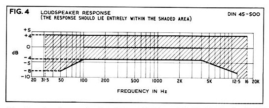

I already know that it's a very strange thing but I've a question/curiosity about a "DIN 45500 HI-FI standard": do you know what should be the minum value of the low frequencies to consider a driver really "HI-FI"?...When I say "driver", I mean a simple woofer (or a mid-woofer...at least!).

re:"what should be the minum value of the low frequencies to consider a driver really "HI-FI" - that's a matter of opinion, and also depends on what you want to achieve, Organ Lovers would say they need 16Hz, Rock listeners would be happy with ~ 40Hz, for me somewhere in the low-mid 30s is OK, many small monitors struggle to reach 50Hz.....
My hazy memory for DIN 45500 standard says 100 Hz at -4 dB and 50 Hz at -8 dB and overall response between 100 Hz and 4 kHz at +/- 4 dB.
The OP question specifically was about the DIN 45500 standard.re:"what should be the minum value of the low frequencies to consider a driver really "HI-FI" - that's a matter of opinion, and also depends on what you want to achieve,
Yes, that's true. But here's the catch: While there are minimum specs of different HiFi equipment (turntable, amplifier, tuner, microphones), the DIN45500 does not specificly say which frequency range the speakers have to reach at all. There's a diagram which suggests it should start with 50Hz, but that is a misconception.
(DIN45500 for speakers)
There are a lot of small HiFi-speakers from the 70s which were HiFi certified by the DIN45500 and only reached 70-80 or even only 100Hz. How comes that? Only the 'core' part of the linearity (100Hz - 12,5kHz) has to be fulfilled and they have to state the frequency range - and that is, where the speaker leaves the diagram at the lowest point of the limit range.
