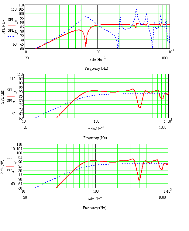

OK, I've just taken a quick look for the sake of interest.
The Pensil is certainly a resonant QW line, & not an especially distinguished one at that; looks like only the most rudimentary QW math has gone into it, and it may be regarded in the same vein as the rather similar Zigmahornet. I have dark suspicions about harmonic nulls. F3 will probably be acceptably suppressed by the driver location, but higher modes will likely be more problematic.
FWIW, length / Fp has clearly been set to Fs; for the rest, it looks like raw guesswork, although, Vp appears is roughly in the region of a 4th order (reflex) vented alignment; whether that is accident or design, I wouldn't like to say.
Edit: I've just stuffed it through MathCAD for the sake of providing a few illustrative graphs.
Top plot: driver & vent output of the unstuffed pipe; you can clearly see the confirmation that the first mode is set to the 70Hz pipe tuning. Middle plot: FR of the cabinet when damped ~equivalent to plans. As suspected, note the harmonic null. Lower plot: FR of the cabinet with the same damping, but with the slight mass loading removed. It doesn't make a whole lot of difference, other than fractionally reducing the depth of the null at F5. Still, mass loading as suggested is purely a matter of degree. If there is a restriction, however slight, it's still technically mass loaded. Can't beat the laws of physics.
