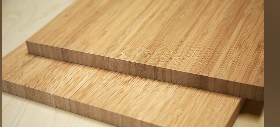

So, I found what Im building my speakers from, and very much looking forward to seeing the big brown truck deliver 😀
In the bit of work I have done in my life, I know wood expands and contracts during changes in temperature and humidity. Building anything with very dissimilar properties can cause surprises down the road....
That said, I could only find one source stating the dimensional stability of bamboo wood is better than most hardwoods. Obviously, the source was a bamboo manufacturer, so naturally what they sell has to be better lol..
But, they could be stating something everyone already knows, except me lol....
Im trying to decide what to build the bracing out of. Trying to figure out what to add as interior dampening panels.
If in fact the boo is better than most hardwoods, I would imagine Huber Advantec plywood would be the most parallel, and certainly the most moisture resistant material I have ever seen...
Wondering if anyone here has any history with it...

These bamboo plywood are of course not natural bamboo.
They can never come in such big pieces.
The bamboo is first strip into loose fibres.
These are then soaked with resin and pressed together to forum those bamboo ply.
The fibre is much tougher than wood fibre, and the strength comes from the resin.
But it is likely to have less damping than natural wood ply.

I don’t know about these solid bamboo boards, i do know that Kurt @ qualifi in Denmark suses similar. As EVUL points out this is a laminate of vertical bamboo slices.
I would consider using this if i did not feel that proper bamboo plywood is available, and the stranded variety is by far the best. Next is teh vertical (which has outer plies put together the same way as these bamboo boars.

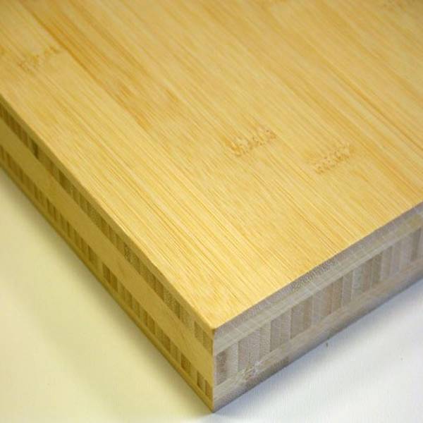

I'd be wary of using panels made using a single side lamination process as shown in OP. This is not strand/resin impregnation but strip lamination, see here. I'd be more comfortable with a traditional 3 or 5 ply construction as shown.
Also, why would you want to use a different material for the bracing?

I have seen a richness in choice of bamboo plywood in Oz than i have not seen here. All 3 ply, 18 or 12mm thick. You could make an incredible plywood using 5 or 7 of the outer stranded veneer and either a 10-ton press or a vacuum bag.
