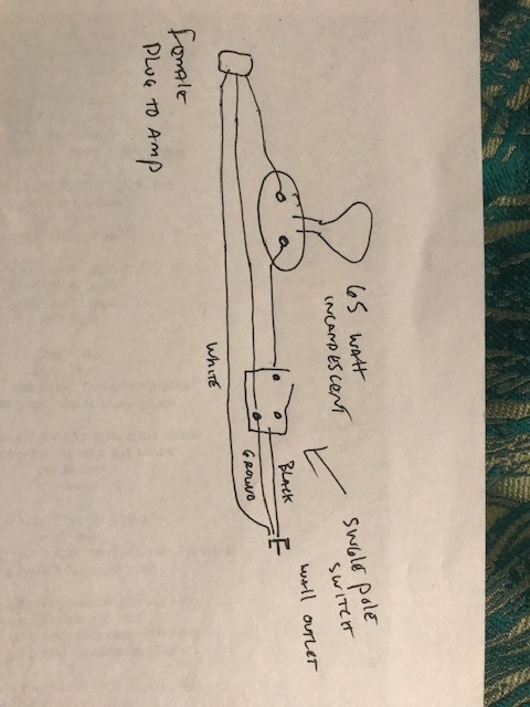

....- looks like the ground doesn't really need to run thru the switch...
The switch frame "MUST" be grounded.
(So that when a stray wire touches cover or frame, it will blow the cellar fuse before the user dies.)
Even with a plastic switch-cover, because the cover-screws are metal.
- dim bulb tester, "schematic"
