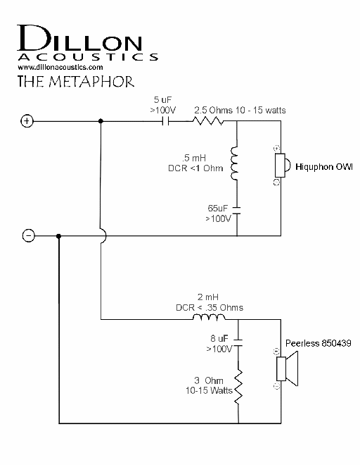

After searching many plans, I will build the Metaphor from Dillon Acoustics. Before I start I wanted to ask if anyone has heard these, and what they think. I do not design crossovers, so I hope his is as good as he says.
The only thing I plan to change is mine will have a closed box, no port. I will be using a sub-woofer. Has anyone built or heard these?

Thanks for the 2 replies guys. I am starting to buy my parts. I may not be able to find a 65 uF cap for the crossover. Would a 64 uF be ok, or does it need to be exact? This 65 uF cap is in parallel with the tweeter. Also, I may need to combine two caps to make 65uF. To do this, do I connect the caps in parallel to add their values?
Capacitors in parallel add together.
64uf will be absolutely fine instead of 65uF.
A 64uF capacitor with 5% tolerance is much better than 65uF with 10%.
If they are both 10% then describing one as 64 and the other as 65 is pointless.
You could always bypass the the 64uF with a very high quality
1uF capacitor, the result will be better than any 65uF capacitor
you could sensibly afford.
🙂 sreten.

You are so right about the tolerances. I overlooked them. I have ordered some Dayton caps that are 10%, and some Solen that are 5%. I may try to use more Solen. I tought about the bypass cap also. I may try that.

Metaphor and HT
I have sealed LCR Metaphors in my HT/music system. They mate up with a sealed 3 cu ft shiva and MurphyBlaster SPCA's in the rear. Geoff did a wonderful job with the Metaphor. The Metaphor sound is a bit more laid back that the more detailed Ego (also a first rate speaker). However, for HT, the Ego's stain at higher HT volumes.
The OWI is fine with Geoff implementation of the 4th to 6th order acoustic 2100 Hz crossover point. I know others prefer the to cross it higher, but the Metaphor's and the Ego's just work well. I think the Peerless HDS benefits from the lower crossover.
