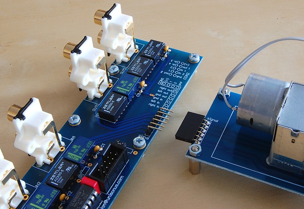

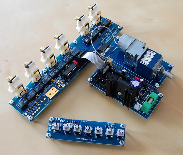

I designed such PCB (selector), which, after minor changes in the program (a standard driver supports one output) works with this volume regulator. This is how it looks:
