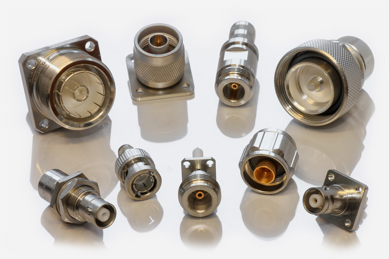

Sir, have You ever heard that RF connectors have simetimes absolutely enormous sizes?
Even for powers like 20W?
The higher the frequency (slew rate, gradient) the bigger the connectors (that was usually, but recently they use very tricky materials to reduce sizes).
Give us some OTHER reason, please. With scientific foundations, please.I know! That is why some high power amplifiers have enormous speaker connectors on the back. That is to increase slew rate!

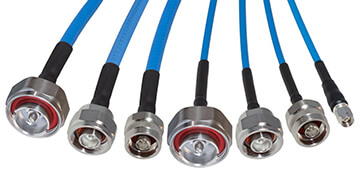

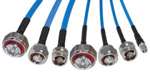

Nope. It has very pre-defined price.
Yet a humble SMA connector can handle 150W at 12 GHz. The filters we used in cellular base stations.had SMA in and N or 7/16 out. 7/16 are very good for terminating 2" heliax but often more pain than they are worth as very sensitive to torque. Torque them wrong and IMD goes through the roof.
No. Thick wires have the same skin effect as somewhat thinner wires. Really thin wires have less skin effect, which is the opposite of what you say.Alex Ra said:thick wires (lower skin-effect)
So the wires in transistor amps are too thin to handle the music signal? You are very good at engineering comedy; have you ever thought of going on stage?low AC current in tube circuits (comparing to transistor) thus again - low skin-effect distortions, thick capacitors and resistors leads.
At first I thought you merely had some idiosyncratic views and a little confusion; now I realise that the basics of electronics escape you.Sir, have You ever heard that RF connectors have simetimes absolutely enormous sizes?
