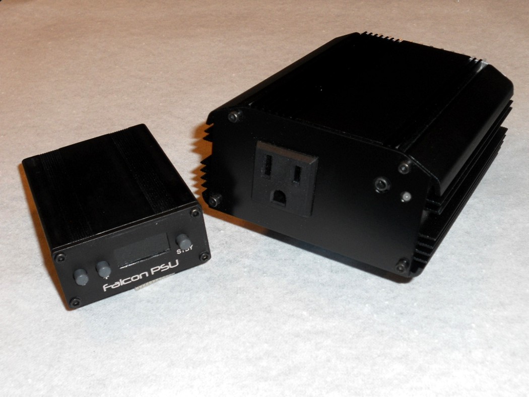

Is the Eagle PSU box the same size as the Falcon?
1) I hope it still fits under my VPI Scout.
2) can I move the IEC tail to the new box?
The control unit for the Eagle is the same size (same extrusion actually) as the Falcon. The picture shows a Falcon front panel; the front panels for the Eagle are due here next week. It will fit under your Scout, look the same (except for the name), work the same and operate the same way as the Falcon.
The output is on the front panel of the amp unit and is a NEMA 5-15 (3 prong North American) socket. The cable that connects the control unit and amp together is 6ft long, so you can locate the amp remotely and plug the motor's original power cord into the Eagle output. The cable is a 3.5mm stereo Male-Male, and you can substitute other lengths if necessary.
